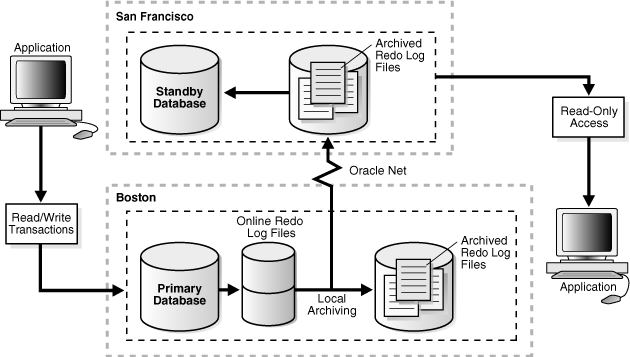

Figure 8-1 shows a two-site Data Guard configuration before the roles of the databases are switched. The primary database is in San Francisco, and the standby database is in Boston.
Figure 8-1 Data Guard Configuration Before Switchover

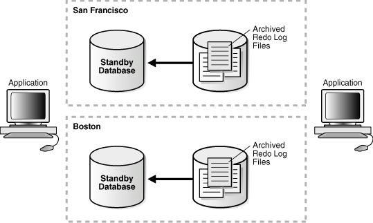

Figure 8-2 shows the Data Guard environment after the original primary database was switched over to a standby database, but before the original standby database has become the new primary database. At this stage, the Data Guard configuration temporarily has two standby databases.
Figure 8-2 Standby Databases Before Switchover to the New Primary Database

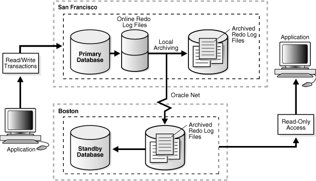

Figure 8-3 shows the Data Guard environment after a switchover took place. The original standby database became the new primary database. The primary database is now in Boston, and the standby database is now in San Francisco.
Figure 8-3 Data Guard Environment After Switchover

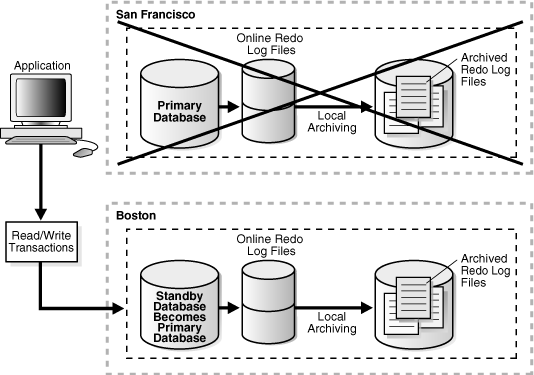

Figure 8-4 shows the result of a failover from a primary database in San Francisco to a physical standby database in Boston.
Figure 8-4 Failover to a Standby Database

This section describes how to perform failovers involving a logical standby database. A failover role transition involving a logical standby database necessitates taking corrective actions on the failed primary database and on all bystander logical standby databases. If Flashback Database was not enabled on the failed primary database, you must re-create the database from backups taken from the current primary database. Otherwise, you can follow the procedure described in Section 13.2 to convert a failed primary database to be a logical standby database for the new primary database.
Depending on the protection mode for the configuration and the attributes you chose for redo transport services, it might be possible to automatically recover all or some of the primary database modifications.
Step 1 Copy and register any missing archived redo log files to the target logical standby database slated to become the new primary database.
Depending on the condition of the components in the configuration, you might have access to the archived redo log files on the primary database. If so, do the following:
Determine if any archived redo log files are missing on the logical standby database.
Copy missing log files from the primary database to the logical standby database.
Register the copied log files.
You can register an archived redo log files with the logical standby database by issuing the following statement. For example:
SQL> ALTER DATABASE REGISTER LOGICAL LOGFILE 2> '/disk1/oracle/dbs/log-%r_%s_%t.arc'; Database altered.
Step 2 Enable remote destinations.
If you have not previously configured role-based destinations, identify the initialization parameters that correspond to the remote logical standby destinations for the new primary database, and manually enable archiving of redo data for each of these destinations.
For example, to enable archiving for the remote destination defined by the LOG_ARCHIVE_DEST_2 parameter, issue the following statement:
SQL> ALTER SYSTEM SET LOG_ARCHIVE_DEST_STATE_2=ENABLE SCOPE=BOTH;
To ensure this change will persist if the new primary database is later restarted, update the appropriate text initialization parameter file or server parameter file. In general, when the database operates in the primary role, you must enable archiving to remote destinations, and when the database operates in the standby role, you must disable archiving to remote destinations.
Step 3 Activate the new primary database.
Issue the following statement on the target logical standby database (that you are transitioning to the new primary role):
SQL> ALTER DATABASE ACTIVATE LOGICAL STANDBY DATABASE FINISH APPLY;
This statement stops the RFS process, applies remaining redo data in the standby redo log file before the logical standby database becomes a primary database, stops SQL Apply, and activates the database in the primary database role.
If the FINISH APPLY clause is not specified, then unapplied redo from the current standby redo log file will not be applied before the standby database becomes the primary database.
