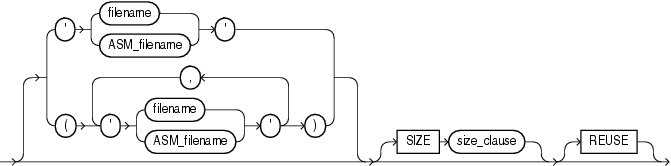

datafile_tempfile_spec
Use this clause to specify the attributes of datafiles and tempfiles if your database storage is in a file system or on raw devices or in Automatic Storage Management disk groups.
redo_log_file_spec
Use this clause to specify the attributes of redo log files if your database storage is in a file system or on raw devices or in Automatic Storage Management disk groups.

SIZE Clause
Specify the size of the file in bytes. Use K, M, G, or T to specify the size in kilobytes, megabytes, gigabytes, or terabytes.
  • For undo tablespaces, you must specify the SIZE clause for each datafile. For other tablespaces, you can omit this parameter if the file already exists, or if you are creating an Oracle-managed file.
  • If you omit this clause when creating an Oracle-managed file, then Oracle creates a 100M file.
  • The size of a tablespace must be one block greater than the sum of the sizes of the objects contained in it.
    See Also:
    Oracle Database Administrator's Guide for information on automatic undo management and undo tablespaces and "Adding a Log File: Example"
REUSE
Specify REUSE to allow Oracle to reuse an existing file.
  • If the file already exists, then Oracle reuses the filename and applies the new size (if you specify SIZE) or retains the original size.
  • If the file does not exist, then Oracle ignores this clause and creates the file.
Restriction on the REUSE Clause You cannot specify REUSE unless you have specified filename.
Whenever Oracle uses an existing file, the previous contents of the file are lost.
