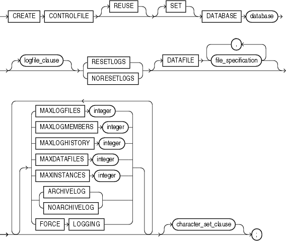

To create a control file, you must have the SYSDBA
system privilege.
The database must not be mounted by any instance. After successfully creating the control file, Oracle mounts the database in the mode specified by the CLUSTER_DATABASE
parameter. The DBA must then perform media recovery before opening the database. If you are using the database with Oracle Real Application Clusters (RAC), then you must then shut down and remount the database in SHARED
mode (by setting the value of the CLUSTER_DATABASE
initialization parameter to TRUE
) before other instances can start up.
When you issue a CREATE
CONTROLFILE
statement, Oracle Database creates a new control file based on the information you specify in the statement. The control file resides in the location specified in the CONTROL_FILES
initialization parameter. If that parameter does not have a value, then the database creates an Oracle-managed control file in the default control file destination, which is one of the following (in order of precedence):

Specify REUSE
to indicate that existing control files identified by the initialization parameter CONTROL_FILES
can be reused, overwriting any information they may currently contain. If you omit this clause and any of these control files already exists, then Oracle Database returns an error.
Specify the name of the database. The value of this parameter must be the existing database name established by the previous CREATE

Use the logfile_clause
to specify the redo log files for your database. You must list all members of all redo log file groups.

file_specification for a full description of this clauseRESETLOGS Specify RESETLOGS
if you want Oracle Database to ignore the contents of the files listed in the LOGFILE
clause. These files do not have to exist. You must specify this clause if you have specified the SET
DATABASE
clause.
Each redo_log_file_spec
in the LOGFILE
clause must specify the SIZE
parameter. The database assigns all online redo log file groups to thread 1 and enables this thread for public use by any instance. After using this clause, you must open the database using the RESETLOGS

NORESETLOGS Specify NORESETLOGS
if you want Oracle Database to use all files in the LOGFILE
clause as they were when the database was last open. These files must exist and must be the current online redo log files rather than restored backups. The database reassigns the redo log file groups to the threads to which they were previously assigned and reenables the threads as they were previously enabled.

Specify the datafiles of the database. You must list all datafiles. These files must all exist, although they may be restored backups that require media recovery.
Do not include in the DATAFILE
clause any datafiles in read-only tablespaces. You can add these types of files to the database later. Also, do not include in this clause any temporary datafiles (tempfiles).

Specify the maximum number of online redo log file groups that can ever be created for the database. Oracle Database uses this value to determine how much space to allocate in the control file for the names of redo log files. The default and maximum values depend on your operating system. The value that you specify should not be less than the greatest GROUP
value for any redo log file group.
Specify the maximum number of members, or identical copies, for a redo log file group. Oracle Database uses this value to determine how much space to allocate in the control file for the names of redo log files. The minimum value is 1. The maximum and default values depend on your operating system.

Specify the initial sizing of the datafiles section of the control file at CREATE
DATABASE
or CREATE
CONTROLFILE
time. An attempt to add a file whose number is greater than MAXDATAFILES

Specify ARCHIVELOG
to archive the contents of redo log files before reusing them. This clause prepares for the possibility of media recovery as well as instance or system failure recovery.
If you omit both the ARCHIVELOG
clause and NOARCHIVELOG
clause, then Oracle Database chooses NOARCHIVELOG
mode by default. After creating the control file, you can change between ARCHIVELOG

Use this clause to put the database into FORCE
LOGGING
mode after control file creation. When the database is in this mode, Oracle Database logs all changes in the database except changes to temporary tablespaces and temporary segments. This setting takes precedence over and is independent of any NOLOGGING

If you are re-creating your control file and you are using Recovery Manager for tablespace recovery, and if you specify a different character set from the one stored in the data dictionary, then tablespace recovery will not succeed. However, at database open, the control file character set will be updated with the correct character set from the data dictionary.
You cannot modify the character set of the database with this clause.
