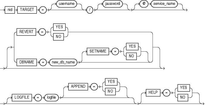

The following diagrams show the syntax for the DBNEWID utility.
Table 17-1 describes the parameters in the DBNEWID syntax.
Table 17-1 Parameters for the DBNEWID Utility
| Parameter | Description |
 | Specifies the username and password used to connect to the database. The user must have the  |
 | Specify  |
 | Changes the database name of the database. You can change the DBID and the DBNAME of a database at the same time. To change only the DBNAME, also specify the  |
 | Specify  |
 | Specifies that DBNEWID should write its messages to the specified file. By default the utility overwrites the previous log. If you specify a log file, then DBNEWID does not prompt for confirmation. |
 | Specify  |
 | Specify  |

The following additional restrictions apply if the DBNEWID utility is run against an Oracle Database release prior to 10.1:
The nid executable file should be owned and run by the Oracle owner because it needs direct access to the datafiles and control files. If another user runs the utility, then set the user ID to the owner of the datafiles and control files.
The DBNEWID utility must access the datafiles of the database directly through a local connection. Although DBNEWID can accept a net service name, it cannot change the DBID of a nonlocal database.
