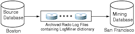

Figure 18-1 shows a sample LogMiner configuration. In this figure, the source database in Boston generates redo log files that are archived and shipped to a database in San Francisco. A LogMiner dictionary has been extracted to these redo log files. The mining database, where LogMiner will actually analyze the redo log files, is in San Francisco. The Boston database is running Oracle9i, and the San Francisco database is running Oracle Database 10g.
Figure 18-1 Sample LogMiner Database Configuration
Figure 18-1 shows just one valid LogMiner configuration. Other valid configurations are those that use the same database for both the source and mining database, or use another method for providing the data dictionary. These other data dictionary options are described in the section about LogMiner Dictionary Options.

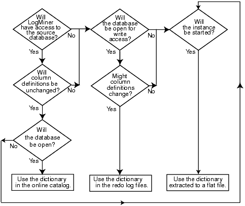

Figure 18-2 shows a decision tree to help you select a LogMiner dictionary, depending on your situation.
Figure 18-2 Decision Tree for Choosing a LogMiner Dictionary
