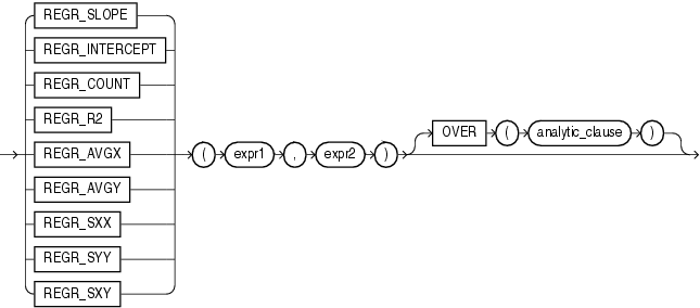

The linear regression functions are:
REGR_SLOPE
REGR_INTERCEPT
REGR_COUNT
REGR_R2
REGR_AVGX
REGR_AVGY
REGR_SXX
REGR_SYY
REGR_SXY

"Analytic Functions" for information on syntax, semantics, and restrictionsThe linear regression functions fit an ordinary-least-squares regression line to a set of number pairs. You can use them as both aggregate and analytic functions.
