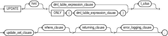

Use the UPDATE statement to change existing values in a table or in the base table of a view or the master table of a materialized view.
For you to update values in a table, the table must be in your own schema or you must have the UPDATE object privilege on the table.
For you to update values in the base table of a view:
You must have the UPDATE object privilege on the view, and
Whoever owns the schema containing the view must have the UPDATE object privilege on the base table.
The UPDATE ANY TABLE system privilege also allows you to update values in any table or in the base table of any view.
You must also have the SELECT object privilege on the object you want to update if:
The object is on a remote database or
The SQL92_SECURITY initialization parameter is set to TRUE and the UPDATE operation references table columns, such as the columns in a where_clause.
(DML_table_expression_clause::=, update_set_clause ::=, where_clause ::=, returning_clause::=, error_logging_clause::=)

Specify a comment that passes instructions to the optimizer on choosing an execution plan for the statement.
You can place a parallel hint immediately after the UPDATE keyword to parallelize both the underlying scan and UPDATE operations.
See Also:
"Using Hints" for the syntax and description of hints
Oracle Database Concepts for detailed information about parallel execution
The ONLY clause applies only to views. Specify ONLY syntax if the view in the UPDATE clause is a view that belongs to a hierarchy and you do not want to update rows from any of its subviews.

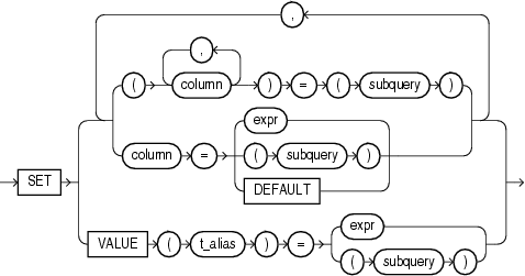

The update_set_clause lets you set column values.
Specify the name of a column of the object that is to be updated. If you omit a column of the table from the update_set_clause, then the value of that column remains unchanged.
If column refers to a LOB object attribute, then you must first initialize it with a value of empty or null. You cannot update it with a literal. Also, if you are updating a LOB value using some method other than a direct UPDATE SQL statement, then you must first lock the row containing the LOB. See for_update_clause for more information.
If column is a virtual column, you cannot specify it here. Rather, you must update the values from which the virtual column is derived.
If column is part of the partitioning key of a partitioned table, then UPDATE will fail if you change a value in the column that would move the row to a different partition or subpartition, unless you enable row movement. Refer to the row_movement_clause of CREATE TABLE or ALTER TABLE.
In addition, if column is part of the partitioning key of a list-partitioned table, then UPDATE will fail if you specify a value for the column that does not already exist in the partition_value list of one of the partitions.
Specify a subquery that returns exactly one row for each row updated.
If you specify only one column in the update_set_clause, then the subquery can return only one value.
If you specify multiple columns in the update_set_clause, then the subquery must return as many values as you have specified columns.
If the subquery returns no rows, then the column is assigned a null.

Specify an expression that resolves to the new value assigned to the corresponding column.
DEFAULT Specify DEFAULT to set the column to the value previously specified as the default value for the column. If no default value for the corresponding column has been specified, then the database sets the column to null.
Restriction on Updating to Default Values You cannot specify DEFAULT if you are updating a view.
The VALUE clause lets you specify the entire row of an object table.
Restriction on the VALUE clause You can specify this clause only for an object table.
