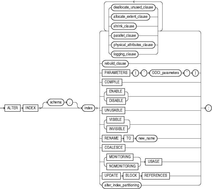

Use the ALTER INDEX statement to change or rebuild an existing index.

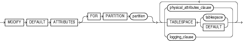

(physical_attributes_clause ::=, logging_clause::=)

Specify the schema containing the index. If you omit schema, then Oracle Database assumes the index is in your own schema.
Specify the name of the index to be altered.

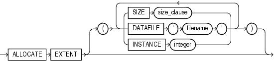

The allocate_extent_clause lets you explicitly allocate a new extent for the index. For a local index on a hash-partitioned table, Oracle Database allocates a new extent for each partition of the index.
Restriction on Allocating Extents You cannot specify this clause for an index on a temporary table or for a range-partitioned or composite-partitioned index.
Refer to allocate_extent_clause for a full description of this clause.

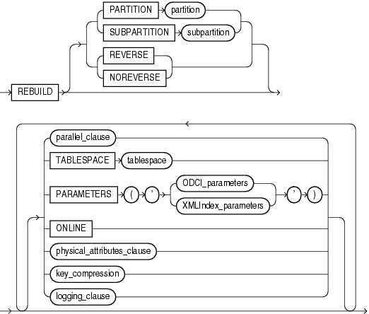

Use the rebuild_clause to re-create an existing index or one of its partitions or subpartitions. If index is marked UNUSABLE, then a successful rebuild will mark it USABLE. For a function-based index, this clause also enables the index. If the function on which the index is based does not exist, then the rebuild statement will fail.

Use the PARTITION clause to rebuild one partition of an index. You can also use this clause to move an index partition to another tablespace or to change a create-time physical attribute.

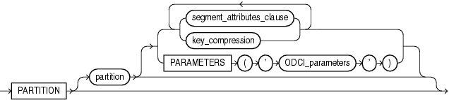

Restrictions on Modifying Index Subpartitions The modification of index subpartitions is subject to the following restrictions:
The only parameters you can specify for a subpartition are TABLESPACE, ONLINE, and the parallel_clause.

Indicate whether the bytes of the index block are stored in reverse order:
REVERSE stores the bytes of the index block in reverse order and excludes the rowid when the index is rebuilt.
NOREVERSE stores the bytes of the index block without reversing the order when the index is rebuilt. Rebuilding a REVERSE index without the NOREVERSE keyword produces a rebuilt, reverse-keyed index.

Use the parallel_clause to parallelize the rebuilding of the index.
Specify the tablespace where the rebuilt index, index partition, or index subpartition will be stored. The default is the default tablespace where the index or partition resided before you rebuilt it.
Specify COMPRESS to enable key compression, which eliminates repeated occurrence of key column values. Use integer to specify the prefix length (number of prefix columns to compress).

Specify ONLINE to allow DML operations on the table or partition during rebuilding of the index.

Specify whether the ALTER INDEX ... REBUILD operation will be logged.

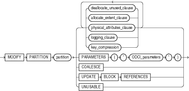

You can modify index partitions only if index is not marked IN_PROGRESS or FAILED, no index partitions are marked IN_PROGRESS, and the partition being modified is not marked FAILED.

Specify new values for the default attributes of a partitioned index.
Restriction on Modifying Partition Default Attributes The only attribute you can specify for a hash-partitioned global index or for an index on a hash-partitioned table is TABLESPACE.
TABLESPACE Specify the default tablespace for new partitions of an index or subpartitions of an index partition.
logging_clause Specify the default logging attribute of a partitioned index or an index partition.
Refer to logging_clause for a full description of this clause.
FOR PARTITION Use the FOR PARTITION clause to specify the default attributes for the subpartitions of a partition of a local index on a composite-partitioned table.
Restriction on FOR PARTITION You cannot specify FOR PARTITION for a list partition.
See Also:
"Modifying Default Attributes: Example"Use this clause to add a partition to a global hash-partitioned index. Oracle Database adds hash partitions and populates them with index entries rehashed from an existing hash partition of the index, as determined by the hash function. If you omit the partition name, then Oracle Database assigns a name of the form SYS_Pn. If you omit the TABLESPACE clause, then Oracle Database places the partition in the tablespace specified for the index. If no tablespace is specified for the index, then Oracle Database places the partition in the default tablespace of the user, if one has been specified, or in the system default tablespace.
Use the modify_index_partition clause to modify the real physical attributes, logging attribute, or storage characteristics of index partition partition or its subpartitions. For a hash-partitioned global index, the only subclause of this clause you can specify is UNUSABLE.
COALESCE Specify this clause to merge the contents of index partition blocks where possible to free blocks for reuse.
UPDATE BLOCK REFERENCES The UPDATE BLOCK REFERENCES clause is valid only for normal indexes on index-organized tables. Use this clause to update all stale guess data block addresses stored in the secondary index partition.
Restrictions on UPDATE BLOCK REFERENCES This clause is subject to the following restrictions:
You cannot specify the physical_attributes_clause for an index on a hash-partitioned table.
You cannot specify UPDATE BLOCK REFERENCES with any other clause in ALTER INDEX.
If the index is a local index on a composite-partitioned table, then the changes you specify here will override any attributes specified earlier for the subpartitions of index, as well as establish default values of attributes for future subpartitions of that partition. To change the default attributes of the partition without overriding the attributes of subpartitions, useALTER TABLE ... MODIFY DEFAULT ATTRIBUTES OF PARTITION.See Also:
"Marking an Index Unusable: Examples"UNUSABLE Clause This clause has the same function for index partitions that it has for the index as a whole. Refer to "UNUSABLE".
key_compression This clause is relevant for composite-partitioned indexes. Use this clause to change the compression attribute for the partition and every subpartition in that partition. Oracle Database marks each index subpartition in the partition UNUSABLE and you must then rebuild these subpartitions. Key compression must already have been specified for the table before you can specify key compression for a partition. You can specify this clause only at the partition level. You cannot change the compression attribute for an individual subpartition.
You can use this clause for noncomposite index partitions. However, it is more efficient to use the rebuild_clause for noncomposite partitions, which lets you rebuild and set the compression attribute in one step.

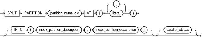

"Dropping an Index Partition: Example"Use the split_index_partition clause to split a partition of a global range-partitioned index into two partitions, adding a new partition to the index. This clause is not valid for hash-partitioned global indexes. Instead, use the add_hash_index_partition clause.
Splitting a partition marked UNUSABLE results in two partitions, both marked UNUSABLE. You must rebuild the partitions before you can use them.
Splitting a usable partition results in two partitions populated with index data. Both new partitions are usable.
AT Clause Specify the new noninclusive upper bound for split_partition_1. The value_list must evaluate to less than the presplit partition bound for partition_name_old and greater than the partition bound for the next lowest partition (if there is one).
INTO Clause Specify (optionally) the name and physical attributes of each of the two partitions resulting from the split.

Storing Index Blocks in Reverse Order: Example The following statement rebuilds index ord_customer_ix (created in "Creating an Index: Example") so that the bytes of the index block are stored in reverse order:
ALTER INDEX ord_customer_ix REBUILD REVERSE;

Splitting a Partition: Example The following statement splits partition p2 of index cost_ix (created in "Creating a Range-Partitioned Global Index: Example") into p2a and p2b:
ALTER INDEX cost_ix
   SPLIT PARTITION p2 AT (1500)
   INTO ( PARTITION p2a TABLESPACE tbs_01 LOGGING,
          PARTITION p2b TABLESPACE tbs_02);
