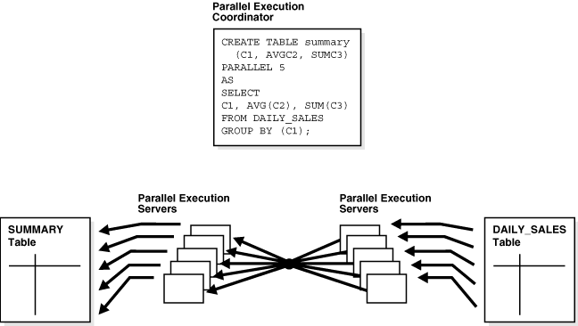

DDL statements
Some examples are CREATE TABLE AS SELECT, CREATE INDEX, REBUILD INDEX, REBUILD INDEX PARTITION, and MOVE/SPLIT/COALESCE PARTITION.
You can normally use parallel DDL where you use regular DDL. There are, however, some additional details to consider when designing your database. One important restriction is that parallel DDL cannot be used on tables with object or LOB columns.
All of these DDL operations can be performed in NOLOGGING mode for either parallel or serial execution.
The CREATE TABLE statement for an index-organized table can be parallelized either with or without an AS SELECT clause.
Different parallelism is used for different operations. Parallel create (partitioned) table as select and parallel create (partitioned) index run with a degree of parallelism (DOP) equal to the number of partitions.

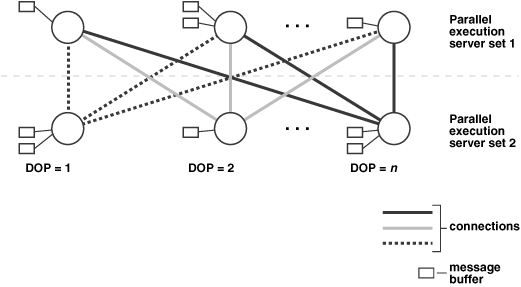

To execute a query in parallel, Oracle Database generally creates a producer queue server and a consumer server. The producer queue server retrieves rows from tables and the consumer server performs operations such as join, sort, DML, and DDL on these rows. Each server in the producer execution process set has a connection to each server in the consumer set. This means that the number of virtual connections between parallel execution servers increases as the square of the DOP.
Each communication channel has at least one, and sometimes up to four memory buffers. Multiple memory buffers facilitate asynchronous communication among the parallel execution servers.
A single-instance environment uses at most three buffers for each communication channel. An Oracle Real Application Clusters environment uses at most four buffers for each channel. Figure 25-1 illustrates message buffers and how producer parallel execution servers connect to consumer parallel execution servers.
Figure 25-1 Parallel Execution Server Connections and Buffers
When a connection is between two processes on the same instance, the servers communicate by passing the buffers back and forth. When the connection is between processes in different instances, the messages are sent using external high-speed network protocols. In Figure 25-1, the DOP is equal to the number of parallel execution servers, which in this case is n. Figure 25-1 does not show the parallel execution coordinator. Each parallel execution server actually has an additional connection to the parallel execution coordinator.

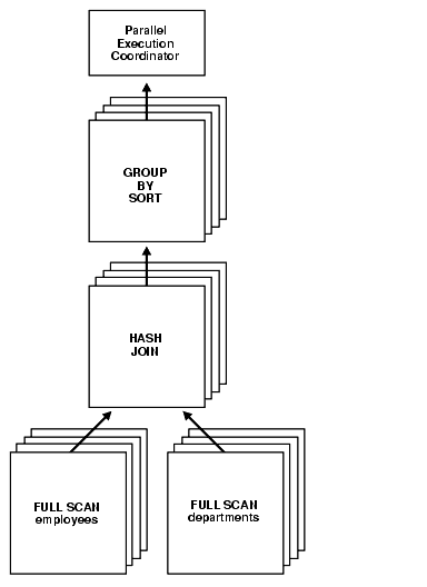

As an example of parallel query with intra- and inter-operation parallelism, consider the following, more complex query:
SELECT /*+ PARALLEL(employees 4) PARALLEL(departments 4)
       USE_HASH(employees) ORDERED */ MAX(salary), AVG(salary)
FROM employees, departments
WHERE employees.department_id = departments.department_id
GROUP BY employees.department_id;
Note that hints have been used in the query to force the join order and join method, and to specify the DOP of the tables employees and departments. In general, you should let the optimizer determine the order and method.
Figure 25-2 illustrates the data flow graph or query plan for this query.
Figure 25-2 Data Flow Diagram for Joining Tables
Given two sets of parallel execution servers SS1 and SS2 for the query plan illustrated in Figure 25-2, the execution will proceed as follows: each server set (SS1 and SS2) will have four execution processes because of the PARALLEL hint in the query that specifies the DOP. In other words, the DOP will be four because each set of parallel execution servers will have four processes.
Slave set SS1 first scans the table employees while SS2 will fetch rows from SS1 and build a hash table on the rows. In other words, the parent servers in SS2 and the child servers in SS2 work concurrently: one in scanning employees in parallel, the other in consuming rows sent to it from SS1 and building the hash table for the hash join in parallel. This is an example of inter-operation parallelism.
After SS1 has finished scanning the entire table employees (that is, all granules or task units for employees are exhausted), it scans the table departments in parallel. It sends its rows to servers in SS2, which then perform the probes to finish the hash-join in parallel. After SS1 is done scanning the table departments in parallel and sending the rows to SS2, it switches to performing the GROUP BY in parallel. This is how two server sets run concurrently to achieve inter-operation parallelism across various operators in the query tree while achieving intra-operation parallelism in executing each operation in parallel.

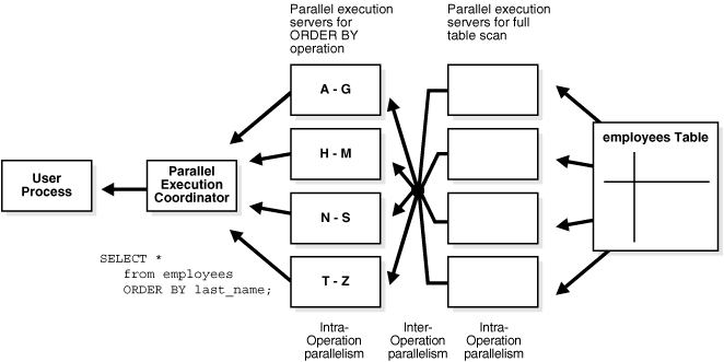

SELECT * FROM employees ORDER BY last_name;
The execution plan implements a full scan of the employees table. This operation is followed by a sorting of the retrieved rows, based on the value of the last_name column. For the sake of this example, assume the last_name column is not indexed. Also assume that the DOP for the query is set to 4, which means that four parallel execution servers can be active for any given operation.
Figure 25-3 illustrates the parallel execution of the example query.
Figure 25-3 Interoperation Parallelism and Dynamic Partitioning
As you can see from Figure 25-3, there are actually eight parallel execution servers involved in the query even though the DOP is 4. This is because a parent and child operator can be performed at the same time (interoperation parallelism).
Also note that all of the parallel execution servers involved in the scan operation send rows to the appropriate parallel execution server performing the SORT operation. If a row scanned by a parallel execution server contains a value for the last_name column between A and G, that row gets sent to the first ORDER BY parallel execution server. When the scan operation is complete, the sorting processes can return the sorted results to the coordinator, which, in turn, returns the complete query results to the user.

Parallel execution lets you parallelize the query and create operations of creating a table as a subquery from another table or set of tables.
Clustered tables cannot be created and populated in parallel.
Figure 25-4 illustrates creating a table from a subquery in parallel.
Figure 25-4 Creating a Summary Table in Parallel
When summary table data is derived from other tables' data, recoverability from media failure for the smaller summary table may not be important and can be turned off during creation of the summary table.

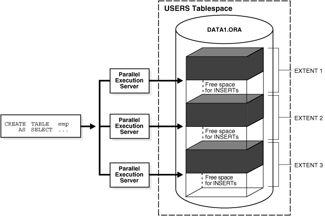

Creating a table or index in parallel has space management implications that affect both the storage space required during a parallel operation and the free space available after a table or index has been created.
When creating a table or index in parallel, each parallel execution server uses the values in the STORAGE clause of the CREATE statement to create temporary segments to store the rows. Therefore, a table created with a NEXT setting of 5 MB and a PARALLEL DEGREE of 12 consumes at least 60 megabytes (MB) of storage during table creation because each process starts with an extent of 5 MB. When the parallel execution coordinator combines the segments, some of the segments may be trimmed, and the resulting table may be smaller than the requested 60 MB.
When you create indexes and tables in parallel, each parallel execution server allocates a new extent and fills the extent with the table or index data. Thus, if you create an index with a DOP of 3, the index will have at least three extents initially. Allocation of extents is the same for rebuilding indexes in parallel and for moving, splitting, or rebuilding partitions in parallel.
Serial operations require the schema object to have at least one extent. Parallel creations require that tables or indexes have at least as many extents as there are parallel execution servers creating the schema object.
When you create a table or index in parallel, it is possible to create pockets of free space—either external or internal fragmentation. This occurs when the temporary segments used by the parallel execution servers are larger than what is needed to store the rows.
If the unused space in each temporary segment is larger than the value of the MINIMUM EXTENT parameter set at the tablespace level, then Oracle Database trims the unused space when merging rows from all of the temporary segments into the table or index. The unused space is returned to the system free space and can be allocated for new extents, but it cannot be coalesced into a larger segment because it is not contiguous space (external fragmentation).
If the unused space in each temporary segment is smaller than the value of the MINIMUM EXTENT parameter, then unused space cannot be trimmed when the rows in the temporary segments are merged. This unused space is not returned to the system free space; it becomes part of the table or index (internal fragmentation) and is available only for subsequent inserts or for updates that require additional space.
For example, if you specify a DOP of 3 for a CREATE TABLE ... AS SELECT statement, but there is only one datafile in the tablespace, then internal fragmentation may occur, as shown in Figure 25-5. The pockets of free space within the internal table extents of a datafile cannot be coalesced with other free space and cannot be allocated as extents.
See Oracle Database Performance Tuning Guide for more information about creating tables and indexes in parallel.
Figure 25-5 Unusable Free Space (Internal Fragmentation)

Note that the DOP applies directly only to intraoperation parallelism. If interoperation parallelism is possible, the total number of parallel execution servers for a statement can be twice the specified DOP. No more than two operations can be performed simultaneously.
Parallel execution is designed to effectively use multiple CPUs and disks to answer queries quickly. When multiple users employ parallel execution at the same time, available CPU, memory, and disk resources may be quickly exhausted. Oracle Database provides several ways to deal with resource utilization in conjunction with parallel execution, including:

Parallelization has two components: the decision to parallelize and the DOP. These components are determined differently for queries, DDL operations, and DML operations.
To determine the DOP, Oracle Database looks at the reference objects:
Parallel query looks at each table and index, in the portion of the query being parallelized, to determine which is the reference table. The basic rule is to pick the table or index with the largest DOP.
For parallel DML (INSERT, UPDATE, MERGE, and DELETE), the reference object that determines the DOP is the table being modified by an insert, update, or delete operation. Parallel DML also adds some limits to the DOP to prevent deadlock. If the parallel DML statement includes a subquery, the subquery's DOP is the same as the DML operation.
For parallel DDL, the reference object that determines the DOP is the table, index, or partition being created, rebuilt, split, or moved. If the parallel DDL statement includes a subquery, the subquery's DOP is the same as the DDL operation.

The CREATE TABLE ... AS SELECT statement contains two parts: a CREATE part (DDL) and a SELECT part (query). Oracle Database can parallelize both parts of the statement. The CREATE part follows the same rules as other DDL operations.
The query part of a CREATE TABLE ... AS SELECT statement can be parallelized only if the following conditions are satisfied:
The query includes a parallel hint specification (PARALLEL or PARALLEL_INDEX) or the CREATE part of the statement has a PARALLEL clause specification or the schema objects referred to in the query have a PARALLEL declaration associated with them.
At least one of the tables specified in the query requires one of the following: a full table scan or an index range scan spanning multiple partitions.
The DOP for the query part of a CREATE TABLE ... AS SELECT statement is determined by one of the following rules:
The query part uses the values specified in the PARALLEL clause of the CREATE part.
If the PARALLEL clause is not specified, the default DOP is the number of CPUs.
If the CREATE is serial, then the DOP is determined by the query.
Note that any values specified in a hint for parallelism are ignored.
The CREATE operation of CREATE TABLE ... AS SELECT can be parallelized only by a PARALLEL clause or an ALTER SESSION FORCE PARALLEL DDL statement.
When the CREATE operation of CREATE TABLE ... AS SELECT is parallelized, Oracle Database also parallelizes the scan operation if possible. The scan operation cannot be parallelized if, for example:

The DOP specifies the number of available processes, or threads, used in parallel operations. Each parallel thread can use one or two query processes, depending on the query's complexity.
The adaptive multiuser feature adjusts the DOP based on user load. For example, you might have a table with a DOP of 5. This DOP might be acceptable with 10 users. However, if 10 more users enter the system and you enable the PARALLEL_ADAPTIVE_MULTI_USER feature, Oracle Database reduces the DOP to spread resources more evenly according to the perceived load.
Once Oracle Database determines the DOP for a query, the DOP does not change for the duration of the query.

Oracle Database uses a fixed number of buffers for each virtual connection between producer query servers and consumer query servers. Connections increase as the square of the DOP increases. For this reason, the maximum amount of memory used by parallel execution is bound by the highest DOP allowed on your system. You can control this value by using either the PARALLEL_MAX_SERVERS parameter or by using policies and profiles.
To calculate the amount of memory required, use one of the following formulas:
For SMP systems:
mem in bytes = (3 x size x users x groups x connections)
For SMP Real Application Clusters and MPP systems:
mem in bytes = ((3 x local) + (2 x remote)) x (size x users x groups) / instances
Each instance uses the memory computed by the formula.
The terms are:
SIZE = PARALLEL_EXECUTION_MESSAGE_SIZE
USERS = the number of concurrent parallel execution users that you expect to have running with the optimal DOP
GROUPS = the number of query server process groups used for each query
A simple SQL statement requires only one group. However, if your queries involve subqueries which will be processed in parallel, then Oracle Database uses an additional group of query server processes.
CONNECTIONS = (DOP2 + 2 x DOP)
If your system is a cluster or MPP, then you should account for the number of instances because this will increase the DOP. In other words, using a DOP of 4 on a two instance cluster results in a DOP of 8. A value of PARALLEL_MAX_SERVERS times the number of instances divided by four is a conservative estimate to use as a starting point.
LOCAL = CONNECTIONS/INSTANCES
REMOTE = CONNECTIONS - LOCAL

Oracle Database cannot return results to a user process in parallel. If a query returns a large number of rows, execution of the query might indeed be faster. However, the user process can only receive the rows serially. To optimize parallel execution performance for queries that retrieve large result sets, use PARALLEL CREATE TABLE ... AS SELECT or direct-path INSERT to store the result set in the database. At a later time, users can view the result set serially.
Performing the SELECT in parallel does not influence the CREATE statement. If the CREATE is parallel, however, the optimizer tries to make the SELECT run in parallel also.
When combined with the NOLOGGING option, the parallel version of CREATE TABLE ... AS SELECT provides a very efficient intermediate table facility, for example:
CREATE TABLE summary PARALLEL NOLOGGING AS SELECT dim_1, dim_2 ..., SUM (meas_1) FROM facts GROUP BY dim_1, dim_2;

For optimal space management performance, you should use locally managed temporary tablespaces. The following is an example:
CREATE TEMPORARY TABLESPACE TStemp TEMPFILE '/dev/D31' SIZE 4096MB REUSE EXTENT MANAGEMENT LOCAL UNIFORM SIZE 10m;
You can associate temporary tablespaces to a database by issuing a statement such as:
ALTER DATABASE TEMPORARY TABLESPACE TStemp;
Once this is done, explicit assignment of users to tablespaces is not needed.
When using a locally managed temporary tablespace, extents are all the same size because this helps avoid fragmentation. As a general rule, temporary extents should be smaller than permanent extents because there are more demands for temporary space, and parallel processes or other operations running concurrently must share the temporary tablespace. Normally, temporary extents should be in the range of 1MB to 10MB. Once you allocate an extent, it is available for the duration of an operation. If you allocate a large extent but only need to use a small amount of space, the unused space in the extent is unavailable.
At the same time, temporary extents should be large enough that processes do not have to wait for space. Temporary tablespaces use less overhead than permanent tablespaces when allocating and freeing a new extent. However, obtaining a new temporary extent still requires the overhead of acquiring a latch and searching through the SGA structures, as well as SGA space consumption for the sort extent pool.
