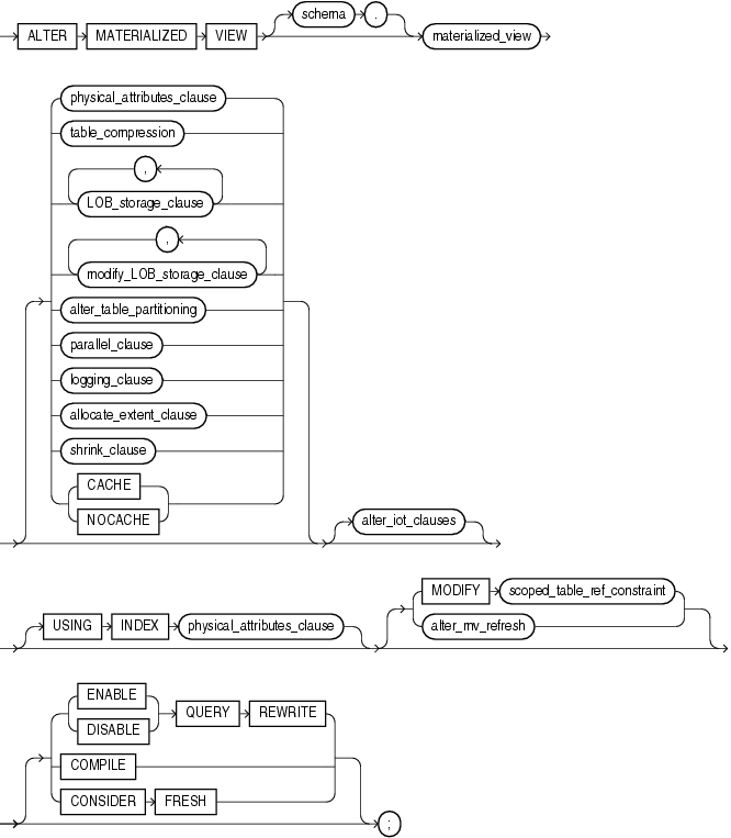

A materialized view is a database object that contains the results of a query. The FROM clause of the query can name tables, views, and other materialized views. Collectively these source objects are called master tables (a replication term) or detail tables (a data warehousing term). This reference uses the term master tables for consistency. The databases containing the master tables are called the master databases.
Use the ALTER MATERIALIZED VIEW statement to modify an existing materialized view in one or more of the following ways:

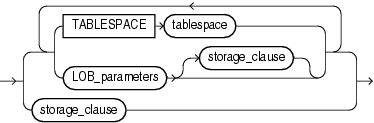

(storage_clause::=, LOB_retention_clause::=, LOB_compression_clause::=, logging_clause::=, allocate_extent_clause::=, shrink_clause::=, deallocate_unused_clause::=)

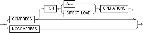

Use the table_compression clause to instruct Oracle Database whether to compress data segments to reduce disk and memory use. Refer to the table_compression clause of CREATE TABLE for the full semantics of this clause.

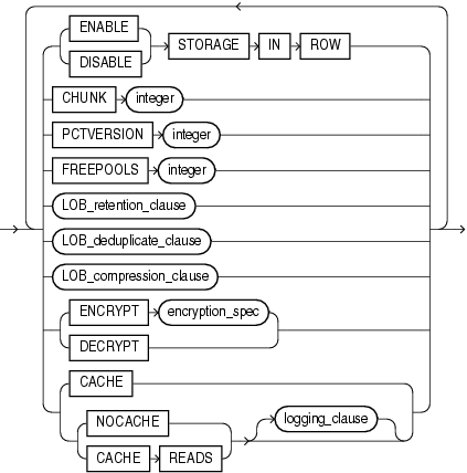

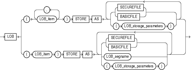

The LOB_storage_clause lets you specify the storage characteristics of a new LOB. LOB storage behaves for materialized views exactly as it does for tables. Refer to the LOB_storage_clause (in CREATE TABLE) for information on the LOB storage parameters.

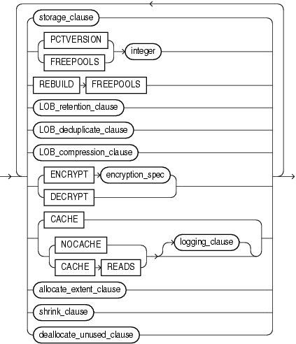

The modify_LOB_storage_clause lets you modify the physical attributes of the LOB attribute LOB_item or the LOB object attribute. Modification of LOB storage behaves for materialized views exactly as it does for tables.

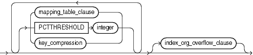

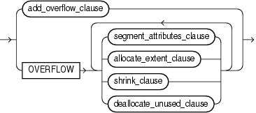

Use the alter_iot_clauses to change the characteristics of an index-organized materialized view. The keywords and parameters of the components of the alter_iot_clauses have the same semantics as in ALTER TABLE, with the restrictions that follow.
Restrictions on Altering Index-Organized Materialized Views You cannot specify the mapping_table_clause or the key_compression clause of the index_org_table_clause.

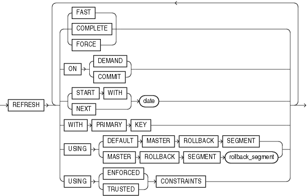

Use the alter_mv_refresh clause to change the default method and mode and the default times for automatic refreshes. If the contents of the master tables of a materialized view are modified, then the data in the materialized view must be updated to make the materialized view accurately reflect the data currently in its master table(s). This clause lets you schedule the times and specify the method and mode for Oracle Database to refresh the materialized view.
This clause only sets the default refresh options. For instructions on actually implementing the refresh, refer to Oracle Database Advanced Replication and Oracle Database Data Warehousing Guide.Specify FAST for the incremental refresh method, which performs the refresh according to the changes that have occurred to the master tables. The changes are stored either in the materialized view log associated with the master table (for conventional DML changes) or in the direct loader log (for direct-path INSERT operations).
For both conventional DML changes and for direct-path INSERT operations, other conditions may restrict the eligibility of a materialized view for fast refresh.

"Analytic Functions"Specify COMPLETE for the complete refresh method, which is implemented by executing the defining query of the materialized view. If you specify a complete refresh, then Oracle Database performs a complete refresh even if a fast refresh is possible.
See Also:
"Complete Refresh: Example"Specify FORCE if, when a refresh occurs, you want Oracle Database to perform a fast refresh if one is possible or a complete refresh otherwise.
Specify ON COMMIT if you want a fast refresh to occur whenever Oracle Database commits a transaction that operates on a master table of the materialized view.
Restriction on ON COMMIT This clause is supported only for materialized join views and single-table materialized aggregate views.
Specify ON DEMAND if you want the materialized view to be refreshed on demand by calling one of the three DBMS_MVIEW refresh procedures. If you omit both ON COMMIT and ON DEMAND, then ON DEMAND is the default.
If you specify ON COMMIT or ON DEMAND, then you cannot also specify START WITH or NEXT.

Specify START WITH date to indicate a date for the first automatic refresh time.
Specify NEXT to indicate a date expression for calculating the interval between automatic refreshes.
Both the START WITH and NEXT values must evaluate to a time in the future. If you omit the START WITH value, then Oracle Database determines the first automatic refresh time by evaluating the NEXT expression with respect to the creation time of the materialized view. If you specify a START WITH value but omit the NEXT value, then Oracle Database refreshes the materialized view only once. If you omit both the START WITH and NEXT values, or if you omit the alter_mv_refresh entirely, then Oracle Database does not automatically refresh the materialized view.
Specify WITH PRIMARY KEY to change a rowid materialized view to a primary key materialized view. Primary key materialized views allow materialized view master tables to be reorganized without affecting the ability of the materialized view to continue to fast refresh.
For you to specify this clause, the master table must contain an enabled primary key constraint and must have defined on it a materialized view log that logs primary key information.
