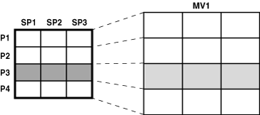

Most data warehouses have periodic incremental updates to their detail data. As described in "Materialized View Schema Design", you can use the SQL*Loader or any bulk load utility to perform incremental loads of detail data. Fast refresh of your materialized views is usually efficient, because instead of having to recompute the entire materialized view, the changes are applied to the existing data. Thus, processing only the changes can result in a very fast refresh time.
When there have been some partition maintenance operations on the detail tables, this is the only method of fast refresh that can be used. PCT-based refresh on a materialized view is enabled only if all the conditions described in "Partition Change Tracking" are satisfied.
In the absence of partition maintenance operations on detail tables, when you request a FAST method (method => 'F') of refresh through procedures in DBMS_MVIEW package, Oracle will use a heuristic rule to try log-based rule fast refresh before choosing PCT refresh. Similarly, when you request a FORCE method (method => '?'), Oracle will choose the refresh method based on the following attempt order: log-based fast refresh, PCT refresh, and complete refresh. Alternatively, you can request the PCT method (method => 'P'), and Oracle will use the PCT method provided all PCT requirements are satisfied.
Oracle can use TRUNCATE PARTITION on a materialized view if it satisfies the conditions in "Benefits of Partitioning a Materialized View" and hence, make the PCT refresh process more efficient.

The use of these views is illustrated in the following examples. Figure 15-1 illustrates a range-list partitioned table and a materialized view based on it. The partitions are P1, P2, P3, and P4, while the subpartitions are SP1, SP2, and SP3.
This section illustrates examples of determining the PCT and freshness information for materialized views and their detail tables.

Example 15-10 Verifying Which Partitions are Fresh
Query USER_MVIEW_DETAIL_PARTITION to access PCT freshness information for partitions, as shown in the following:
SELECT MVIEW_NAME,DETAILOBJ_NAME,DETAIL_PARTITION_NAME, DETAIL_PARTITION_POSITION,FRESHNESS FROM USER_MVIEW_DETAIL_PARTITION WHERE MVIEW_NAME = MV1;
MVIEW_NAME  DETAILOBJ_NAME  DETAIL_PARTITION_NAME  DETAIL_PARTITION_POSITION  FRESHNESS
       MV1               T1                    P1                          1      FRESH
       MV1               T1                    P2                          2      FRESH
       MV1               T1                    P3                          3      STALE
       MV1               T1                    P4                          4      FRESH
Example 15-11 Verifying Which Subpartitions are Fresh
Query USER_MVIEW_DETAIL_SUBPARTITION to access PCT freshness information for subpartitions, as shown in the following:
SELECT MVIEW_NAME,DETAILOBJ_NAME,DETAIL_PARTITION_NAME, DETAIL_SUBPARTITION_NAME,
    DETAIL_SUBPARTITION_POSITION,FRESHNESS
FROM USER_MVIEW_DETAIL_SUBPARTITION
MVIEW_NAME DETAILOBJ DETAIL_PARTITION DETAIL_SUBPARTITION_NAME DETAIL_SUBPARTITION_POS FRESHNESS
       MV1        T1               P1                      SP1                       1     FRESH
       MV1        T1               P1                      SP2                       1     FRESH
       MV1        T1               P1                      SP3                       1     FRESH
       MV1        T1               P2                      SP1                       1     FRESH
       MV1        T1               P2                      SP2                       1     FRESH
       MV1        T1               P2                      SP3                       1     FRESH
       MV1        T1               P3                      SP1                       1     STALE
       MV1        T1               P3                      SP2                       1     STALE
       MV1        T1               P3                      SP3                       1     STALE
       MV1        T1               P4                      SP1                       1     FRESH
       MV1        T1               P4                      SP2                       1     FRESH
       MV1        T1               P4                      SP3                       1     FRESH

A major maintenance component of a data warehouse is synchronizing (refreshing) the materialized views when the detail data changes. Partitioning the underlying detail tables can reduce the amount of time taken to perform the refresh task. This is possible because partitioning enables refresh to use parallel DML to update the materialized view. Also, it enables the use of Partition Change Tracking.
In a data warehouse, changes to the detail tables can often entail partition maintenance operations, such as DROP, EXCHANGE, MERGE, and ADD PARTITION. To maintain the materialized view after such operations used to require manual maintenance (see also CONSIDER FRESH) or complete refresh. You now have the option of using an addition to fast refresh known as Partition Change Tracking (PCT) refresh.
For PCT to be available, the detail tables must be partitioned. The partitioning of the materialized view itself has no bearing on this feature. If PCT refresh is possible, it will occur automatically and no user intervention is required in order for it to occur. See "Partition Change Tracking" for PCT requirements.
The following examples illustrate the use of this feature. In "PCT Fast Refresh Scenario 1", assume sales is a partitioned table using the time_id column and products is partitioned by the prod_category column. The table times is not a partitioned table.
The following materialized view satisfies requirements for PCT.
