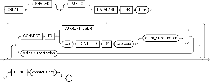

Use the CREATE DATABASE LINK statement to create a database link. A database link is a schema object in one database that enables you to access objects on another database. The other database need not be an Oracle Database system. However, to access non-Oracle systems you must use Oracle Heterogeneous Services.
After you have created a database link, you can use it in SQL statements to refer to tables and views on the other database by appending @dblink to the table or view name. You can query a table or view on the other database with the SELECT statement. You can also access remote tables and views using any INSERT, UPDATE, DELETE, or LOCK TABLE statement.

To create a private database link, you must have the CREATE DATABASE LINK system privilege. To create a public database link, you must have the CREATE PUBLIC DATABASE LINK system privilege. Also, you must have the CREATE SESSION system privilege on the remote Oracle database.
Oracle Net must be installed on both the local and remote Oracle databases.
Specify PUBLIC to create a public database link visible to all users. If you omit this clause, then the database link is private and is available only to you.
The data accessible on the remote database depends on the identity the database link uses when connecting to the remote database:
If you specify CONNECT TO user IDENTIFIED BY password, then the database link connects with the specified user and password.
If you specify CONNECT TO CURRENT_USER, then the database link connects with the user in effect based on the scope in which the link is used.
If you omit both of those clauses, then the database link connects to the remote database as the locally connected user.
Specify SHARED to create a database link that can be shared by multiple sessions using a single network connection from the source database to the target database. In a shared server configuration, shared database links can keep the number of connections into the remote database from becoming too large. Shared links are typically also public database links. However, a shared private database link can be useful when many clients access the same local schema, and therefore use the same private database link.
In a shared database link, multiple sessions in the source database share the same connection to the target database. Once a session is established on the target database, that session is disassociated from the connection, to make the connection available to another session on the source database. To prevent an unauthorized session from attempting to connect through the database link, when you specify SHARED you must also specify the dblink_authentication clause for the users authorized to use the database link.

The CONNECT TO clause lets you specify the user and credentials, if any, to be used to connect to the remote database.
Specify CURRENT_USER to create a current user database link. The current user must be a global user with a valid account on the remote database.
If the database link is used directly rather than from within a stored object, then the current user is the same as the connected user.
When executing a stored object (such as a procedure, view, or trigger) that initiates a database link, CURRENT_USER is the name of the user that owns the stored object, and not the name of the user that called the object. For example, if the database link appears inside procedure scott.p (created by scott), and user jane calls procedure scott.p, then the current user is scott.
However, if the stored object is an invoker-rights function, procedure, or package, then the invoker's authorization ID is used to connect as a remote user. For example, if the privileged database link appears inside procedure scott.p (an invoker-rights procedure created by scott), and user Jane calls procedure scott.p, then CURRENT_USER is jane and the procedure executes with Jane's privileges.
See Also:
CREATE FUNCTION for more information on invoker-rights functions
Specify the user name and password used to connect to the remote database using a fixed user database link. If you omit this clause, then the database link uses the user name and password of each user who is connected to the database. This is called a connected user database link.
You can specify this clause only if you are creating a shared database link—that is, you have specified the SHARED clause. Specify the username and password on the target instance. This clause authenticates the user to the remote server and is required for security. The specified username and password must be a valid username and password on the remote instance. The username and password are used only for authentication. No other operations are performed on behalf of this user.
Specify the service name of a remote database. If you specify only the database name, then Oracle Database implicitly appends the database domain to the connect string to create a complete service name. Therefore, if the database domain of the remote database is different from that of the current database, then you must specify the complete service name.
