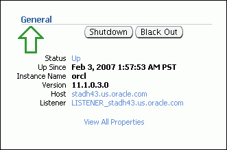

You can determine your Oracle Database version at the Enterprise Manager Database Control (Database Control) Database Home page.
To determine the Oracle Database version:
View the Version number under General on the Database Home page.

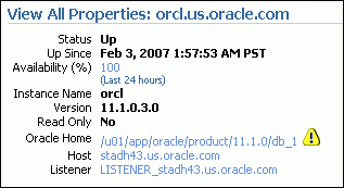

Your Oracle home is the operating system location of your Oracle Database installation.
To determine the location of your Oracle home:
In the General section of the Database Home page, click View All Properties.
The View All Properties page appears.
This page displays the path to your Oracle home.
Click the path link next to Oracle Home.
The Oracle home: Oracle_home page appears, as shown in Figure 12-1.

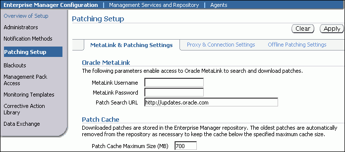

Before you begin using the patching features of Database Control, you must configure your OracleMetaLink credentials. After you specify your OracleMetaLink credentials, an automated process called the RefreshFromMetalink job can search OracleMetaLink every day for patches that are applicable to your installed software. You also receive notification about critical patch advisories.
To set your OracleMetaLink login credentials:
Click the Setup link located at the top and bottom of most Database Control pages.
The Setup page appears.
Click Patching Setup.
The Patching Setup subpage appears.
Enter the user name and password for logging in to OracleMetaLink in the MetaLink Username and MetaLink Password fields.
(Optional) Enter the maximum size of your patch cache in the Patch Cache Maximum Size (MB) field.
The patch cache is a temporary area where patches are stored. When the patch cache exceeds the specified maximum size, Database Control automatically performs a purge operation and tries to delete old patches until the patch cache is smaller than the specified maximum size.
Click Apply to set your OracleMetaLink credentials.

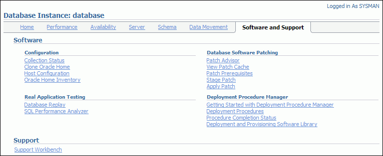

From the Database Home page, click Software and Support.
The Database Instance: instance_name page appears.
In the Database Software Patching section, select Apply Patch.

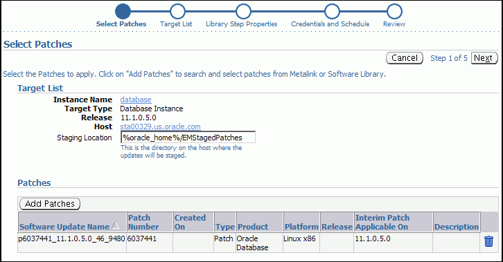

The Select Patches page appears.

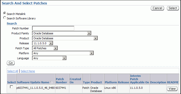

Click Add Patches to search for new patches to apply.
The Search and Select Patches page appears.
In the Search section, choose your current database release from the list of values in the Release list, for example, 11.1.0.5.0. From the Platform list choose the name that matches your installed operating system, for example, Linux x86. After you have made your selections, click Go.
You can optionally limit your search further by choosing different values for Product Family, Product, Patch Type, and Language, and then clicking Go.
(Optional) Select a patch or patch set and click View to view the patch details.
Select a patch or patch set and start the Patching wizard by clicking Select in the top right corner of the page.
If the patch or patch set you selected in Step 5 does not appear in the Patches table, click Add Patch and repeat the search to locate the patch. When the patch or patch set you have selected is displayed in the Patches table, click Next.

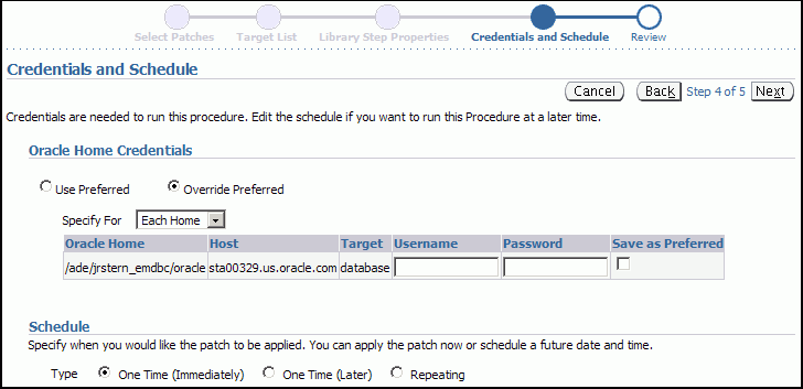

The Credentials and Schedule page appears.
Enter the credentials for the operating system user that will perform the patching operation. If you have already configured Preferred Credentials, you can choose the Use Preferred option.
For the Schedule Type option, use the default value of One Time (Immediately). Optionally, you can choose to schedule the patching for a later time using the One Time (Later) option. Click Next to continue.

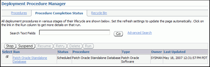

The Deployment Procedure Manager page appears.

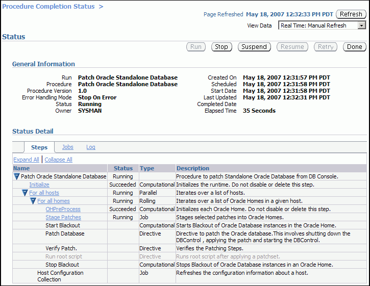

(Optional) To view the progress of the recently submitted patching operation, click Patch Oracle Standalone Database.
The Procedure Completion Status page appears.
As part of the patching procedure, the database instance and Database Control are shut down and then restarted. After they have restarted, you must log in again and navigate to the Procedure Completion Status page to check the status.
After you have reviewed the status of each step, you can click Refresh to update the display if the procedure has not yet completed.
When you have finished viewing the results, click Done.

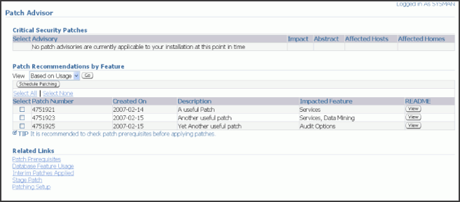

The Patch Advisor in Enterprise Manager describes critical software patches for your installed Oracle products. To help ensure a secure and reliable configuration, all relevant and current critical patches should be applied.
The Patch Advisor provides support for Remedies. When you select an advisory, you can view the calculated remedies from the context of that Advisory, as well as the affected Oracle homes.
The Patch Advisor also displays a list of available patches and patch sets for your installation, along with the name of the feature that is impacted. You can choose to display only patches for features that are used by your database, or all available patches.
To view the critical patch advisories and other recommended patches:
Using Database Control, on the Database Home page, in the Policy Violations section, view the count for Critical Security Patches.
If any critical patches have not been applied to the Oracle home for the database, this section displays the number of critical patch advisories that are relevant to the Oracle home for the database. Also, a warning icon appears corresponding to the Oracle Home link on the Database Home page is the Oracle home is missing critical patches.
To view a list of available critical patch advisories, click the nonzero number next to the heading Critical Security Patches. Alternatively, from the Database Home page, select the Software and Support subtab, then, under the heading Database Software Patching, click Patch Advisor.
The Patch Advisor page appears, listing the available critical security patches and patch recommendations by feature.
(Optional) In the Critical Security Patches table, click a value in the Advisory column to view further details for that critical security patch.
(Optional) To view all available patches, in the Patch Recommendations by Feature table, in the View list, select the value All, then click Go.
