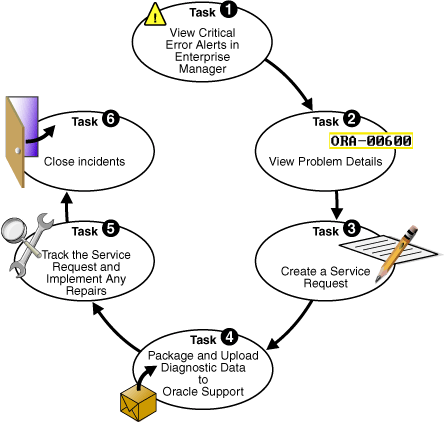

This section describes the typical set of tasks that you perform to investigate and report a problem (critical error), and in some cases, resolve the problem. The section begins with a roadmap that summarizes these tasks.
The workflow described in this section includes only the minimum tasks that are required to investigate, report, and in some cases, repair a problem. See Oracle Database Administrator's Guide for a more complete workflow that includes additional diagnostics-gathering activities and data customization activities that you can do before uploading the diagnostic data to Oracle Support Services. In some cases, these additional activities may result in a shorter time to problem resolution.You can begin investigating a problem by starting from the Support Workbench Home page. However, the more typical workflow begins with a critical error alert on the Database Home page. This documentation provides an overview of that workflow.
Figure 11-1 illustrates the basic tasks that you complete when encountering a problem.
Figure 11-1 Workflow for Investigating, Reporting, and Resolving a Problem
The following are task descriptions. Subsequent sections provide details for each task.
Task 1 – View Critical Error Alerts in Enterprise Manager
Start by accessing the Database Home page in Enterprise Manager, and reviewing critical error alerts. Select an alert for which to view details. From the alert details page, go to the Problem Details page.
Examine the problem details and view a list of incidents that were recorded for the problem. Display findings from any health checks that were automatically run.
Task 3 – (Optional) Create a Service Request
Create a service request using OracleMetaLink and optionally record the service request number with the problem information. If you skip this step, you can create a service request later, or the Support Workbench can create one for you.
Task 4 – Package and Upload Diagnostic Data to Oracle Support Services
Invoke a guided workflow (a wizard) that automatically packages all gathered diagnostic data for a problem and uploads the data to Oracle Support Services.
Task 5 – Track the Service Request and Implement Any Repairs
Optionally maintain an activity log for the service request in the Support Workbench. If appropriate, run Oracle advisors to help repair SQL failures or corrupted data.
Set the status for one, some, or all incidents for the problem to Closed.

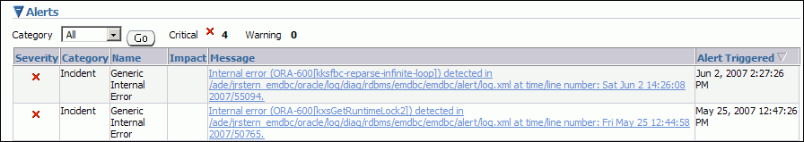

You begin the process of investigating problems (critical errors) by reviewing critical error alerts on the Database Home page.
To view critical error alerts:
Go to the Database Home page in Enterprise Manager.
In the Alerts section, examine the table of alerts.
Critical error alerts are indicated by an X in the Severity column, and the text "Incident" in the Category column.
You may have to click the hide/show arrowhead icon next to the Alerts heading to display the alerts table.
(Optional) In the Category list, select Incident to view alerts of type Incident only.
In the Message column, click the message of the critical error alert that you want investigate.

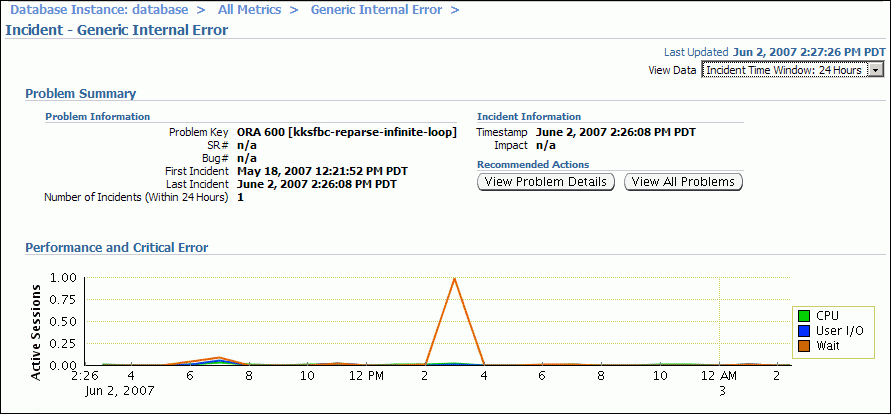

An Incident detail or Data Failure page appears for the type of incident you selected. For example, if you clicked a message about an ORA-600 error, the Incident - Generic Internal Error page appears.
This page displays:
Problem information, including the number of incidents for the problem
A Performance and Critical Error graphical timeline for the 24-hour time period in which the critical error occurred
Alert details, including severity, timestamp, and message
Controls that enable you to clear the alert or record a comment about it
Review the Performance and Critical Error graphical timeline, and note any time correlation between performance issues and the critical error. Optionally clear the alert or leave a comment about it.

If you want to view the details of the problem associated with the critical error alert that you are investigating, proceed with Task 2 – View Problem Details.
If the graphical timeline shows a large number of different problems during the 24-hour time period and you want to view a summary of all those problems, complete these steps:
Click View All Problems.

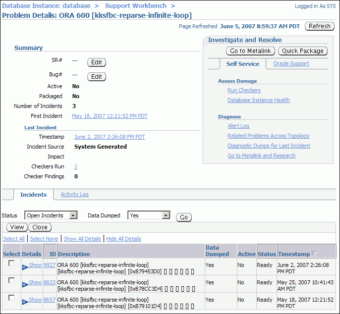

You continue your investigation with the Problem Details page.
On the Incident detail or Data Failure page, click View Problem Details.
The Problem Details page appears, showing the Incidents subpage.
(Optional) To view incident details, in the Incidents subpage, select an incident, and then click View.
The Incident Details page appears, showing the Dump Files subpage.
(Optional) On the Incident Details page, click Checker Findings to view the Checker Findings subpage.

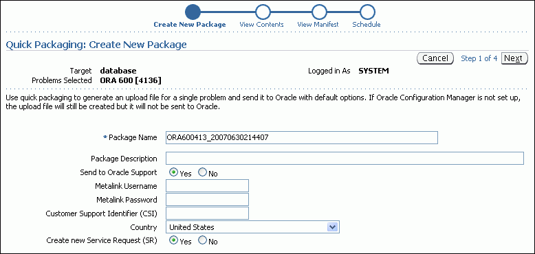

For this task, you use the quick packaging process of the Support Workbench to package and upload the diagnostic information for the problem to Oracle Support Services. Quick packaging has a minimum of steps, organized in a guided workflow (a wizard). The wizard assists you with creating an incident package (referred to as a package) for a single problem, creating a ZIP file from the package, and uploading the file. With quick packaging, you are not able to edit or otherwise customize the diagnostic information that is uploaded. Using quick packaging is the direct, straightforward method to package and upload diagnostic data.
If you want to edit or remove sensitive data from the diagnostic information, enclose additional user files (such as application configuration files or scripts), or perform other customizations before uploading, you must use the custom packaging process. See Oracle Database Administrator's Guide for instructions. When you complete those instructions, you may continue with Task 5 – Track the Service Request and Implement Any Repairs.
The Support Workbench uses Oracle Configuration Manager to upload the diagnostic data. If Oracle Configuration Manager is not installed or properly configured, the upload may fail. In this case, a message is displayed with a request that you upload the file to Oracle Support manually. You can upload files manually with OracleMetaLink.For more information about Oracle Configuration Manager, see Oracle Configuration Manager Installation and Administration Guide.
To package and upload diagnostic data to Oracle Support:
On the Problem Details page, in the Investigate and Resolve section, click Quick Package.
The Create New Package page of the Quick Packaging wizard appears.
(Optional) Enter a package name and description.
Fill in the remaining fields on the page. If you have already created a service request for this problem, select No next to Create new Service Request (SR).
If you select Yes, the Quick Packaging wizard creates a draft service request on your behalf. You must later log in to OracleMetaLink and fill in the details of the service request.
Click Next, and then proceed with the remaining pages of the Quick Packaging wizard.

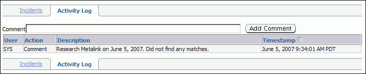

Adding comments to the problem activity log.
You may want to do this to share problem status or history information with other DBAs in your organization. For example, you could record the results of your conversations with Oracle Support.
To add comments to the problem activity log:
Go to the Problem Details page for the problem, as described in "Viewing Problems Using the Enterprise Manager Support Workbench".
Click Activity Log to display the Activity Log subpage.
In the Comment field, enter a comment, and then click Add Comment.
Your comment is recorded in the activity log.

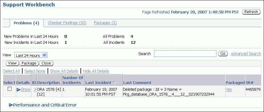

You use the Enterprise Manager Support Workbench home page to view all problems or only those within a specified time period.
To access the Support Workbench home page:
Click Software and Support to view the Software and Support page.
In the Support section, click Support Workbench.
The Support Workbench home page appears, showing the Problems subpage. By default the problems from the last 24 hours are displayed.
To view all problems, select All from the View list.
(Optional) If the Performance and Critical Error section is hidden, click the Show/Hide icon adjacent to the section heading to show the section.
This section enables you to view any correlation between performance changes for your database and incident occurrences.
(Optional) Under the Details column, click Show to display a list of all incidents for a problem, and then click an incident ID to display the Incident Details page.
To view details for a particular problem:
On the Support Workbench home page, select the problem, and then click View.
(Optional) To view closed incidents as well as open incidents, select All from the View list.
(Optional) To view details for an incident, select the incident, and then click View.
The Incident Details page appears.
(Optional) To view checker findings for the incident, on the Incident Details page, click Checker Findings.
