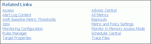

Navigational features of the Database Home page include the following:
Subpage links at the top of the page. These links take you to the various Database Control subpages that organize management tasks into distinct categories. For example, you click Availability to perform tasks associated with backing up and recovering your data.
Drill-down links that provide increasing levels of detail.
For example, clicking the link next to the label Host provides additional detail about the computer on which the database runs.
Suggested related links for more information.

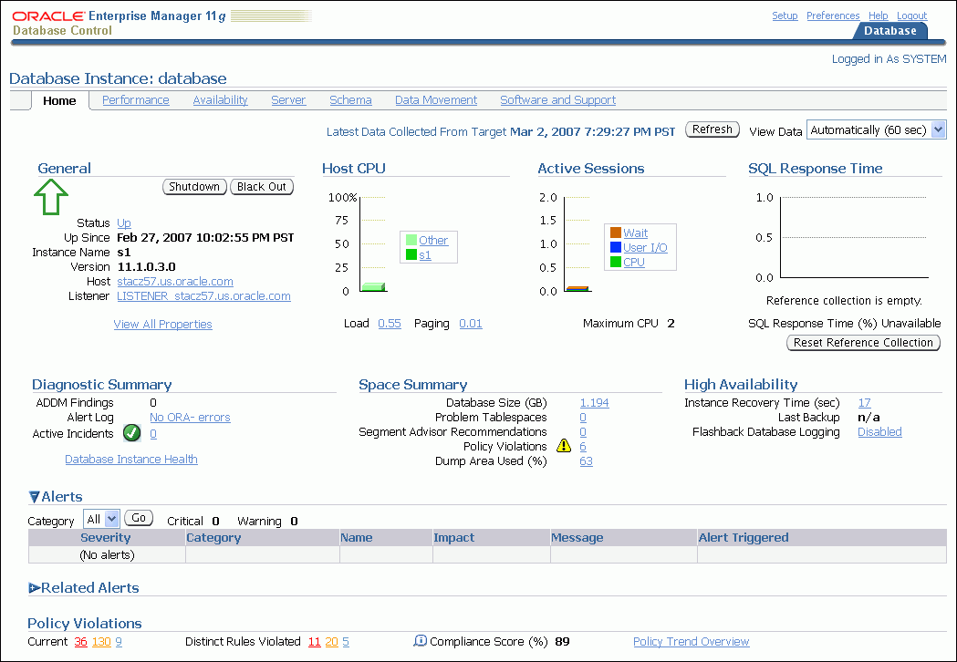

The Database Home page is the main database management page in Oracle Enterprise Manager Database Control (Database Control).
To access the Database Home page:
Ensure that the dbconsole process is running on the database host computer.
See "Starting and Stopping the Database Control Console Process".
In your Web browser, enter the following URL:
https://hostname:portnumber/em
For example, if you installed the database on a host computer named comp42.example.com, and the installer indicated that your Enterprise Manager Console HTTP port number is 1158, enter the following URL:
https://comp42.example.com:1158/em
You can determine the port number for Database Control on Linux and UNIX systems by viewing the Oracle_home/install/portlist.ini file. On Microsoft Windows systems, you can determine the URL for Database Control by viewing the Database Control Properties window. To view this window, use the Start menu, navigate to the Database Control entry in the Oracle home folder, then right-click this entry and select Properties.
When you access Database Control, if the database is running, it displays the Login page. If the database is down and needs to be restarted, Database Control displays the Startup/Shutdown and Perform Recovery page.
You must do the following to start the database:
Click Startup/Shutdown, enter the host login user name and password, and then enter the database login user name and password.
For the database user name and password, use SYS and the password that you specified during installation.
Click OK to start the database, and then in the Confirmation page, click Yes to start the database in open mode.
Log in to the database with a user account that is authorized to access Database Control. This initially could be SYS or SYSTEM, with the password that you specified during database installation.
For typical day-to-day administrative tasks, it is recommended that you log in with the SYSTEM account. If you want to back up, recover, or upgrade the database, you must log in with the SYS account.
Database Control displays the Database Home page.
The subpage links across the top of the page enable you to access performance, availability, and other administration pages to manage your database. The features provided by these pages are discussed in other sections of this guide.
The various sections of the Database Home page provide information about the environment and status of the database. For example, the Alerts and Diagnostic Summary sections warn you of errors and performance problems that are impacting the operation of your database. You can click the provided links to see more detail about the problem areas, and, in some cases, to obtain recommendations for resolving the problems. This is discussed in Chapter 10, "Monitoring and Tuning the Database".

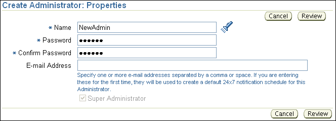

You can create Database Control administrative users who have enough privileges to administer Database Control itself, but lack the high-level database administration privileges of the SYS and SYSTEM users. This enables you to assign the minimum privileges required for other Database Control administrators to do their jobs, which is a best practice for database security. You can also create a Database Control administrative account for yourself, thus avoiding logging in as SYS or SYSTEM until you must perform database administration tasks.
Using the following procedure, you can assign Database Control administrative privileges to an existing database user or create a new Database Control administrative user. When you create a new Database Control administrative user, a user account is created for that user for the database. You must then decide which system privileges, object privileges, or roles to grant the user, if any, to perform database administration tasks.

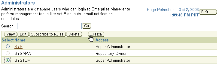

To create a Database Control administrative user:
On any Database Control page, at the top of the page, click Setup.
The Enterprise Manager Configuration page appears, showing the Overview of Setup page.
In the left navigation bar, click Administrators.
The Administrators page appears.
Click Create.
The Create Administrator: Properties page appears.
In the Name field, enter a new user name, or click the flashlight icon next to the field and select an existing database user.
In the Password and Confirm Password fields, enter a user password.
If you are creating a new user, assign a password. If you are selecting an existing user, enter any text in the password fields. The text is ignored, and the password for the user is not changed.
Enter one or more e-mail addresses for this administrator only if you plan to set up e-mail notifications for the database.
See "Setting Up Direct Alert Notification" for more information.
Click Review to view a page that summarizes the information that you entered.
Click Finish to create the new administrative user.
The Administrators page appears, showing the new administrator in the list.

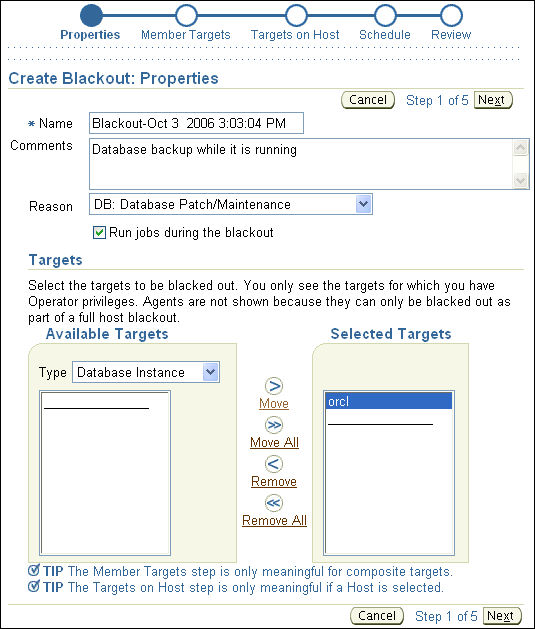

You can define one or more one-time or repeating blackout periods during which collection of database monitoring information and the sending of alerts are suspended.
In the left-hand pane, click Blackouts.
The Blackouts page appears.
Click Create to start the Create Blackout wizard.
The Create Blackout: Properties page appears.
(Optional) Replace the default blackout name with one of your choosing.
(Optional) In the Comments field, enter text that describes the purpose of the blackout.
In the Reason list, select the blackout reason that is most appropriate.
In the Available Targets section, in the Type list, select Database Instance.
The system identifier (SID) for your database instance appears in the Available Targets list.
In the Available Targets list, select your instance SID, and then click the Move icon.
You can also double-click the instance SID.The instance SID is moved from the Available Targets list to the Selected Targets list.
Click Next.

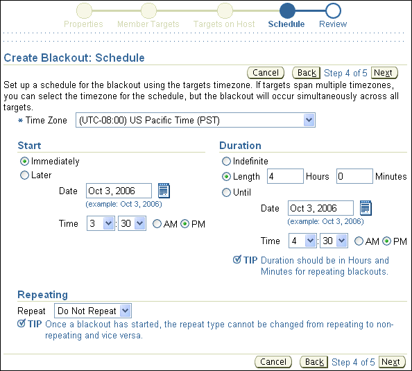

The Create Blackout Schedule page appears.
In the Start section, schedule the blackout either immediately or for a later date and time.
In the Duration section, indicate the duration of the blackout.
To repeat the blackout periodically, in the Repeating section, select a repeat frequency from the Repeat list.
Click Next.
The review page appears.
Review what you have entered. You can click Back to change a setting.
Click Finish.
The Confirmation page appears, with the new blackout period shown in the list.

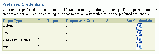

When you set preferred credentials, Database Control automatically fills in host computer and database login credentials for you at times when it usually prompts for these credentials, or when it is about to run a job that requires credentials.
To set preferred credentials for the database:
From any Database Control page, at the top of the page, click Preferences.
The Preferences page appears.
Click Preferred Credentials in the left-hand pane.
The Preferred Credentials page appears, showing a table of targets.
In the table row for the Database Instance, click the icon under Set Credentials.
The Preferred Credentials page appears.
Enter database credentials for Normal Username/Password and SYSDBA Username/Password, and enter host credentials for Host Username/Password. For example, you might typically connect as the user SYSTEM, use the SYS account for SYSDBA access, and use oracle for the host user name.
The host user may require certain host privileges to run background jobs such as database backups. For example, on UNIX and Linux, the host user must belong to the OSDBA group (typicallydba), and on Windows, the host user must be a member of the Administrators group and must be granted the Log on as batch job logon right. See your platform documentation for more information.Click Test to test your credentials.
A confirmation message is displayed if your credentials can be verified.
Click Apply to apply the changes.
