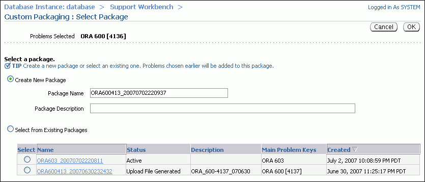

The Select Package page appears.
Do one of the following:
To create a new package, select the Create new package option, enter a package name and description, and then click OK.
To add the selected problems to an existing package, select the Select from existing packages option, select the package to update, and then click OK.

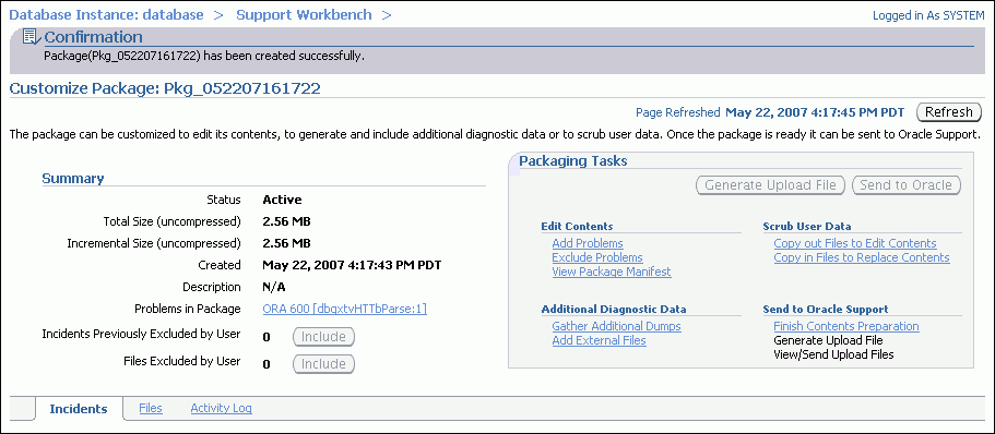

The Customize Package page appears. It displays the problems and incidents that are contained in the package, plus a selection of packaging tasks to choose from. You run these tasks against the new package or the updated existing package.
(Optional) In the Packaging Tasks section, click links to perform one or more packaging tasks. Or, use other controls on the Customize Package page and its subpages to manipulate the package. Return to the Customize Package page when you are finished.
See "Viewing and Modifying Incident Packages" for instructions for some of the most common packaging tasks.
In the Packaging Tasks section of the Customize Package page, under the heading Send to Oracle Support, click Finish Contents Preparation to finalize the package.

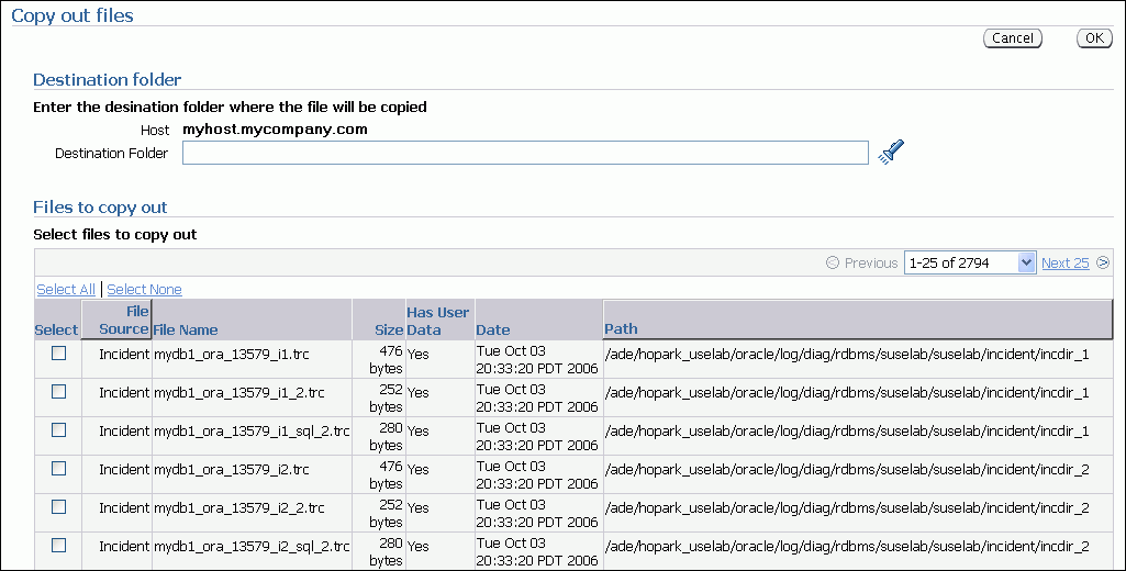

In the Packaging Tasks section, under the Scrub User Data heading, click Copy out Files to Edit contents.
The Copy Out Files page appears. It displays the name of the host to which you can copy files.
Do one of the following to specify a destination directory for the files:
Enter a directory path in the Destination Folder field.

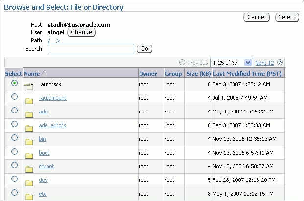

Click the flashlight icon next to the Destination Folder field, and then complete the following steps:
If prompted for host credentials, enter credentials for the host to which you want to copy out the files, and then click OK. (Select Save as Preferred Credential to avoid the prompt for credentials next time.)
In the Browse and Select File or Directory window, click directory links to move down the directory hierarchy, and click directory names next to the Path label to move up the directory hierarchy, until you see the desired destination directory.
To reduce the number of directories displayed in the list, enter search text in the Search field and click Go. All directories that have the search text anywhere in the directory name are displayed.
Select the desired destination directory, and then click Select.
The Browse and Select File or Directory window closes, and the path to the selected directory appears in the Destination Folder field of the Copy Out Files page.
Under Files to Copy Out, select the desired files, and then click OK.
If you do not see the desired files, they may be on another page. Click the Next link to view the next page. Continue clicking Next, or select from the list of file numbers (to the left of the Next link) until you see the desired files. You can then select the files and click OK.The Customize Package page returns, displaying a confirmation message that lists the files that were copied out.

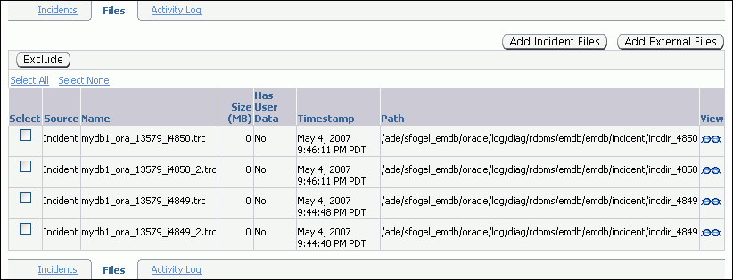

Click the Files link to view the Files subpage.
Figure 8-8 Files Subpage of Customize Package Page
From this page, you can add and remove files to and from the package.
The View list appears only for packages for which you already created a physical file. It enables you to view either incremental package contents or the full package contents. The default selection is incremental package contents. This default selection displays only those package files that were created or modified since the last time that a physical file was generated for the package.Click Add external files.

Click the flashlight icon next to the File Name field, and then complete the following steps:
If prompted for host credentials, enter credentials for the host on which the external file resides, and then click OK. (Select Save as Preferred Credential to avoid the prompt for credentials next time.)
In the Browse and Select File or Directory window, click directory links to move down the directory hierarchy, and click directory names next to the Path label to move up the directory hierarchy, until you see the desired file.
To reduce the number of files or directories displayed in the list, enter search text in the Search field and click Go. All files or directories that have the search text anywhere in the file name or directory name are displayed.
In the Select column, click to select the desired file, and then click Select.
The Browse and Select window closes, and the path to the selected file appears in the File Name field of the Add External File page.
A list of files in the package is displayed.
If you have not yet generated a physical file for this package, all package files are displayed in the list. If you have already generated a physical file, a View list appears above the files list. It enables you to choose between viewing only incremental package contents or the full package contents. The default selection is incremental package contents. This default selection displays only those package files that were created or modified since the last time that a physical file was generated for the package. Select Full package contents from the View list to view all package files.
Select the files to remove, and then click Exclude.
If you do not see the desired files, they may be on another page. Click the Next link to view the next page. Continue clicking Next, or select from the list of file numbers (to the left of the Next link) until you see the desired files. You can then select the files and click Remove.The Support Workbench maintains an activity log for each incident package. Most activities that you perform on a package, such as adding or removing files or creating a package zip file, are recorded in the log. You can also add your own notes to the log. This is especially useful if more than one database administrator is working with packages.
