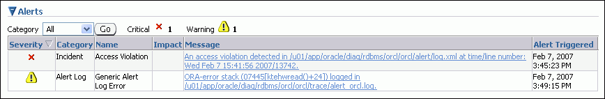

You begin the process of investigating problems (critical errors) by reviewing critical error alerts on the Database Home page.
To view critical error alerts:
Access the Database Home page in Enterprise Manager.
For Oracle Enterprise Manager Database Control, see Oracle Database 2 Day DBA for instructions. For Oracle Enterprise Manager Grid Control, go to the desired database target.
In the Alerts section, examine the table of alerts.
Critical error alerts are indicated by a red × in the Severity column, and the text "Incident" in the Category column.
You may have to click the hide/show icon next to the Alerts heading to display the alerts table.Figure 8-3 Alerts Table on the Database Home Page
In the Message column, click the message of the critical error alert that you want investigate.

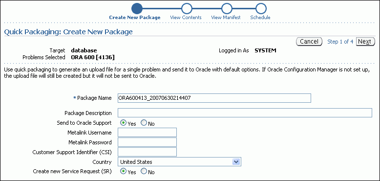

For this task, you use the quick packaging process of the Support Workbench to package and upload the diagnostic information for the problem to Oracle Support. Quick packaging has a minimum of steps, organized in a guided workflow (a wizard). The wizard assists you with creating an incident package (package) for a single problem, creating a zip file from the package, and uploading the file. With quick packaging, you are not able to edit or otherwise customize the diagnostic information that is uploaded. However, quick packaging is the more direct, straightforward method to package and upload diagnostic data.
If you want to edit or remove sensitive data from the diagnostic information, enclose additional user files (such as application configuration files or scripts), or perform other customizations before uploading, you must use the custom packaging process, which is a more manual process and has more steps. See "Creating, Editing, and Uploading Custom Incident Packages" for instructions. If you choose to follow those instructions instead of the instructions here in Task 5, continue with Task 6 – Track the Service Request and Implement Any Repairs when you are finished.
The Support Workbench uses Oracle Configuration Manager to upload the diagnostic data. If Oracle Configuration Manager is not installed or properly configured, the upload may fail. In this case, a message is displayed with a request that you upload the file to Oracle Support manually. You can upload manually with OracleMetaLink.For more information about Oracle Configuration Manager, see Oracle Configuration Manager Installation and Administration Guide.
To package and upload diagnostic data to Oracle Support:
On the Problem Details page, in the Investigate and Resolve section, click Quick Package.
The Create New Package page of the Quick Packaging wizard appears.
See "Viewing Problems with the Enterprise Manager Support Workbench" for instructions for returning to the Problem Details page if you are not already there.
Optionally enter a package name and description.
Fill in the remaining fields on the page. If you already created a service request for this problem, select No next to Create new Service Request (SR).
If you select Yes, the Quick Packaging wizard creates a draft service request on your behalf. You must later log in to OracleMetaLink and fill in the details of the service request.
Click Next, and then proceed with the remaining pages of the Quick Packaging wizard.
When the Quick Packaging wizard is complete, the package that it creates remains available in the Support Workbench. You can then modify it with custom packaging operations (such as adding new incidents) and reupload at a later time. See "Viewing and Modifying Incident Packages".
