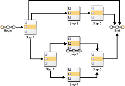

Figure 26-2 shows a chain with multiple branches. In this chain, rules could have been defined as follows:
If Step 1 completes successfully, start Step 2.
If Step 1 fails with error code 20100, start Step 3.
If Step 1 fails with any other error code, end the chain.
Additional rules would govern the running of steps 4, 5, 6, and 7.
