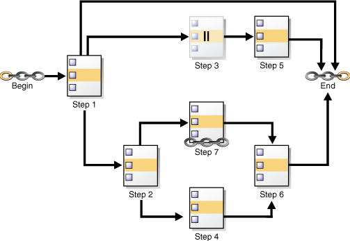

You can pause an entire chain or individual branches of a chain. You do so by setting the PAUSE attribute of one or more steps to TRUE with DBMS_SCHEDULER.ALTER_CHAIN or ALTER_RUNNING_CHAIN. Pausing chain steps enables you to suspend the running of the chain after those steps run.
When you pause a step, after the step runs, its state attribute changes to PAUSED, and its completed attribute remains FALSE. Steps that depend on the completion of the paused step are therefore not run. If you reset the PAUSE attribute to FALSE for a paused step, its state attribute is set to its completion state (SUCCEEDED, FAILED, or STOPPED), and steps that are awaiting the completion of the paused step can then run.
In Figure 27-3, Step 3 is paused. Until Step 3 is unpaused, Step 5 will not run. If you were to pause only Step 2, then Steps 4, 6, and 7 would not run. However Steps 1, 3, and 5 could run. In either case, you are suspending only one branch of the chain.
To pause an entire chain, you pause all steps of the chain. To unpause a chain, you unpause one, many, or all of the chain steps. With the chain in Figure 27-3, pausing Step 1 would also achieve the pausing of the entire chain after Step 1 runs.
