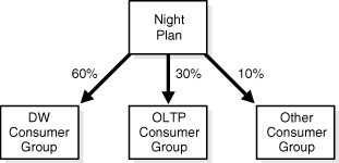

The following example can help to understand how resources are allocated for jobs. Assume that the active resource plan is called "Night Plan" and that there are three job classes: JC1
, which maps to consumer group DW
; JC2
, which maps to consumer group OLTP
; and JC3
, which maps to the default consumer group. Figure 27-4 offers a simple graphical illustration of this scenario.
This resource plan clearly gives priority to jobs that are part of job class JC1
. Consumer group DW
gets 60% of the resources, thus jobs that belong to job class JC1
will get 60% of the resources. Consumer group OLTP
has 30% of the resources, which implies that jobs in job class JC2
will get 30% of the resources. The consumer group Other
specifies that all other consumer groups will be getting 10% of the resources. This means that all jobs that belong in job class JC3
will share 10% of the resources and can get a maximum of 10% of the resources.
Note that resources that remain unused by one consumer group are available from use by the other consumer groups. So if the jobs in job class JC1 do not fully use the allocated 60%, the unused portion is available for use by jobs in classes JC2 and JC3. Note also that the Resource Manager does not begin to restrict resource usage at all until CPU usage reaches 100%. See Chapter 25, "Managing Resource Allocation with Oracle Database Resource Manager" for more information.
