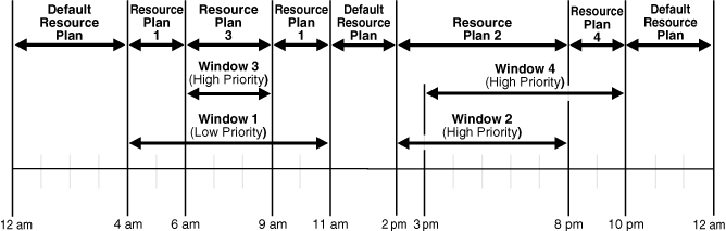

Figure 27-1 illustrates a typical example of how windows, resource plans, and priorities might be determined for a 24 hour schedule. In the following two examples, assume that Window1 has been associated with Resource Plan1, Window2 with Resource Plan2, and so on.
Figure 27-1 Windows and Resource Plans (Example 1)
In Figure 27-1, the following occurs:
From 12AM to 4AM
No windows are open, so a default resource plan is in effect.
From 4AM to 6AM
Window1 has been assigned a low priority, but it opens because there are no high priority windows. Therefore, Resource Plan 1 is in effect.
From 6AM to 9AM
Window3 will open because it has a higher priority than Window1, so Resource Plan 3 is in effect.
From 9AM to 11AM
Even though Window1 was closed at 6AM because of a higher priority window opening, at 9AM, this higher priority window is closed and Window1 still has two hours remaining on its original schedule. It will be reopened for these remaining two hours and resource plan will be in effect.
From 11AM to 2PM
A default resource plan is in effect because no windows are open.
From 2PM to 3PM
Window2 will open so Resource Plan 2 is in effect.
From 3PM to 8PM
Window4 is of the same priority as Window2, so it will not interrupt Window2. Therefore, Resource Plan 2 is in effect.
From 8PM to 10PM
Window4 will open so Resource Plan 4 is in effect.
From 10PM to 12AM

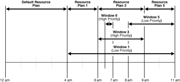

Figure 27-2 illustrates another example of how windows, resource plans, and priorities might be determined for a 24 hour schedule.
Figure 27-2 Windows and Resource Plans (Example 2)
In Figure 27-2, the following occurs:
From 12AM to 4AM
A default resource plan is in effect.
From 4AM to 6AM
Window1 has been assigned a low priority, but it opens because there are no high priority windows, so Resource Plan 1 is in effect.
From 6AM to 9AM
Window3 will open because it has a higher priority than Window1. Note that Window6 does not open because another high priority window is already in effect.
From 9AM to 11AM
At 9AM, Window5 or Window1 are the two possibilities. They both have low priorities, so the choice is made based on which has a greater percentage of its duration remaining. Window5 has a larger percentage of time remaining compared to the total duration than Window1. Even if Window1 were to extend to, say, 11:30AM, Window5 would have 2/3 * 100% of its duration remaining, while Window1 would have only 2.5/7 * 100%, which is smaller. Thus, Resource Plan 5 will be in effect.
