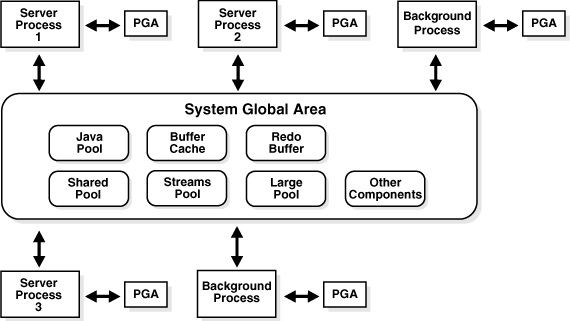

Figure 8-1 illustrates the relationships among these memory structures.
Figure 8-1 Oracle Database Memory Structures
The System Global Area (SGA) and the set of database processes constitute an Oracle Database instance. Oracle Database automatically allocates memory for an SGA when you start an instance, and the operating system reclaims the memory when you shut down the instance. Each instance has its own SGA.
The SGA is read/write. All database background processes and all server processes that execute on behalf of users can read information contained within the instance's SGA, and several processes write to the SGA during database operation.
Part of the SGA contains general information about the state of the database and the instance, which the background processes need to access. This is called the fixed SGA. No user data is stored here. The SGA also includes information communicated between processes, such as locking information.
If the system uses shared server architecture, then the request and response queues and some contents of the PGA are in the SGA.
As shown in Figure 8-1, the SGA consists of a number of memory components, which are pools of memory used to satisfy a particular class of memory allocation requests.
