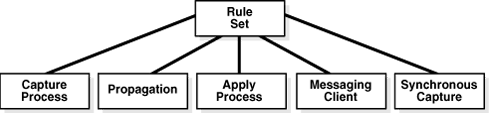

A single rule set can be used by multiple capture processes, synchronous captures, propagations, apply processes, and messaging clients within the same database. Also, a single rule set can be a positive rule set for one Oracle Streams client and a negative rule set for another Oracle Streams client.
Figure 6-1 illustrates how multiple clients of a rules engine can use one rule set.
Figure 6-1 One Rule Set Can Be Used by Multiple Clients of a Rules Engine

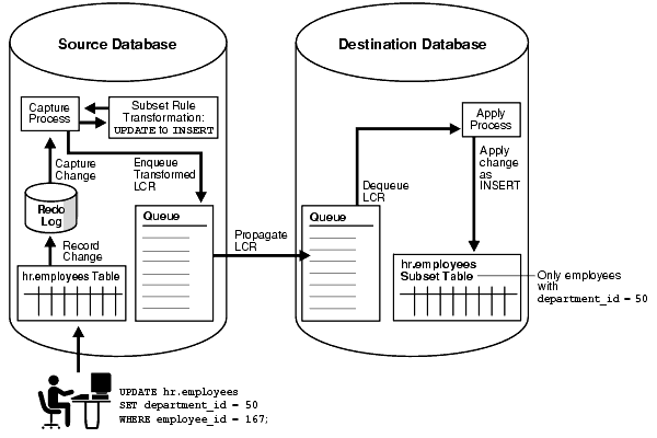

For example, suppose you use a subset rule to specify that a capture process or a synchronous capture captures changes to the hr.employees table where the employee's department_id is 50 using the following subset condition: department_id = 50. Assume that the table at the source database contains records for employees from all departments. If a DML operation changes an employee's department_id from 80 to 50, then the subset rule converts the update operation into an insert operation and captures the change. Therefore, a row LCR that contains an INSERT is enqueued into the queue. Figure 6-2 illustrates this example with a subset rule for a capture process.
Figure 6-2 Row Migration During Capture by a Capture Process
Similarly, if a captured update changes an employee's department_id from 50 to 20, then a capture process or synchronous capture with this subset rule converts the update operation into a DELETE operation.

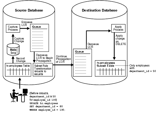

When a subset rule is in the rule set for a propagation, an update operation can be converted into an insert or delete operation when a row LCR is propagated.
For example, suppose you use a subset rule to specify that a propagation propagates changes to the hr.employees table where the employee's department_id is 50 using the following subset condition: department_id = 50. If the source queue for the propagation contains a row LCR with an update operation on the hr.employees table that changes an employee's department_id from 50 to 80, then the propagation with the subset rule converts the update operation into a delete operation and propagates the row LCR to the destination queue. Therefore, a row LCR that contains a DELETE is enqueued into the destination queue. Figure 6-3 illustrates this example.
Figure 6-3 Row Migration During Propagation
Similarly, if a captured update changes an employee's department_id from 80 to 50, then a propagation with this subset rule converts the update operation into an INSERT operation.

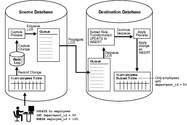

When a subset rule is in the rule set for an apply process, an update operation can be converted into an insert or delete operation when a row LCR is applied.
For example, suppose you use a subset rule to specify that an apply process applies changes to the hr.employees table where the employee's department_id is 50 using the following subset condition: department_id = 50. Assume that the table at the destination database is a subset table that only contains records for employees whose department_id is 50. If a source database captures a change to an employee that changes the employee's department_id from 80 to 50, then the apply process with the subset rule at a destination database applies this change by converting the update operation into an insert operation. This conversion is needed because the employee's row does not exist in the destination table. Figure 6-4 illustrates this example.
Similarly, if a captured update changes an employee's department_id from 50 to 20, then an apply process with this subset rule converts the update operation into a DELETE operation.

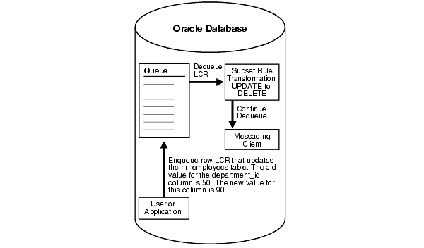

When a subset rule is in the rule set for a messaging client, an update operation can be converted into an insert or delete operation when a row LCR is dequeued.
For example, suppose you use a subset rule to specify that a messaging client dequeues changes to the hr.employees table when the employee's department_id is 50 using the following subset condition: department_id = 50. If the queue for a messaging client contains a persistent row LCR with an update operation on the hr.employees table that changes an employee's department_id from 50 to 90, then when a user or application invokes a messaging client with this subset rule, the messaging client converts the update operation into a delete operation and dequeues the row LCR. Therefore, a row LCR that contains a DELETE is dequeued. The messaging client can process this row LCR in any customized way. For example, it can send the row LCR to a custom application. Figure 6-5 illustrates this example.
Figure 6-5 Row Migration During Dequeue by a Messaging Client
Similarly, if a persistent row LCR contains an update that changes an employee's department_id from 90 to 50, then a messaging client with this subset rule converts the UPDATE operation into an INSERT operation during dequeue.
