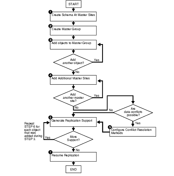

After you have set up your master sites, you are ready to build a master group. As illustrated in Figure 3-2, you must follow a specific sequence to successfully build a replication environment.

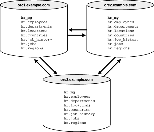

"Configuring the Replication Sites" for information about setting up master sitesIn this chapter, you create the hr_repg master group and replicate the objects illustrated in Figure 3-1.
Figure 3-1 Replicate the Tables in the hr Schema Between All Sites
In order for the script in this chapter to work as designed, it is assumed that the hr schema exists at orc1.example.com, orc2.example.com, and orc3.example.com. The hr schema includes the following database objects:
