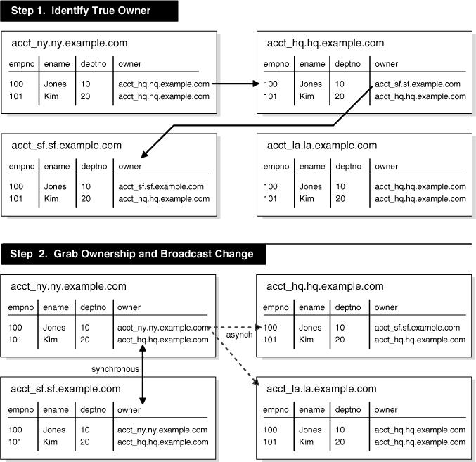

One method to avoid update conflicts is to implement a synchronous replication environment, though this solution requires large network resource.
The other solution is to use the Oracle conflict resolution methods to deal with update conflicts that can occur when the same row receives two or more updates.

Token passing uses a more generalized approach to meeting these criteria. To implement token passing, instead of the "identifier" columns, your replicated tables must have owner and epoch columns. The owner column stores the global database name of the site currently believed to own the row.
Once you have designed a token passing mechanism, you can use it to implement a variety of forms of dynamic partitioning of data ownership, including workflow.
You should design your application to implement token passing for you automatically. You should not allow the owner or epoch columns to be updated outside this application.
Whenever you attempt to update a row, your application should:
Locate the current owner of the row.
Establish ownership of the row.
Lock the row to prevent updates while ownership is changing.
Perform the update.
Oracle releases the lock when you commit your transaction.
For example, Figure 6-1 illustrates how ownership of employee 100 passes from the acct_sf database to the acct_ny database.
To obtain ownership, the acct_ny database uses a simple recursive algorithm to locate the owner of the row. The sample code for this algorithm is shown as follows:
-- Sample code for locating the token owner.
-- This is for a table TABLE_NAME with primary key PK.
-- Initial call should initialize loc_epoch to 0 and loc_owner
-- to the local global name.
get_owner(PK IN primary_key_type, loc_epoch IN OUT NUMBER,
          loc_owner IN OUT VARCHAR2)
  -- use dynamic SQL (dbms_sql) to perform a select similar to
  -- the following:
  SELECT owner, epoch into rmt_owner, rmt_epoch
     FROM TABLE_NAME@loc_owner
     WHERE primary_key = PK FOR UPDATE;
  IF rmt_owner = loc_owner AND rmt_epoch >= loc_epoch THEN
   loc_owner := rmt_owner;
   loc_epoch := rmt_epoch;
   RETURN;
  ELSIF rmt_epoch >= loc_epoch THEN
   get_owner(PK, rmt_epoch, rmt_owner);
   RETURN;
  ELSE
   raise_application_error(-20000, 'No owner for row');
  END IF;}
After locating the owner of the row, the acct_ny site gets ownership from the acct_sf site by completing the following steps:
Lock the row at the sf site to prevent any changes from occurring while ownership is being exchanged.
This operation ensures that only one site considers itself to be the owner at all times. The update at the sf site should not be replicated using DBMS_REPUTIL.REPLICATION_OFF. The replicated change of ownership at the ny site in Step 4 will ultimately be propagated to all other sites in the replication environment, including the sf site, where it will have no effect.
Synchronously update the owner information at both the sf and ny sites.
Update the row information at the new owner site, ny, with the information from the current owner site, sf.
This data is guaranteed to be the most recent. This time, the change at the ny site should not be replicated. Any queued changes to this data at the sf site are propagated to all other sites in the usual manner. When the sf change is propagated to ny, it is ignored because of the values of the epoch numbers, as described in the next bullet point.
Update the epoch number at the new owner site to be one greater than the value at the previous site.
Perform this update at the new owner only, and then asynchronously propagate this update to the other master sites. Incrementing the epoch number at the new owner site prevents ordering conflicts.
When the sf changes (that were in the deferred queue in Step 2 preceding) are ultimately propagated to the ny site, the ny site ignores them because they have a lower epoch number than the epoch number at the ny site for the same data.
As another example, suppose the hq site received the sf changes after receiving the ny changes, the hq site would ignore the sf changes because the changes applied from the ny site would have the greater epoch number.
You should design your application to implement this method of token passing for you automatically whenever you perform an update. You should not allow the owner or epoch columns to be updated outside this application. The lock that you grab when you change ownership is released when you apply your actual update. The changed information, along with the updated owner and epoch information, are asynchronously propagated to the other sites in the usual manner.
