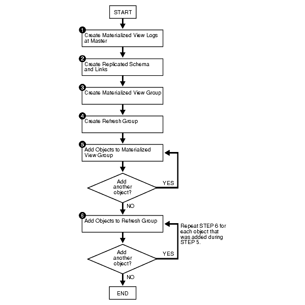

Complete the following steps to create these two materialized view groups.
If you are viewing this document online, then you can copy the text from the "BEGINNING OF SCRIPT" line after this note to the "END OF SCRIPT" line into a text editor and then edit the text to create a script for your environment./************************* BEGINNING OF SCRIPT ******************************
Complete the following steps to create the hr_repg materialized view group at the mv1.example.com materialized view site. This materialized view group is based on the hr_repg master group at the orc1.example.com master site.
Step 1 Create materialized view logs at the master site.
If you want one of your master sites to support a materialized view site, then you must create materialized view logs for each master table that is replicated to a materialized view. Recall from Figure 2-1 that orc1.example.com serves as the target master site for the mv1.example.com materialized view site. The required materialized view logs must be created at orc1.example.com.

Step 3 Create the materialized view group.
The following procedures must be executed by the materialized view administrator at the remote materialized view site.
*/ CONNECT mviewadmin@mv1.example.com /*
The master group that you specify in the gname parameter must match the name of the master group that you are replicating at the target master site.
*/ BEGIN DBMS_REPCAT.CREATE_MVIEW_REPGROUP ( gname => 'hr_repg', master => 'orc1.example.com', propagation_mode => 'ASYNCHRONOUS'); END; / /*
Step 4 Create the refresh group.
All materialized views that are added to a particular refresh group are refreshed at the same time. This ensures transactional consistency between the related materialized views in the refresh group.
*/ BEGIN DBMS_REFRESH.MAKE ( name => 'mviewadmin.hr_refg', list => '', next_date => SYSDATE, interval => 'SYSDATE + 1/24', implicit_destroy => FALSE, rollback_seg => '', push_deferred_rpc => TRUE, refresh_after_errors => FALSE); END; / /*
Step 5 Add objects to the materialized view group.
Create the materialized views based on the master tables.
Whenever you create a materialized view, always specify the schema name of the table owner in the query for the materialized view. In the following examples, hr is specified as the owner of the table in each query.
*/ CREATE MATERIALIZED VIEW hr.countries_mv1 REFRESH FAST WITH PRIMARY KEY FOR UPDATE AS SELECT * FROM hr.countries@orc1.example.com; CREATE MATERIALIZED VIEW hr.departments_mv1 REFRESH FAST WITH PRIMARY KEY FOR UPDATE AS SELECT * FROM hr.departments@orc1.example.com; CREATE MATERIALIZED VIEW hr.employees_mv1 REFRESH FAST WITH PRIMARY KEY FOR UPDATE AS SELECT * FROM hr.employees@orc1.example.com; CREATE MATERIALIZED VIEW hr.jobs_mv1 REFRESH FAST WITH PRIMARY KEY FOR UPDATE AS SELECT * FROM hr.jobs@orc1.example.com; CREATE MATERIALIZED VIEW hr.job_history_mv1 REFRESH FAST WITH PRIMARY KEY FOR UPDATE AS SELECT * FROM hr.job_history@orc1.example.com; CREATE MATERIALIZED VIEW hr.locations_mv1 REFRESH FAST WITH PRIMARY KEY FOR UPDATE AS SELECT * FROM hr.locations@orc1.example.com; CREATE MATERIALIZED VIEW hr.regions_mv1 REFRESH FAST WITH PRIMARY KEY FOR UPDATE AS SELECT * FROM hr.regions@orc1.example.com; /*
Add the objects to the materialized view group.
*/ BEGIN DBMS_REPCAT.CREATE_MVIEW_REPOBJECT ( gname => 'hr_repg', sname => 'hr', oname => 'countries_mv1', type => 'SNAPSHOT', min_communication => TRUE); END; / BEGIN DBMS_REPCAT.CREATE_MVIEW_REPOBJECT ( gname => 'hr_repg', sname => 'hr', oname => 'departments_mv1', type => 'SNAPSHOT', min_communication => TRUE); END; / BEGIN DBMS_REPCAT.CREATE_MVIEW_REPOBJECT ( gname => 'hr_repg', sname => 'hr', oname => 'employees_mv1', type => 'SNAPSHOT', min_communication => TRUE); END; / BEGIN DBMS_REPCAT.CREATE_MVIEW_REPOBJECT ( gname => 'hr_repg', sname => 'hr', oname => 'jobs_mv1', type => 'SNAPSHOT', min_communication => TRUE); END; / BEGIN DBMS_REPCAT.CREATE_MVIEW_REPOBJECT ( gname => 'hr_repg', sname => 'hr', oname => 'job_history_mv1', type => 'SNAPSHOT', min_communication => TRUE); END; / BEGIN DBMS_REPCAT.CREATE_MVIEW_REPOBJECT ( gname => 'hr_repg', sname => 'hr', oname => 'locations_mv1', type => 'SNAPSHOT', min_communication => TRUE); END; / BEGIN DBMS_REPCAT.CREATE_MVIEW_REPOBJECT ( gname => 'hr_repg', sname => 'hr', oname => 'regions_mv1', type => 'SNAPSHOT', min_communication => TRUE); END; / /*
Step 6 Add objects to the refresh group.
All of the materialized view group objects that you add to the refresh group are refreshed at the same time to preserve referential integrity between related materialized views.
*/ BEGIN DBMS_REFRESH.ADD ( name => 'mviewadmin.hr_refg', list => 'hr.countries_mv1', lax => TRUE); END; / BEGIN DBMS_REFRESH.ADD ( name => 'mviewadmin.hr_refg', list => 'hr.departments_mv1', lax => TRUE); END; / BEGIN DBMS_REFRESH.ADD ( name => 'mviewadmin.hr_refg', list => 'hr.employees_mv1', lax => TRUE); END; / BEGIN DBMS_REFRESH.ADD ( name => 'mviewadmin.hr_refg', list => 'hr.jobs_mv1', lax => TRUE); END; / BEGIN DBMS_REFRESH.ADD ( name => 'mviewadmin.hr_refg', list => 'hr.job_history_mv1', lax => TRUE); END; / BEGIN DBMS_REFRESH.ADD ( name => 'mviewadmin.hr_refg', list => 'hr.locations_mv1', lax => TRUE); END; / BEGIN DBMS_REFRESH.ADD ( name => 'mviewadmin.hr_refg', list => 'hr.regions_mv1', lax => TRUE); END; / /*
