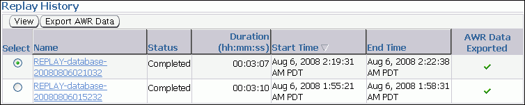

Under Replay History, select the replay for which you want to generate a workload replay report and click View.
The View Workload Replay page appears.
Click View Workload Replay Report.
