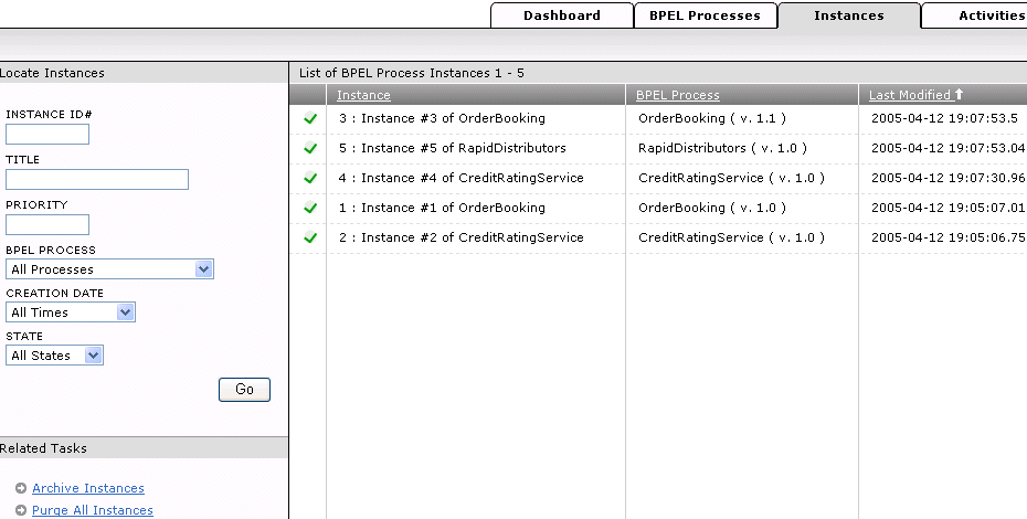

The Instances tab displays BPEL process instances. Figure 13-6 shows the Instances tab.
Figure 13-6 Oracle BPEL Control: The Instances Tab
Use the Instances tab to monitor BPEL processes.
