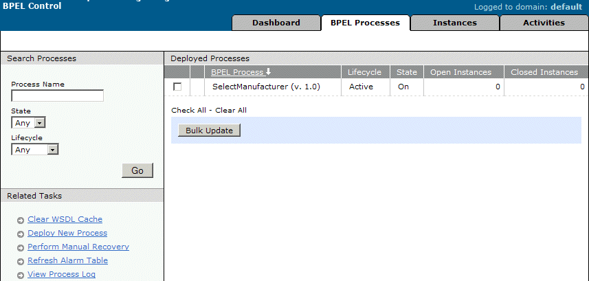

The BPEL Processes tab displays process life cycles and states, including the version numbers of BPEL processes that are currently active. An asterisk identifies the default process.
Figure 13-4 shows the BPEL Processes tab for the SelectManufacturer process in the SOA Order Booking application.
Figure 13-4 Oracle BPEL Control: The BPEL Processes Tab for the SelectManufacturer Process
Use the following links on the BPEL Processes tab to do related tasks:
Clear WSDL Cache: Clears the cache for all WSDLs of the selected domain
Deploy New Process: Deploys BPEL processes from Oracle BPEL Control instead of using Oracle JDeveloper
Perform Manual Recovery: Performs a manual recovery of messages. For example, if you are using the file adapter and your system server crashes while inbound messages are being processed, you can manually recovery undelivered messages when the server is restarted. If a file has ten messages and the server crashes after three messages have been processed, then the fourth message is not delivered. When the server restarts and begins processing with message five (the offset of the last successfully rejected message), you can manually recover the fourth message.
Refresh Alarm Table: Refreshes the alarm table for the selected domain. This registers all pending wait/onAlarm activities with the system.
View Process Log: Shows the events of all BPEL processes in the selected domain (for example, when a process was compiled, undeployed, or marked as the default instance)

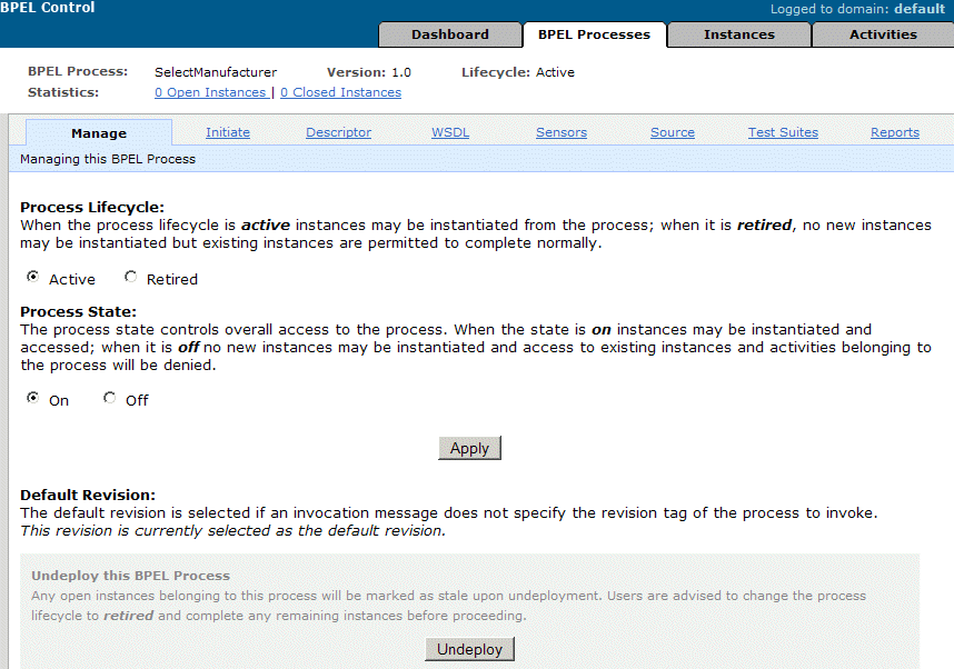

Figure 13-5 shows the BPEL Processes tab after you select the SelectManufacturer process.
Figure 13-5 Oracle BPEL Control: The Manage Page of the BPEL Processes Tab
Use the following links on the BPEL Processes tab to manage the SelectManufacturer process:
Manage: (Displayed in the figure.) For each BPEL process, Oracle BPEL Control provides the following status indicators.
Process Life Cycle: A process life cycle can be active or retired. If the process life cycle is retired, you cannot create a new instance.
Process State: A process state can be on or off. If the process state is off, you cannot access instances or create new ones.
Default Revision: The designated process and revision that is instantiated when a new request comes in. There is only one default process, identified by an asterisk. If you retire a default process, the default does not change to another process. The retired process remains the default. You must explicitly select a new default process.
