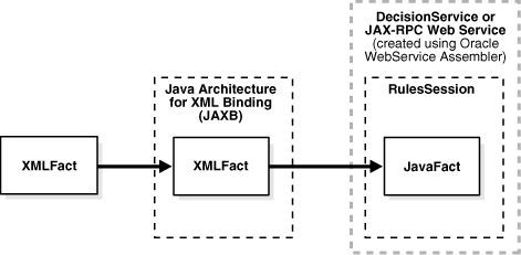

The Oracle Rules Engine implementation is itself 100% Java, and at the lowest level always operates on Java facts. To work with XML, the Rule Author uses JAXB to compile XSD into Java objects. At runtime, all Rules Engine facts are Java facts. As a developer, you can choose to:
Model facts with XML, and have them compiled into Java seamlessly, behind the scenes, or
Model facts using Java and expose them as a web service, where the Java-to-XML marshaling is managed by the web services stack.
In Figure 8-1, XMLFacts are bound to JavaFacts using JAXB. It is always JavaFacts that execute in the underlying RulesSession. You can interface to the RulesSession through the DecisionService (by the XMLFact route), or, if integration at a lower level is necessary, then you can wrap the RulesSession/JavaFacts with a JAX-RPC WebService). The preferred method is to model using XMLFacts and use the DecisionService.
Figure 8-1 Rules Integration with RulesSession or a Web Service
