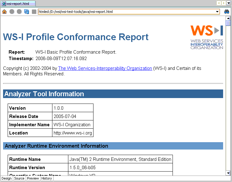

Figure 5-19 shows part of the WS-I report of the Credit Service in the SOA Order Booking application.
Figure 5-19 Example of a WS-I Profile Conformance Report
Description of Figure 5-19 follows
Description of "Figure 5-19 Example of a WS-I Profile Conformance Report"

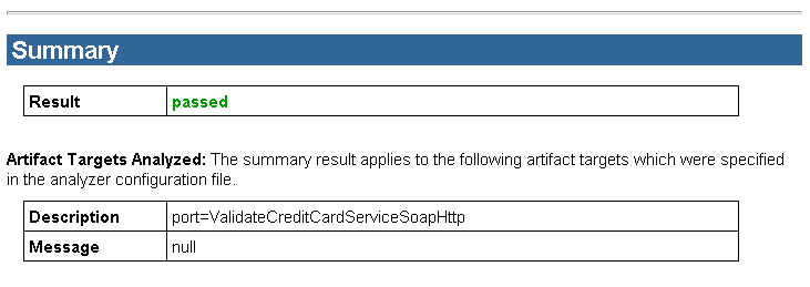

The report produced is wsi-report.html, and it is located in the directory where the WS-I test tools are located. In this case, the report shows that the CreditService.wsdl is conformant and can be used for contract driven development of Credit Service in the SOA Order Booking application. See Figure 5-20.
Figure 5-20 Summary Section of the WS-I report of CreditService.wsdl
Description of Figure 5-20 follows
Description of "Figure 5-20 Summary Section of the WS-I report of CreditService.wsdl"
