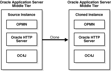

Figure 9-1 shows cloning a J2EE Server and Web Server middle tier that is not connected to Oracle Identity Management.
Figure 9-1 Cloning a J2EE Server and Web Server Middle Tier
Description of Figure 9-1 follows
Description of "Figure 9-1 Cloning a J2EE Server and Web Server Middle Tier"
The cloning process works by copying all files from the source Oracle home to the destination Oracle home. Hence, any files used by the source instance that are located outside the source Oracle home's directory structure are not copied to the destination location.
After the files are copied, a set of scripts is used to update the information in key configuration files. For example, all references to the host name and the Oracle home in httpd.conf are updated to their new values.
Any applications deployed in the source instance are also copied to the cloned instance and automatically deployed, provided they are located in the source Oracle home's directory structure.
