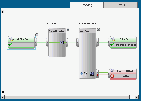

When an error occurs during process a message instance, it is indicated by a red service icon in the Tracking tab of the Oracle ESB Control Instances view.
An error condition in the Tracking tab appears similar to Figure 10-1.
Figure 10-1 Instances View – Tracking Tab

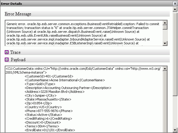

You can view the error message, trace, and payload details by clicking on the Error Details icon in the Message column on the Errors tab, shown in Figure 10-3.
Figure 10-2 is an example of the Error Details dialog.

Click the Error Details icon under the Message column to view error message, trace, and payload details about the error condition in the Errors Detail dialog.
Click OK to close the Errors Detail dialog after reviewing the error message details.

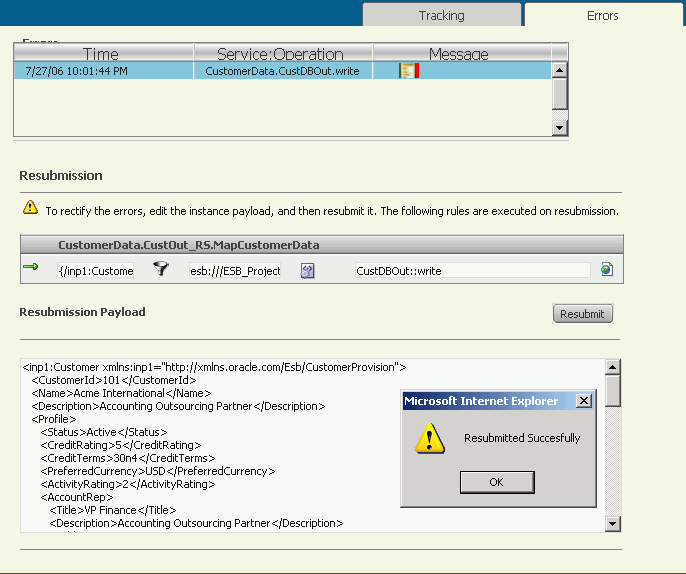

Correct the error condition, then click Resubmit in the Error tab.
For example, edit the message payload in the Resubmission Payload window if is incorrect and then click Resubmit.
Figure 10-3 is an example of the resubmitted message instance.
