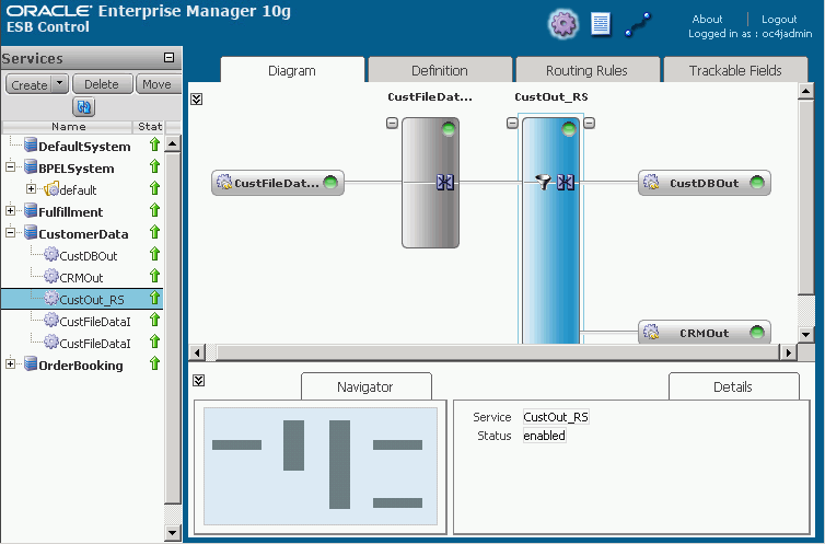

Figure 3-1 shows the Oracle ESB Control with the schematic that is generated when you complete the tutorial documented in the Oracle Enterprise Service Bus Quick Start Guide. On the left side of the Oracle ESB Control is a navigation tree that enables you to select a system, group, or service; on the right side of the Oracle ESB Control are tabbed pages that display, and enable you to change, properties for an object selected in the navigation tree.
Figure 3-1 Oracle ESB Control - Services View Diagram Tab
Description of Figure 3-1 follows
Description of "Figure 3-1 Oracle ESB Control - Services View Diagram Tab"

As shown in Figure 3-1, the Services view is divided into two main regions: a services panel on the right and tabbed pages on the left. The services panel provides a navigation tree of ESB systems and the service groups and services within each, and buttons to create, delete, and move objects within the navigation tree.
The services panel appears on the left side of the Oracle ESB Control. It provides buttons for creating and deleting ESB systems, groups, and services and a navigation tree to present these items (and their current status) after they have been created.
The tabbed panel presents details about services selected in the navigation tree. Depending on the service selected, the following tabs are available:
  • On the Diagram tab, view the relationship of the selected service to other objects within the ESB system. Oracle Enterprise Service Bus creates this diagram automatically, based on the definitions you specify for each service.
    The selected service is represented in blue within the diagram, whereas the other services are represented in gray. In the diagram, the following conventions are used:
    • Adapter services are represented by rectangles with a long horizontal plane.
    • Routing services are represented by rectangles with long vertical planes.
    • Communication between services is represented by the lines between the services.
    • A routing service filter expression is indicated by a funnel.
    • A transformation is indicated by two rectangles with an X overlay.
    The navigator tab indicates which area of the diagram is currently being displayed in relation to the entire diagram. This is useful for large diagrams that extend beyond the area that can be presented in the diagram region. When you move the scroll bar in the diagram region, notice that the blue window in the navigator scrolls also, to highlight the portion of the diagram that is currently visible.
    The detail tab provides the name of the selected service and the status of the selected service in the Diagram tab. Overlay metrics enable you to select which metrics, if any, you want to be superimposed on the diagram.
    See "Creating, Viewing, and Updating Organizational Units for Services".

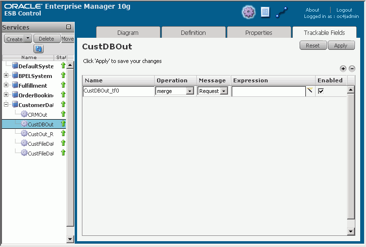

  • On the Trackable Fields tab, define trackable fields for the selected service. See "Defining and Managing Tracking Fields".

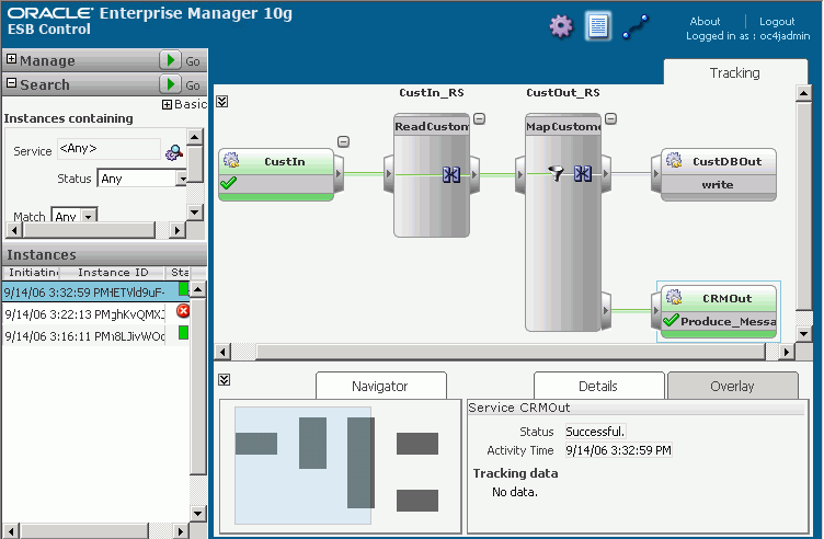

When you select a service for a message from the Instances panel, the message instance's path through the enterprise service bus is presented in the Tracking tab diagram (and the selected service is enclosed by dotted lines in the diagram). Within the diagram, endpoints that successfully processed the message are represented in green, services where an error occurred are represented in red, and services that processed the message successfully, but were rolled back due to an error are represented in yellow. Endpoints that were not invoked in the processing of the message are represented in gray.
Figure 3-2 shows that the CRM adapter service (CRMOut) was successfully invoked and that the database adapter service (CustDBOut) was not invoked because a filter expression excluded the message from delivery to the database adapter service.
Figure 3-2 Oracle ESB Control - Instances View Tracking Tab
Description of Figure 3-2 follows
Description of "Figure 3-2 Oracle ESB Control - Instances View Tracking Tab"

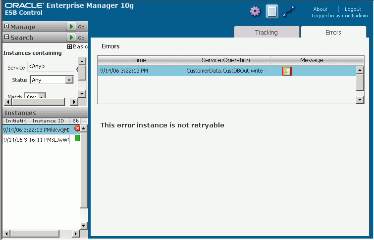

If you select a service where an error occurred for the message, an Error tab is presented, as shown in Figure 3-3. The Errors tab contains an error table that lists the time, service:operation, and message associated with each error. Click the Error Details icon in the Message column to view the error message and the stack trace.
Figure 3-3 Oracle ESB Control - Instances View Errors Tab
Description of Figure 3-3 follows
Description of "Figure 3-3 Oracle ESB Control - Instances View Errors Tab"
For more information message tracking, see Chapter 9, "Tracking Message Instances Across the Enterprise Service Bus". For more information about error handling, see Chapter 10, "Error Handling".

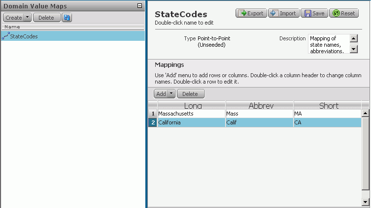

Oracle ESB Control Maps View
The Maps view enables you to create, update, and delete domain-value maps, as well as view, export, and import existing domain-value maps.
Applications that you want to integrate using Oracle Enterprise Service Bus likely use different values to represent the same information. For example, one application may represent the state of Massachusetts as MA whereas another application might represent it as Massachusetts or Mass. A domain-value map enables you to associate values from one application to values from another. Each domain-value map typically holds a specific category of value mappings among multiple applications. For example, one domain-value map might hold mappings for country codes and another might hold mappings for units of measurement.
Figure 3-4 shows a sample domain-value map in the Maps view of Oracle ESB Control. The names of the saved maps are listed in the left panel of the page and right panel shows the details about the mappings in a specific map. In this sample map, mappings are set up for the long, abbreviated, and short name of states in the columns of the map.
Figure 3-4 Oracle ESB Control - Maps View with Sample Domain-Value Map
Description of Figure 3-4 follows
Description of "Figure 3-4 Oracle ESB Control - Maps View with Sample Domain-Value Map"
For more information domain-value maps, see Chapter 7, "Domain-Value Maps".

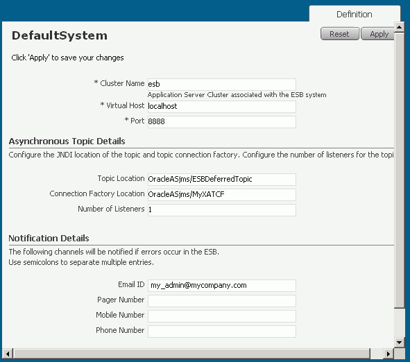

Viewing or Modifying an Existing ESB System Definition
To view or modify the definition for a previously created ESB system, follow these steps:
  1. Click Services if the Services view is not currently displayed.
  2. In the Services panel, click the name of the ESB system of interest.
    The Definition tab displays similar to Figure 3-6.
    Figure 3-6 ESB System – Definition Tab
    Description of Figure 3-6 follows
    Description of "Figure 3-6 ESB System – Definition Tab"
  3. Review the properties presented on the Definition tab and described in Table 3-2.
  4. Make any desired updates. All properties can be updated except the Asynchronous Topic and the Error Topic.
  5. If you are satisfied with your changes, click Apply; otherwise, click Reset to return the properties to the settings that were presented when you opened the page.

Defining and Updating Trackable Fields
To define or update trackable fields, follow these steps:
  1. At the top of the Oracle ESB Control, click the Services button if the Services view is not currently displaying.
  2. In the Services panel, select the service for which you want to set trackable fields.
  3. Click the Trackable Fields tab.
  4. Click the plus (+) button to add a row to the table and enable editing for that row; double-click an existing row to update that row.
    Figure 3-7 Services View – Trackable Fields Tab
    Description of Figure 3-7 follows
    Description of "Figure 3-7 Services View – Trackable Fields Tab"
  5. Enter values in the row, as follows:
    1. In the Name field, enter a name for the trackable field that is unique across the ESB system in which the service exists.
    2. In the Operation field, select from the list the operation on which you want to define the trackable field.
    3. In the Message field, select from the list the type of message you want to track for this service. Possible values are: Request, Response, Fault.
    4. In the Expression field, enter the XPath expression that identifies the field that you want to track.
      Click the wand icon to the right of the Expression field to open the Expression Builder, which assists you in building the XPath expression. For information about the Expression Builder, see "Filter Expression Overview".
    5. In the Enabled field, click the check box to enabled the specified trackable field. Deselect the check box to disable it.
      If you disable the trackable field, the trackable field information is not logged and is not available in the Instances view of the Oracle ESB Control.
    6. Click OK when finished.
  6. Click Apply to save the changes you have made; click Reset to return to the values that were presented before you began editing fields.

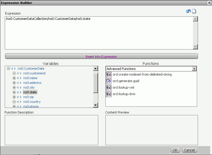

Using the Expression Builder to Specify a Trackable Field Expression
  5. Click the plus \ icon to launch the Expression Builder.
  6. Select and expand the variables tree to the selected variable.
  7. Click Insert into Expression.
    Figure 3-8 Trackable Fields - Expression Builder
    Description of Figure 3-8 follows
    Description of "Figure 3-8 Trackable Fields - Expression Builder"
  8. Click OK.
  9. Click Apply to save the changes you have made; click Reset to return to the values that were presented before you began editing fields.
