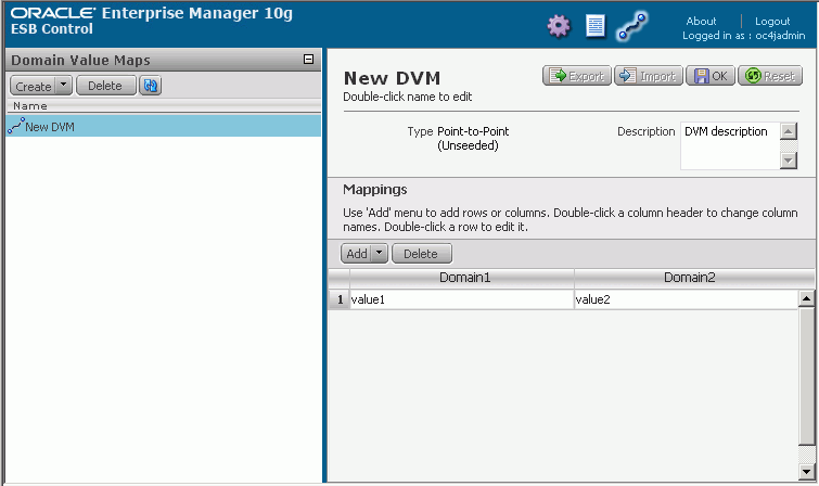

The Oracle ESB Control refreshes and appears similar to Figure 7-1.
Figure 7-1 Oracle ESB Control Map View – Create New Map

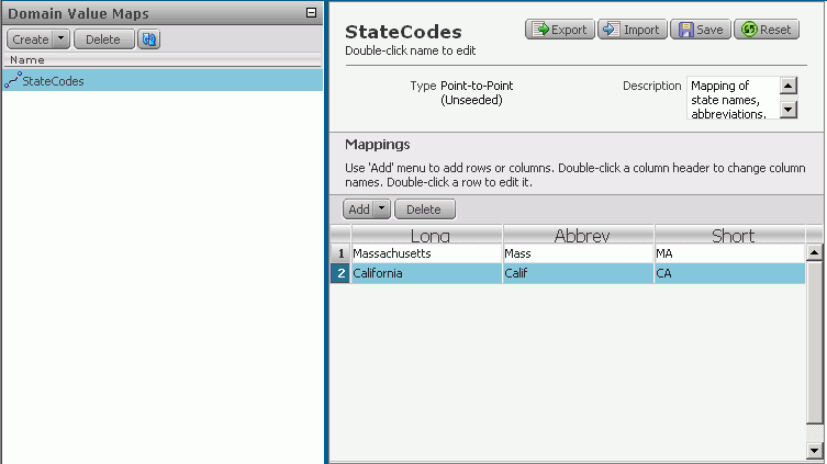

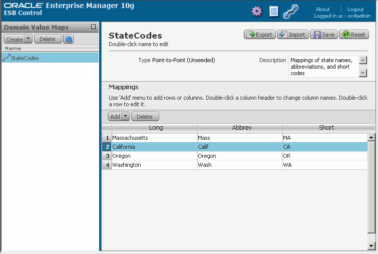

Figure 7-2, shows an example of a domain-value map.

Figure 7-2 Domain-Value Map – Rows Created

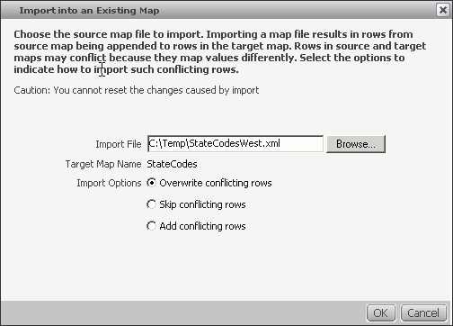

The Import into an Existing Map dialog box opens.
In the Import File field, enter the path for the file from which you want to import rows.
Select one of the Import Options, which are described in section.
Figure 7-5 Oracle ESB Control Map View – Import into an Existing Map Dialog
Click OK.
The Oracle ESB Control refreshes the view and presents the imported rows. The domain-value map is saved to the ESB repository and it can be used when creating a transformation in Oracle JDeveloper, as described in "Using a Domain-Value Map in a Transformation".
Figure 7-6 Oracle ESB Control Map View – Updated Map After Importing Rows

You can move a selected column one position at a time, as described in the following list. This options is provided to support user preferences, it has no effect on how the domain-value map is applied at run-time.
Follow these steps:
Click the column that you want to move to the right.
Small arrows appears in the column heading, as shown in Figure 7-7.
Figure 7-7 Arrows for Rearranging Columns In Domain-Value Maps
Click the arrow in the direction you want to move the selected column.
Repeat steps 1 and 2 until all the columns appear in the desired order.
As you are creating or editing a domain-value map, it is best to save it frequently, especially if you are adding numerous rows manually.
Suppose, for example, you save a domain value map, and then add multiple additional rows. You realize that entered many incorrect rows since the last time you saved the domain-value map. You can reset the domain-value map to its last saved state by clicking the Reset button. Any changes made after the last time you clicked the Save button are removed.
If the values you add to the cells in a domain value map are wider than the default cell width, you might want to resize the columns, by following these steps:
Place the cursor on the boundary between two column headers so that the cursor shape changes to a double-headed arrow; this is the resize cursor.
Left-click the double-headed arrow – a dotted line appears at the column boundary.
Drag the dotted line left or right, as desired, to indicate the new placement of the boundary.
Release the mouse button.

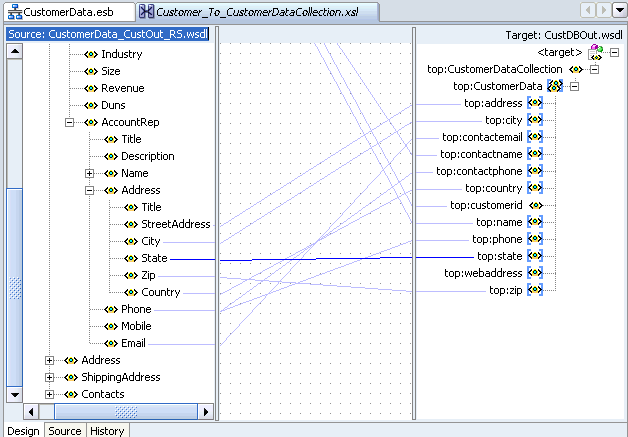

Open an ESB project in Oracle JDeveloper.
For example, open the CustomerData project to display the routing service icons in the Design tab. See Figure 2-2 for a sample screenshot of the CustomerData project.
Select a routing icon in the Design tab and then double-click the transformation XSL icon to display the Data Mapper window.
For example, select CustOut_RS in the Design tab and double click the XSL icon.
Expand the trees in the Source and Target panes in the Data Mapper window.
Drag and drop the source element to the target element.
For example, State to top:state as shown in Figure 7-8.
Figure 7-8 Data Mapper – Source to Target Map

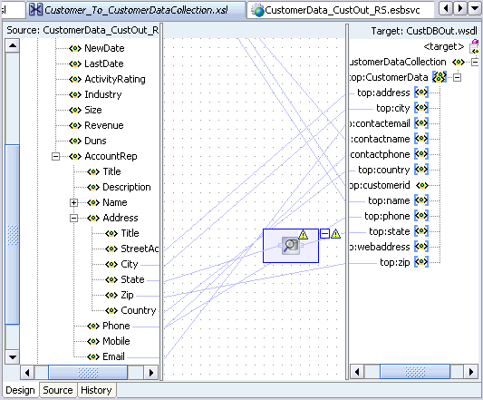

Drag and drop lookup-dvm onto the line that connects the source object to the target object.
A lookup-dvm icon appears on the connecting line, as shown in Figure 7-10. The yellow warning triangles indicate that the definition of the lookup-dvm function is not complete.
Figure 7-10 Data Mapper – look-up dvm Function Added

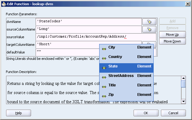

Double-click the look-up dvm icon.
The Edit Function – look-up dvm dialog box opens.
Specify values for the fields in the Edit Function – look-up dvm dialog box.
You can manually enter a value in sourceValue or the following methods:
Move the source value that appears in the dvmName field to the sourceValue field by clicking Move Down twice.
Press Ctrl-Space to launch Expression Builder. Press the up and down keys to locate an object in the list and press enter to select that item.
In the dvmName field, enter the name of the domain-value map schema that you previously defined using the Oracle ESB Control.
Click the flashlight icon to the right of the dvmName field to select the name from a list of domain-value maps stored in the ESB repository.
For example, select 'StateCodes' that was described in "Creating a New Domain-Value Map from Scratch".
In the sourceColumnName field, enter the name of the column in the domain-value map that is associated with the source element value.
Click the flashlight icon to the right of the sourceColumnName field to select the name from the columns defined for the domain-value map you previously selected.
For example, 'Long'
In the targetColumnName field, enter the name of the column in the domain-value map that is associated with the target element value.
Click the flashlight icon to the right of the targetColumnName field to select the name from the columns defined for the domain-value map you previously selected.
For example, 'Short'
Enter an optional default value.
For example, ""
Click OK.
The data mapper appears in the Design tab with the lookup-dvm function icon, as shown in Figure 7-12.
Figure 7-12 Data Mapper – look-up dvm Function Defined
