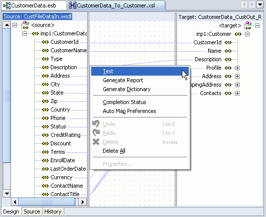

The XSLT Mapper provides three separate context sensitive menus:
One in the source panel
One in the target panel
One in the mapper pane or canvas in the middle
Right-click in each of the three separate panels to see what the context menus look like. A full set of Undo Auto Map, Redo, Delete, and Delete All functions are also available.

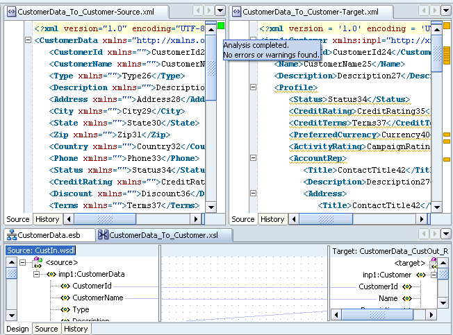

The XSLT Data Mapper tool that enables you to create an xsl file to transform data from one XML schema to another. After you define an xsl file, you can reuse it in multiple routing rule specifications. This section provides an overview of creating a transformation map xsl file with the XSLT Data Mapper tool.
The Data Mapper tool is available through the Routing Service property page or from the routing service icon in the Design tab of Oracle JDeveloper. You can either create a new transformation map or update an existing one.
To launch the Data Mapper tool from Routing Service property page and create or update a data transformation xsl file, follow these steps:
Open the properties page of a Routing Service.
Open the Routing Rules panel by clicking on the + to the left of Routing Rules as described in "Specifying Routing Rules".
The transformation map icon is visible in the routing rules panel. For an example of the routing service property page with the transformation map icon in the routing rules panel, see Figure 5-3.
Click the transformation map icon to the right of the Transformation Map field in the routing rules panel to open the Request Transformation Map dialog, shown in Figure 5-12.
The Request Transformation Map dialog displays with options for selecting an existing transformation map (XSL) file or creating a new map file.

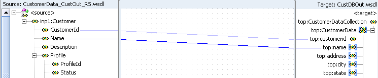

You can select and drag a component on either side of the tool to the component you want to correlate on the other side of the mapper tool. When you initially select and drag, the Auto Map Preferences dialog displays so you can set preferences for the mapping.
You can choose to drag and drop source elements to target elements individually or you can use the AutoMap feature in the Auto Map Preferences dialog. If you enable the AutoMap and Match Elements with Similar Names options, the Data Mapper tool automatically maps source elements to target elements after you click OK in the Auto Map Preferences dialog, as shown inFigure 6-4.
You can edit a new or existing transformation map.
Add new links by dragging and dropping source elements to target elements.
Remove (undo) links by selecting the link and right-clicking to bring up menu options. Select Undo link from the context menu.

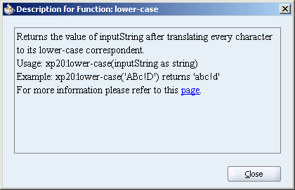

To view function definitions and use a function in a data transformation map, Perform the following steps:
Select a category of functions, such as String Functions, from the Component Palette.
Right-click an individual function, such as lower-case.
Select Help. A window with a description of the function appears. You can also click a link at the bottom to access the function description at the World Wide Web Consortium at www.w3.org.

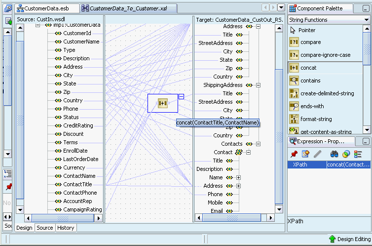

Drag a function from one of the functions categories in the Component Palette to the data mapper pane.
You can drag a function from the Component Palette on an existing link in the mapper pane.
For example, drag the lower-case function under String Functions on an existing link into the mapper pane, such as Email in the source list to contactemail in the target list. This function converts the email value in the source element to lower case when it is output to the target element.
You can drag a function into an empty area of the mapper pane. Then drag a source elements on the left handle of the function and a target element on the right handle of the function.
For example, drag the concat function under String Functions to the mapper pane. Drag threads from multiple source elements, such as CustomerData/ContactTitle and CustomerData/ContactName, to the left handle of the concat function. Then drag a thread from the Customer/ShippingAddress/Title element in the target list. This function combines the values in the source elements when it is output to the target element.

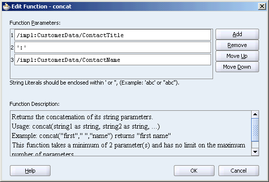

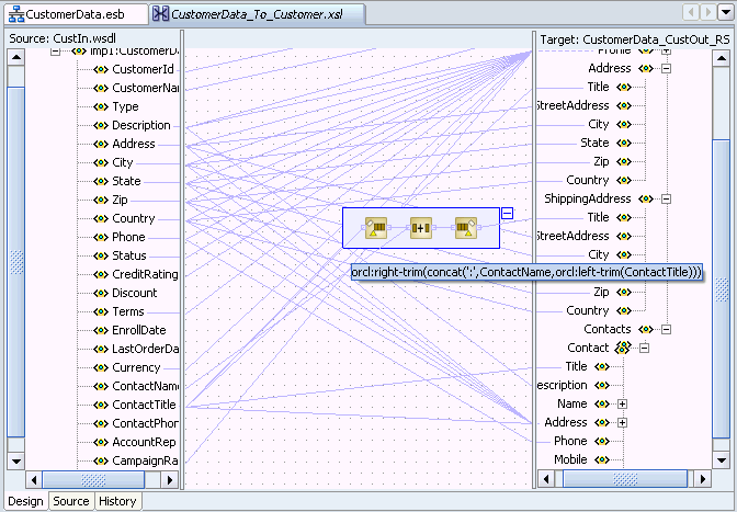

To edit the parameters of a function in the data mapper pane, double-click the function icon to launch the Edit Function dialog. This window enables you to add, remove, and reorder parameters.
For example, to edit the parameters of the concat function, double-click the function icon to launch the Edit Function - concat window. If you want to add a new parameter so that the output of the concat function is ContactTitle: Contact Name, then click Add to add a new parameter ':' (with single quotes) and reorder the parameters to get this output.
See Also: The online Help for the Edit Function window by clicking the Help button to see how to add, remove, and reorder function parameters |
Complex expressions can be built by chaining functions. The chaining function can also be defined by dragging and dropping the function to a connecting link.
For example, to remove all leading and trailing spaces from the output of the concat function discussed in "Editing Function Parameters", use the left-trim and right-trim functions and chain them as shown in the Figure 6-10.

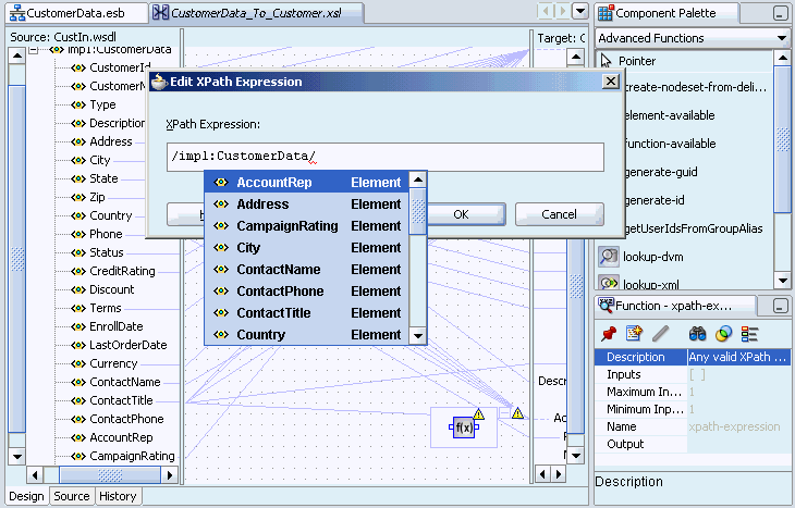

To use an XPath expression in a transformation mapping, select Advanced Functions from the Component Palette and drag and drop xpath-expression from the list into the data mapper transformation pane.
When you double-click the icon, the Edit XPath Expression dialog appears. You can press the Ctrl + spacebar to invoke the XPath Building Assistant, as show in Figure 6-11.

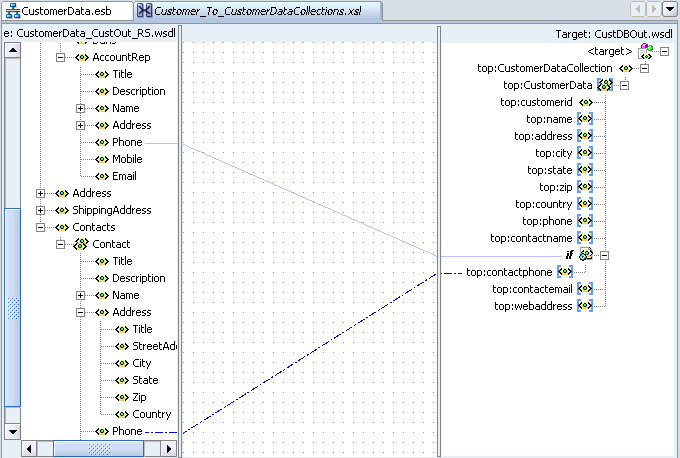

With the if construct, you can choose to map a source element if a the value exists and map a value from a different element when it does not exist. For example, if the source contains an AccountRep phone number use that value. If the AccountRep phone number does not exist, then use the Contact phone number.
Select the target element in the target tree and right-click to bring up the context sensitive menu.
Select Add XSL Node, and then if.
Connect a source element to the if element in the target tree.
Connect a source element to the target element.
Figure 6-12 shows the results.

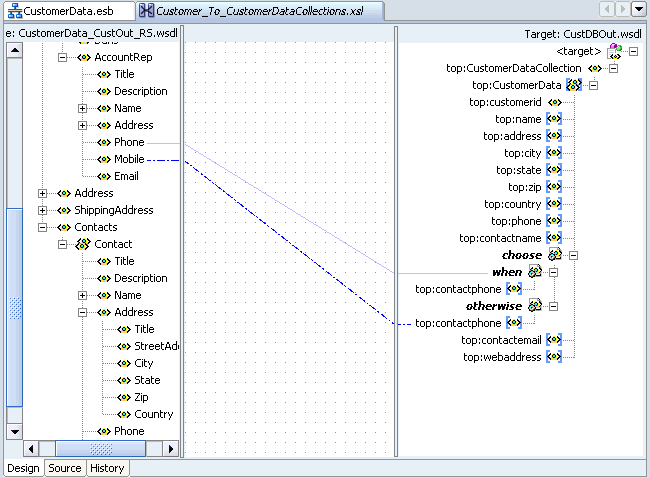

With the choose construct, you can copy a source element to a specified target element, if the source element exists. Otherwise, copy a different source element to the target element.
Select Add XSL Node, and then choose.
Connect the source element to the target element to define the condition.
Select choose in the target tree and right-click to bring up the context sensitive menu.
Select XSL Add Node and then otherwise.
Connect the source element to the target element under otherwise.
Figure 6-13 shows the results.

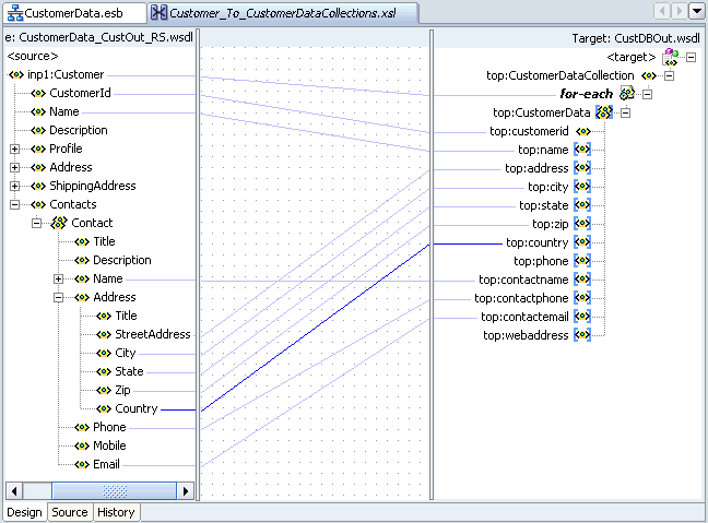

The XSLT Mapper allows repeating elements on the source to be copied to repeating elements on the target.
Select a target element in the target tree and right-click to bring up the context sensitive menu.
Select Add XSL Node, and then for-each.
Connect the repeating source elements to the targets elements.
Figure 6-14 shows the results.
Figure 6-14 Handling Repetition or Arrays

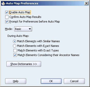

Mapping nonleaf nodes starts the auto map feature. The system automatically tries to link all relevant nodes under the selected source and target, as shown in Figure 6-4.
The behavior of the auto map can be tuned by altering the settings in Oracle JDeveloper preferences or by right-clicking the transformation window and selecting Auto Map Preferences. This displays the window shown in Figure 6-3.
This window enables you to customize your auto mapping as follows:
Invoke the automatic mapping feature, which attempts to automatically link all relevant nodes under the selected source and target. When disabled, you must individually map relevant nodes.
Display and review all potential source-to-target mappings detected by the XSLT Mapper, and then confirm to create them.
Be prompted to customize the auto map preferences before the auto map is invoked.
Select the Basic or Advanced method for automatically mapping source and target nodes. This enables you to customize how the XSLT mapper attempts to automatically link all relevant nodes under the selected source and target.
Manage your dictionaries. The XSLT Mapper uses the rules defined in a dictionary when attempting to automatically map source and target elements.
See Also: The online Help for the Auto Map Preferences window by clicking the Help button to see a description of the fields |

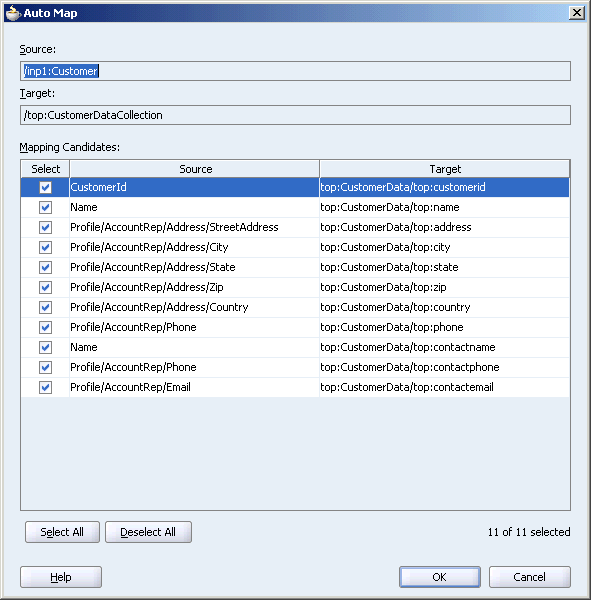

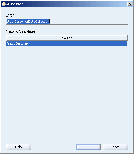

To see potential source mapping candidates for a target node, right-click the target node, select Show Matches, and click OK in the Auto Map Preferences window. The Auto Map window appears, as shown in Figure 6-15.
See Also: The online Help for the Auto Map window by clicking the Help button to see a description of the fields |
When the Confirm Auto Map Results check box shown in Figure 6-3 is selected, a confirmation window appears. If matches are found, the potential source-to-target mappings detected by the XSLT Mapper are displayed, as shown in Figure 6-16. The window enables you to filter one or more mappings.

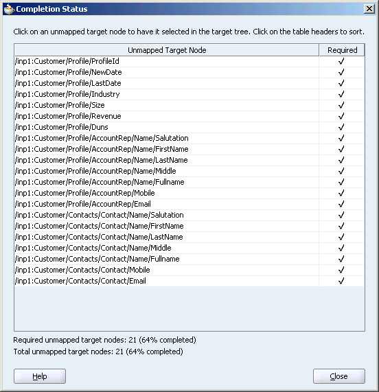

You can view a list of target nodes that are currently unmapped to source nodes. Right click in the mapper pane as shown in Figure 6-5 and select Completion Status. This window provides statistics at the bottom about the number of unmapped target nodes. This window enables you to identify and correct any unmapped nodes before you test your transformation mapping logic on the Test XSL Map window. Select a target node in the list. The node is highlighted. A check mark indicates that the target node is required to be mapped. If not required, the check box is empty.
Figure 6-17 provides an example of the Completion Status window.
A dictionary is an XML file that captures the synonyms for mappings. Right-click in the mapper pane as shown in Figure 6-5 and select Generate Dictionary. This prompts you for the dictionary name and the directory in which to place the dictionary.
The XSLT Data Mapper uses the rules defined in the dictionary when attempting to automatically map source and target elements. For example, you may want to map a purchase order to a purchase order acknowledgment, then reuse most of the map definitions later.

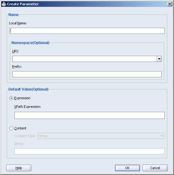

You can create map parameters and variables. You create map parameters in the source tree and map variables in the target tree.
Note the following issues:
Parameters are created in the source tree, are global, and can be used anywhere in the mappings.
Variables are created in the target tree, and are either global or local. Where they are defined in the target tree determines if they are global or local.
Global variables are defined immediately below the <target> node and immediately above the actual target schema (for example, POAcknowledge). Right-click the <target> node to create a global variable.
Local variables are defined on a specific node below the actual target schema (for example, subnode name on schema POAcknowledge). Local variables can have the same name as long as they are in different scopes. Local variables can only be used in their scopes, while global variables can be used anywhere in the mappings.
Right-click the source tree root and select Add Parameter.
The Create Parameter window appears.
Specify the information for the parameter.
Click OK.

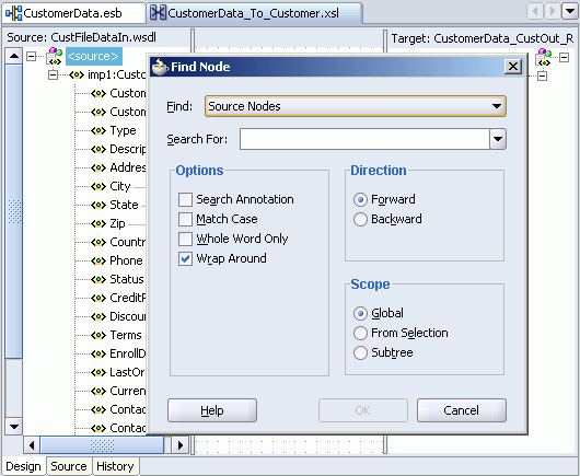

You can search source and target nodes. For example, you can search in a source node named Customer for all occurrences of the subnode named Name.
To search for a source or target node:
Right-click a source or target node.
Select the Find menu item.
The Find Node dialog displays.
In the Search For field, enter a keyword to search on.
Specify additional details, as necessary. For example:
Select Search Annotations if you want annotations text to also be searched.
Specify the scope of the search. You can search the entire source or target tree, search starting from a selected position, or search within a selected subtree.
The first match found is highlighted, and the Find window closes. If no matches are found, a message displays on-screen.
Select the F3 key to find the next match in the direction specified. To search in the opposite direction, select the Shift and F3 keys.
Note: You cannot search on functions or text values set with the Set Text option. |

The XSLT Mapper provides a test utility to test the style sheet or map. The test tool can be invoked by selecting the Test menu item from the mapper pane context sensitive menu, as shown in Figure 6-5. When you select Test, the Test XSL Map dialog displays, shown in Figure 6-18.
The test settings you specify are stored and do not need to be entered again the next time you test. Test settings must be entered again if you close and reopen Oracle JDeveloper.
Use the Data Mapper test utility for testing from data transformation maps.
To test an XSL map:
Select the Test menu item from the mapper pane context sensitive menu.
The Test XSL Map dialog displays, shown in Figure 6-18.
Choose to allow a sample source XML file to be generated for testing or click Browse to specify a different source XML file in the Source XML File field.
When you click OK, the source XML file is validated. If validation passes, transformation occurs, and the target XML file is created.
If validation fails, no transformation occurs and a message displays on-screen.
Select the Generate Source XML File check box to create a sample XML file based on the map source XSD schema.
Select the Show Source XML File check box to display the source XML file for the test. The source XML file displays in an Oracle JDeveloper XML editor.
If the map has defined parameters, the Parameters table appears. If you want to specify a value, click Specify Value and make appropriate edits to the Type and Value columns.
Enter a file name in the Target XML File field or browse for a file name in which to store the resulting XML document from the transformation.
Select the Show Target XML File check box to display the target XML file for the test. The target XML file displays in an Oracle JDeveloper XML editor.
If you select to show both the source and target XML, you can customize the layout of your XML editors. Select Enable Auto Layout and click one of the patterns.
For this example, the source XML and target XML display side-by-side, with the XSL map underneath (the default setting).
Click OK.
The test results appear, as shown in Figure 6-19.
The source and target XML each display in an Oracle JDeveloper XML editor. You can right-click an editor and select Validate XML to validate the source or target XML against the map source or target XSD schema.

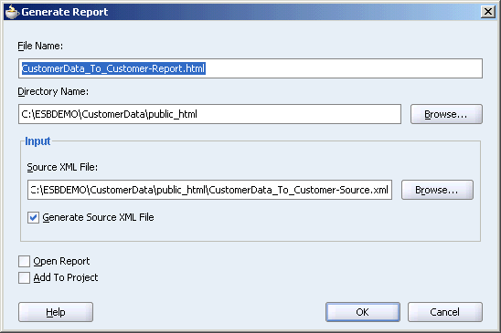

To generate a report, right-click the transformation window and select Generate Report. The Generate Report window appears in the transformation window, as shown in Figure 6-20. If the map has defined parameters, the Parameters table appears.
See Also: The online Help for the Generate Report window by clicking the Help button to see detailed information |
If you attempt to generate a report and receive an out-of-memory error, increase the heap size of the JVM as follows:
Open the Oracle_Home\integration\jdev\jdev\bin\jdev.conf file.
Go to the following section:
# Set the maximum heap to 512M # AddVMOption -Xmx512M
Increase the size of the heap as follows (for example, to 1024)
AddVMOption -Xmx1024M
In addition, you can also uncheck the Open Report option on the Generate Report window before generating the report.
