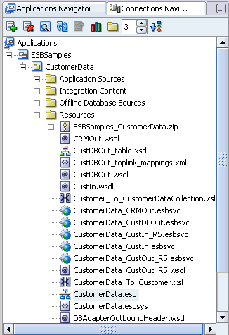

The Application Navigator tab, which appears in the upper left corner of Oracle JDeveloper, is the starting point of the design process. If the Applications Navigator is not visible in your console, from the View menu, select Application Navigator.
You use the Application Navigator tab to create an application workspace and an ESB project. Within an ESB project you can create multiple ESB systems. As you build the enterprise service bus, the files you create for the services, transformation maps, and so on, are presented in the Applications Navigator within the project folder.
A sample Application Navigator tab is shown in Figure 2-1. In this sample, an application workspace named ESBSamples contains an ESB project named CustomerData. See "Creating Applications and ESB Projects" for step-by-step instructions.
When you right-click a node in the Application Navigator tab, a menu of commands is displayed. The menu commands displayed depend on the node selected. For example, when you right-click an ESB project, such as CustomerData in Figure 2-1, the following commands are included in the menu:

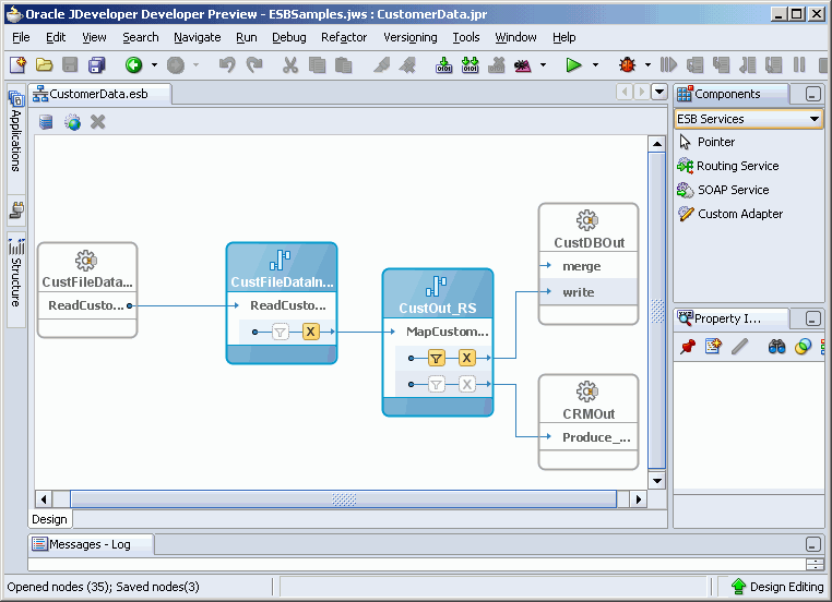

The Design tab initially appears in the empty area in the middle of the figure; the Components Palette appears to its right. In Figure 2-2, the CustomerData project is selected in the Applications view and the Design tab displays the adapter and routing services in the project.
Figure 2-2 JDeveloper Design Tab and Component Palette
To create an ESB service, you drag a desired ESB service type from the Components palette and drop it onto the Design tab. When you do so, a wizard or dialog box opens to assist you in creating the desired service. Alternatively, you can create ESB services and Adapter Services using dialog boxes only, but the Design tab provides a visual method for building the enterprise service bus.
For example, you can drag and drop a Routing Service from the Component Palette to the Design tab. When you do so, the Create Routing Service dialog box opens, as shown in Figure 2-3. When you complete this dialog box and click OK, an icon appears on the Design tab, similar to the CustOut_RS in Figure 2-2.
Figure 2-3 Create Routing Service Dialog Box
You can use this building block approach to add the component services to the enterprise service bus design one-by-one. Figure 2-2, for example, shows a completed simple ESB configuration.

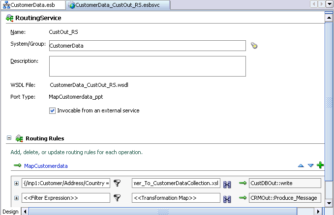

After you have created some services, you can view the definition of, and define properties for, each service. You can also view routing rules for a routing service.
For example, suppose you create the routing service whose icon is in the Design tab shown in Figure 2-2. When you double-click the top of the icon, property sheets replace the visual presentation of the enterprise service bus configuration. The Routing Rules panel is only displayed when you are viewing the property sheets for a routing service.
As shown in Figure 2-4, the Definition section presents the service name, ESB system (and group, if applicable), a description of the service, the name of the WSDL file that defines the service, the port type and an indication of whether the service can be invoked from a service that is external to the ESB system in which the service was created.
Figure 2-4 Sample Property Sheet for a Routing Service
The Routing Rules section, shown in Figure 2-4, presents icons that provide access to the tools that enable you to specify a filter expression, a transformation map, and the target operation (defined within the target service WSDL). It also enables you to limit the ESB systems from which messages will be accepted and whether execution of the target operation is to be synchronous or asynchronous.

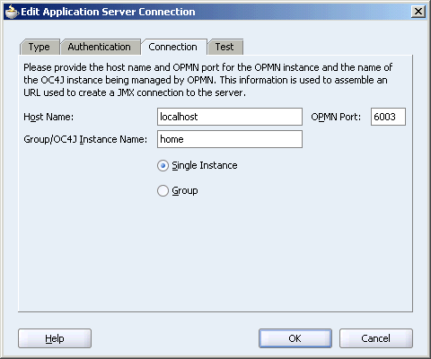

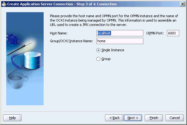

Connection page
Enter the information for the specific connection type. For example, these are options for the Oracle Application Server 10g 10.13 type:
Host Name: Enter the host name or localhost
OPMN Port: Enter the port number, such as 6003
OC4J Instance Name: Enter the OC4J instance name
Connect To: Select Single Instance or Group
Test page
On the Test page, click the Test Connection button to test the information you provided. If the test succeeds, click the Finish button. If the test fails, review the information for the connection and correct as necessary. Before testing, make sure the ESB Server is running.

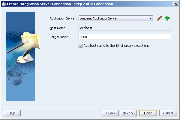

Connection page
Application Server: Select an application server that has been previously set up from the list
Port Number: Enter the port number, such as 8888
Add Host Name: Specify whether you want to add the host name to the proxy exceptions
Test page

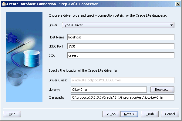

Connection page
Provide the connections details for the type of database connection selected on the Type page. For example, if Oracle Lite database type is selected you would enter data for the fields described in this step.
Driver type and connection details for an Oracle Lite database:
Driver: Select the driver, such as Type 4 Driver
Host Name: Enter the host name where the database is installed
JDBC Port: Enter the port number for database, such as 1531
SID: Enter the service ID of the database, such as oraesb
Location of the Oracle Lite driver jar:
Driver Class: Enter the class name or accept the default class name, such as oracle.lite.poljdbc.POLJDBCDriver
Library: Enter the library name, such as Olite40.jar
Classpath: Enter the classpath or accept the default classpath, such as c:\product\10.1.3.1\OraceleAS_1\integration\esg\lib\olite40.jar
Test page
On the Test page, click the Test Connection button to test the information you provided. If the test succeeds, click the Finish button. If the test fails, review the information for the connection and correct as necessary. Before testing, make sure the database is running.

Right-click a connection in the tree that has been already been set up and select Properties to display the Edit Connection property sheet. You can also double-click the connection to display the property sheet.
For example, right-click an application server under the expanded Application Server tree and select Properties. Click the Connection tab to view the connection properties.
Review the information in the property tabs for the connection.
In the Test tab, click Test Connection to test the connection.
If the test fails, then correct the information in the property tabs and retest. Make sure that the necessary server is running before testing the connection.

In the Applications Navigator, click the refresh icon.
An entry for the ESB system in the form, system-name.esbsys, is added to the Resources folder under the project name. For example, Figure 2-1 shows a Oracle JDeveloper application that contains an ESB project named CustomerData and an ESB system also named CustomerData.
An entry for the ESB service group in the form, service-group-name.esbgrp, is added to the Resources folder under the project name.

You use the integration server connection to register the ESB project and services that you have created with Oracle JDeveloper. This registration with the ESB Metadata Server is required to run these services, and to view and manage these services in the Oracle ESB Control. Before registering an ESB project and services, make sure you have a working integration server connection. See "Creating and Testing Connections".
To register services using an integration server connection, follow these steps:
Right click the ESB project in the Application Navigator.
Select the Register with ESB from the menu.
Click a local ESB Server option or on a connection to another integration server that has been set up.
When the ESB Registration Summary dialog displays, click OK.
When you refresh the Oracle ESB Control, the ESB services that you registered with the ESB Metadata Server display in the Oracle ESB Control Service Navigation tree.
