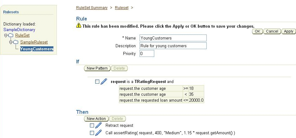

In Oracle Business Rules, facts are data objects asserted in the Oracle Business Rules Rules Engine. For example:
  • For a car rental company to create a rule to match a driver's age, the driver's age represents the fact used in the rule.
  • For a loan company to create a rule denying a loan request to customers whose incomes fall below a specific level, the income level represents the fact used in the rule.
Each data object instance corresponds to a single fact. Rules are expressions that can be evaluated on this factual information.
If an object is re-asserted (whether or not it has changed), the Oracle Business Rules Rules Engine is updated to reflect the new state of the object. Re-asserting the object does not create a new fact. In order to have multiple facts of a particular fact type, separate object instances must be asserted. Using the Oracle Business Rules Rule Author, you create rules that operate on facts that are part of a data model. You make business objects and their methods known to Oracle Business Rules using fact definitions.

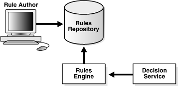

Oracle Business Rules consist of the following key components:

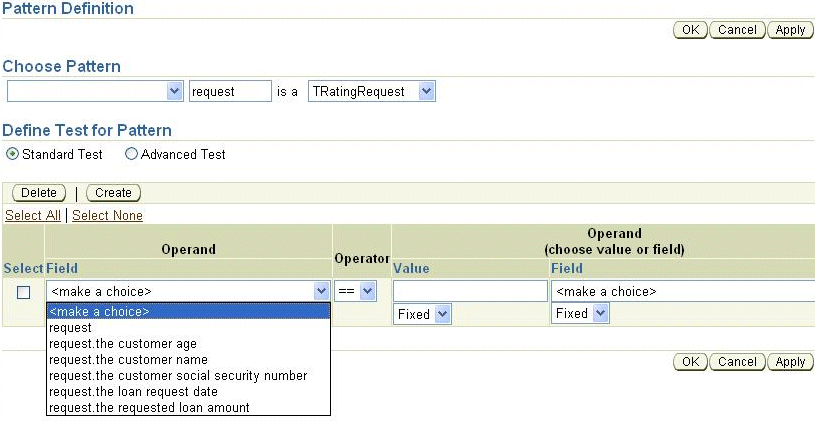

  • Oracle Business Rules Rule Author — A Web browser-based tool that provides a point-and-click interface to create and edit rules.
  • Oracle Business Rules Rules Engine — A Java library that applies rules to facts and defines and processes rules. The Oracle Business Rules Rules Engine defines a declarative rule language, provides a language processing engine, and provides debugging tools.

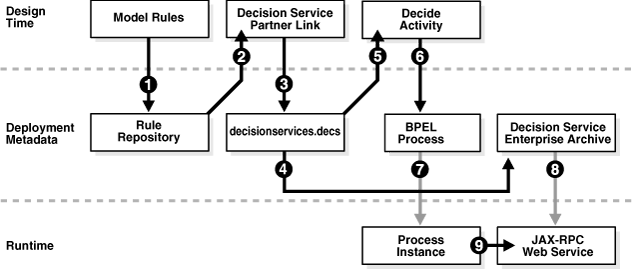

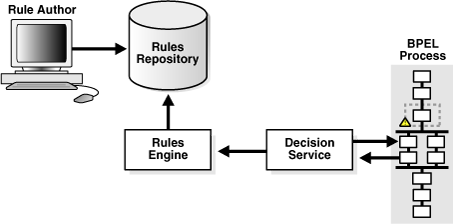

Figure 18-1 shows how the decision service interacts with other components.
Figure 18-1 Decision Service Component Interaction
Description of bpmdg053.gif follows
  1. The rule author is used for rule modeling
    The rule model is saved to a rule repository. The rule repository can be a file or a directory at a WebDav backend.
  2. The RPI of the decision service is used by the Decision Service wizard to create a connection to the rule repository and browse the repository metadata.
  3. The Decision Service wizard creates the decision service metadata configuration file. The metadata consists of information about the backend rule engine being used (rule provider) and the interaction patterns (together with fact type information) modeled for the partner link.
  4. The decision service builder creates the decision service enterprise archive for deployment into an application server. As part of this, a WSDL is created with message types and operations adjusted to what you modeled in Step 3.

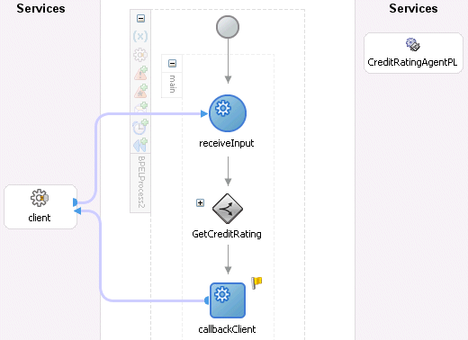

  5. The decide activity uses decision service metadata information to present you with a list of available operations of the service and detailed information on the number and types of facts used for an interaction with the rule engine
  6. The decide activity completes generation of a new BPEL scope in the BPEL process model. Appropriate assign activities are created to convert the data from BPEL variables to data that the decision service (and more importantly the backend rule engine) expects.
  7. The BPEL process is deployed to Oracle BPEL Process Manager during deployment time.
  8. The decision service enterprise archive is deployed to the application server.
  9. The BPEL process instance invokes the JAX-RPC decision service at run time, which then interacts with the backend rule engine, executes rule sets, invokes functions, and so on. Results are eventually returned to the BPEL process.

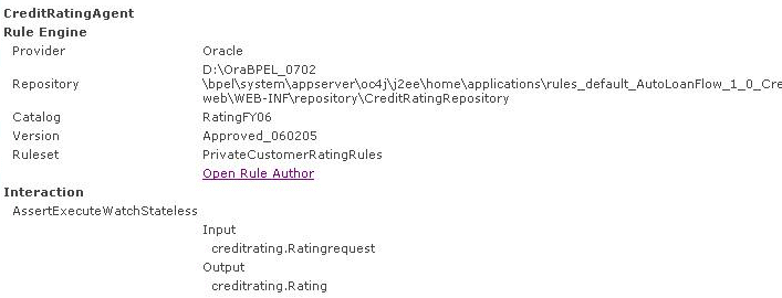

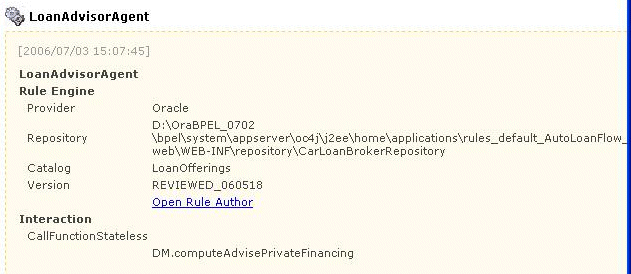

18.2.3 Contents of Decision Service Configuration File
The decision service configuration file (decisionservices.xml) defines the contract between the various components involved in the interaction of the decision service with the design time and a backend rule engine.The decision service configuration file consists of two parts:
  • The first part specifies metadata about the rule engine connections.
  • The second part provides the metadata for specific interaction patterns with a backend rule engine.
For example:
<decisionServices xmlns="http://xmlns.oracle.com/bpel/rules">
  <ruleEngineProvider provider="Oracle" name="CreditRatingRuleRepository">
    <repository type="File">
      <file>
/D:/bpeldev/10.1.3/demo/LoanDemoPlusRules/repository/CreditRatingRepository
      </file>
    </repository>
  </ruleEngineProvider>
  <ruleEngineProvider provider="Oracle" name="LoanAdvisorRepository">
      <file>
/D:/bpeldev/10.1.3/demo/LoanDemoPlusRules/repository/CarLoanBrokerRepository
      </file>
    </repository>
  <decisionService name="CreditRatingAgent"
                   targetNamespace="http://cr.org/CreditRatingAgent"
                   ruleEngineProviderReference="CreditRatingRuleRepository">
    <catalog>RatingFY06</catalog>
    <catalogVersion>Approved_060205</catalogVersion>
    <ruleset>PrivateCustomerRatingRules</ruleset>
    <pattern name="AssertExecuteWatchStateless">
      <arguments>
        <assert>creditrating.Ratingrequest</assert>
        <watch>creditrating.Rating</watch>
      </arguments>
    </pattern>
  </decisionService>
  <decisionService name="LoanAdvisorAgent"
                   targetNamespace="http://laa.org/LoanAdvisorAgent"
                   ruleEngineProviderReference="LoanAdvisorRepository">
    <catalog>LoanOfferings</catalog>
    <catalogVersion>REVIEWED_060518</catalogVersion>
    <pattern name="CallFunctionStateless">
      <arguments>
        <call>DM.computeAdvisePrivateFinancing</call>
      </arguments>
    </pattern>
  </decisionService>
</decisionServices>
The configuration file includes the following elements:
  • ruleEngineProvider — Specifies metadata about a backend rule engine connection. Apart from the rule engine provider, information on the rule repository is specified. You distinguish between these types of repositories:
    • File — The rule repository is stored in a file or directory.
    • WebDav — The rule repository is stored in a WebDav location.
  • decisionService — Consists of a name, an optional target namespace, and a mandatory reference to the rule engine to use for the interaction. A complete interaction with the rule engine is specified, which includes the catalog and catalog version to use, and the rule set to execute. Various interaction patterns are supported. Apart from the name of the pattern, the pattern signature is specified in terms of input and output facts or function names.

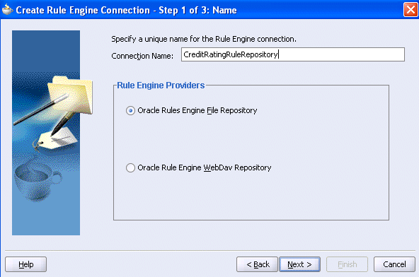

18.4.1 Create Rule Engine Connection Wizard
The Create Rule Engine Connection wizard enables you to create a connection to a rule engine. This connection enables you to browse and select rule sets and functions available in rule dictionaries of a rule repository in the business rule engine. You only need to create one connection to the rule engine. Once created, this connection is shared between multiple BPEL projects.

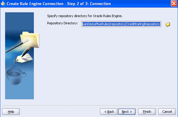

  1. Select Connection Navigator from the View main menu in Oracle JDeveloper.
  2. Right-click Rule Engines and select New Rule Engine Connection.
  3. Click Next on the Welcome window.
  4. Enter a name. When creation of the rule engine connection is complete, this name displays in the Connection Navigator under Rule Engines.
  5. Select the type of repository in which the rule sets and functions are stored in the repository of the business rule engine. For this release, the Oracle Business Rules Rules Engine is supported.
    Description of ds_name.gif follows
  6. Click Next.
  7. Click the folder icon to select a file repository directory. If you selected Oracle Rules Engine WebDav Repository, you are instead prompted to select a WebDav connection to the repository.
    Description of ds_repos.gif follows
    You can create a WebDav connection by right-clicking WebDAV Server and selecting New WebDAV Connection in the Connection Navigator.
  8. Click Next.
    The Test Connection window appears.
  9. Click Test.
    If the connection to the business rule repository is successful, the following message appears:
    Success
    If the connection is unsuccessful, click Details to view the reason for failure. Take appropriate corrective actions.
  10. Click Finish.
    The connection name displays in the Connection Navigator under Rule Engines. If you need to edit the connection, double-click the connection name to display configuration details.

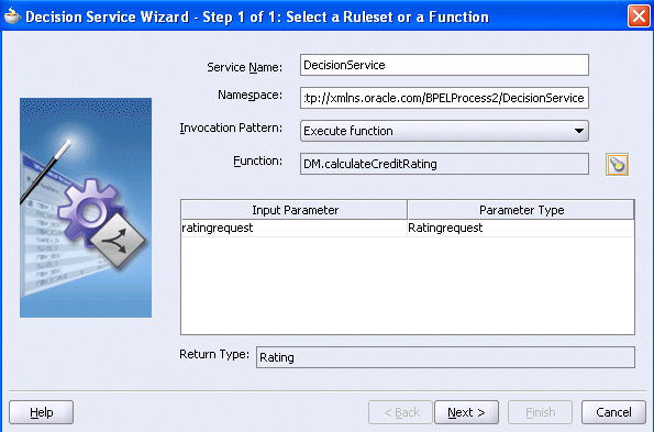

The Decision Service wizard enables you to integrate your BPEL process with a business rule (for example, a rule set or function) that you created in the Oracle Business Rules Rules Engine. This enables you to make business decisions based on these rules.
Figure 18-3 provides an overview of this integration process.
Figure 18-2 Decision Service
Description of bpmdg050.gif follows
This wizard performs the following tasks:
  • Guides you through the selection of a rule set or function from a repository and the invocation pattern (operation) to perform
  • Converts your selection into a Web service to use in the BPEL process
A new decision service partner link for this Web service is automatically created that interfaces with the Oracle Business Rules Rules Engine. A WSDL file based on the rule set is generated.

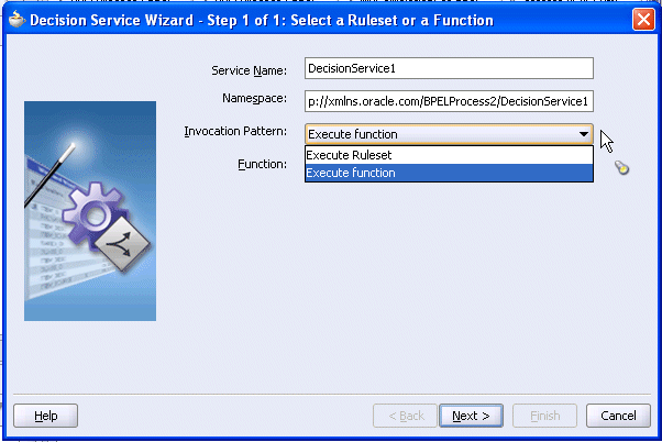

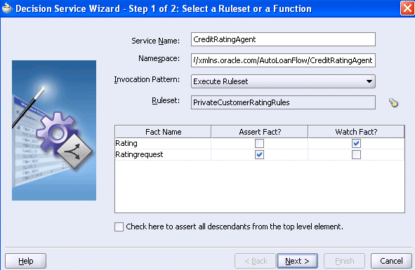

18.4.2.1 Selecting an Invocation Pattern
The Decision Service wizard enables you to select an invocation pattern that describes how to interact with the business rule engine.
  1. Drag and drop a Decision Service from the Services list of the Component Palette onto either side of the designer window beneath the header Services.
  2. Enter a name in the Service Name field. When complete, this name is used as the partner link name. A WSDL file of the same name is also created.
    The Namespace field is automatically completed with your entry from the Service Name field. You must have a unique namespace for each WSDL in your project. This is because some BPEL variables are generated from elements in the WSDL files.
  3. Select an invocation pattern for invoking the rule set or function. The wizard creates rule sessions based on the invocation pattern you select. You do not have the option of selecting between stateful or stateless rule sessions.

    The following invocation patterns are available for selection:
    • Execute Ruleset
    • Execute function
  4. Click the flashlight next to the Ruleset or Function field. The name of this field is based on your selection in the Invocation Pattern field. This opens the Explorer window.

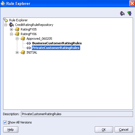

18.4.2.2 Selecting a Business Rule

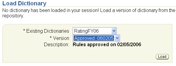

  1. Click Show All Versions to display all the catalog versions of rule dictionaries in the rule repository of the business rule engine.
  2. Expand and select the dictionary (RatingFY06), dictionary version (Approved_0600205), and rule set (PrivateCustomerRatingRules).
    Description of ds_showall.gif follows

    • If you have not created a connection to the rule engine, you cannot access the rule sets and functions in the rule repository. Click the first icon in the upper right to start the Create Rule Engine Connection wizard.
    • An alternative to creating a connection to a file-based rule repository is to directly import a file into a project. Note that each BPEL project must physically copy the repository file to the project at the time of Web service creation. After the file is copied, any changes to the original file are not reflected in the Web service. Click the second button in the upper right to browse for the file to import. The file must be a valid Oracle rule repository file. Otherwise, an error appears.

18.4.2.3 Specifying Input and Output Facts
Based on the type of invocation pattern you selected, the Select a Ruleset or a Function window displays a table with different details at the bottom of the window.
18.4.2.3.1 Rule Sets

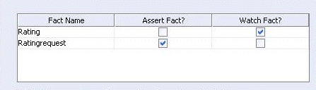

The table displays the facts in the data model of the catalog from which you selected the rule set. You select the facts to assert (that is, set the value from the BPEL variable to the fact) and retrieve the results to return. Note that the columns that appear are based on whether the selected pattern asserts facts, retrieves facts, or does both.
  1. Specify the input (assert) and (optionally) the output (watch) facts. The assert facts enable you to assert a fact to the rule set or function (send factual data to the business rule engine). The watch facts enable you to return results from the rule set or function. Watch facts only appear if you selected an invocation pattern that retrieves results.
    Description of ds_facts.gif follows
    The Check here to assert all descendants from the top level element check box enables you to assert all the descendants of the selected rule set or function. For example, assume that a purchase order rule set contains three fact types. If this check box is selected, the purchase order and all three fact types are asserted. If this check box is not selected, only the purchase order is asserted.
  2. Click Next.

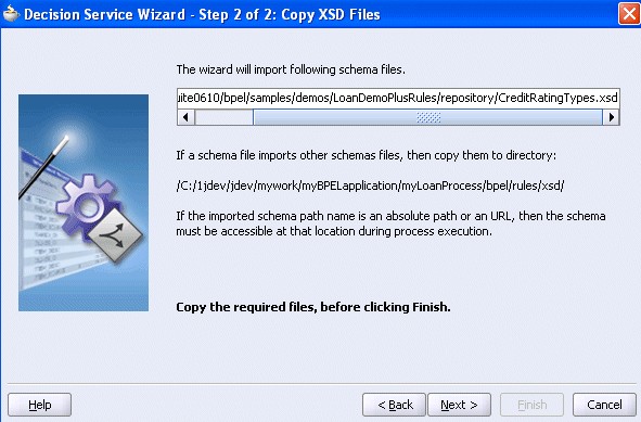

18.4.2.4 Importing Schema Files
  1. Review the on-screen messages to ensure that all necessary XSD schema files for this project are imported from the repository by the wizard.
    Description of ds_schema.gif follows
    The wizard attempts to identify all the schema files in the repository that must be imported into this project. Based on this attempt, this window can display the following status messages:
    • If the Decision Service Wizard finds the schema files to import, the directory paths to the files display at the top of this window. No action is required on your part.
    • If the Decision Service Wizard cannot find the schema files to import, the directory paths to the files display at the top of this window. You must manually copy these files to the specified directory.
    • If this XSD schema file includes or imports other schema files, ensure that those files are copied into the bpel\rules\xsd subdirectory of your BPEL project indicated on-screen. Ensure that you use only relative directory paths for these schema files.
  2. Click Next.
    The decision service partner link is created. A directory named decisionservices is also created in the BPEL project. A directory with the same name as the service name is created inside the decisionservices directory.

18.4.3 Decide Activity
The decide activity enables you to create a BPEL process activity that invokes the decision service partner link you created with the Decision Service wizard. This activity also enables you to create copy operation assignments between the fact data in your rule set or function and BPEL variables.
When complete, a decide activity consisting of assign and invoke activities to the decision service partner link is created.
Figure 18-3 Decide Activity
Description of bpmdg049.gif follows

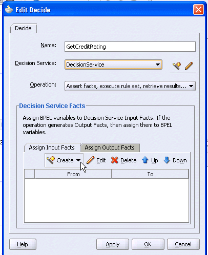

18.4.3.1 Mapping Input and Output Facts to BPEL Variables

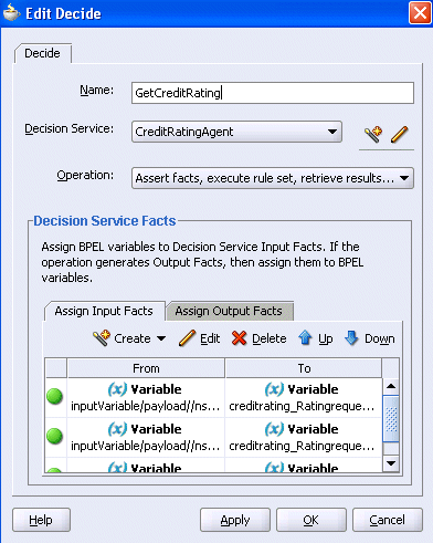

  1. Drag and drop a Decide activity from the Process Activities list of the Component Palette into your BPEL process.
  2. Enter a name.
  3. Select the decision service partner link you created. If you have not created a decision service, click the first icon to the right of the Decision Service field.
  4. Select the operation of the invocation pattern to perform. The operations available for selection are based on the invocation pattern you selected in Step 3.
    • If you selected Execute Ruleset
      • Assert facts only — Select the rule engine facts you want to assert (send factual data to the rule engine) in the future. You assign the required data for the facts with a BPEL assign activity. The underlying rule session must be stateful. Otherwise, the asserted facts are not visible to subsequent rule engine invocations.
      • Retrieve results — Retrieve a result from the business rule engine. The values of these results may have changed by past execution of a rule set acting on these facts. The wizard assumes that it has a stateful rule session in its cache from which a result can be retrieved. This is the case if the invocation pattern Assert facts and execute rule set operation was executed before in the BPEL process.
      • Assert facts and execute rule set — The same as Assert facts only, except that the rule set is executed after the facts are asserted. The wizard creates (or uses) a stateful rule session. Otherwise, the result of executing this pattern is lost. No results are retrieved from the business rule engine.
      • Assert facts, execute rule set, and retrieve results — The same as Assert facts and execute rule set, except that the results are retrieved from the business rule engine. You map the results of rule set execution to BPEL variables with an assign activity. The rules session remains active. This enables you to reuse previously asserted facts.
      • Assert facts, execute rule set, retrieve results, and reset the session — The same as Assert facts, execute rule set, and retrieve results, except that the results are reset for the next time that you invoke the Web service. Resetting the session clears the previously asserted fact values.
    • If you selected Execute function
      • Execute function — Executes a function. Functions are also defined in dictionaries. For rule sets, you select input and output facts. For functions, there are a fixed set of input parameters and a single return value.
      • Execute function and reset the session — The same as Execute function, except that a stateful rule session is created for this pattern. All fact values are reset after retrieving the return value of the function.

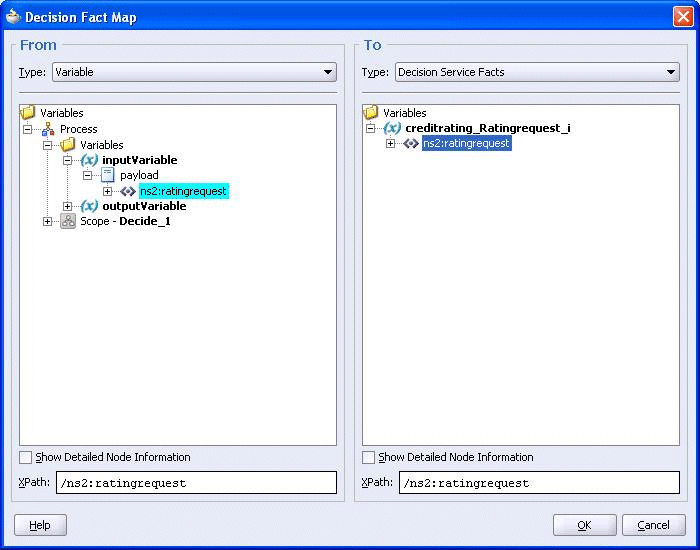

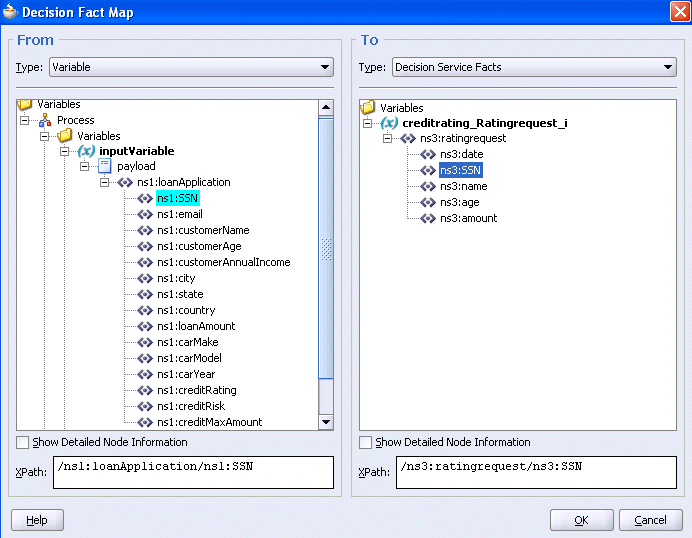

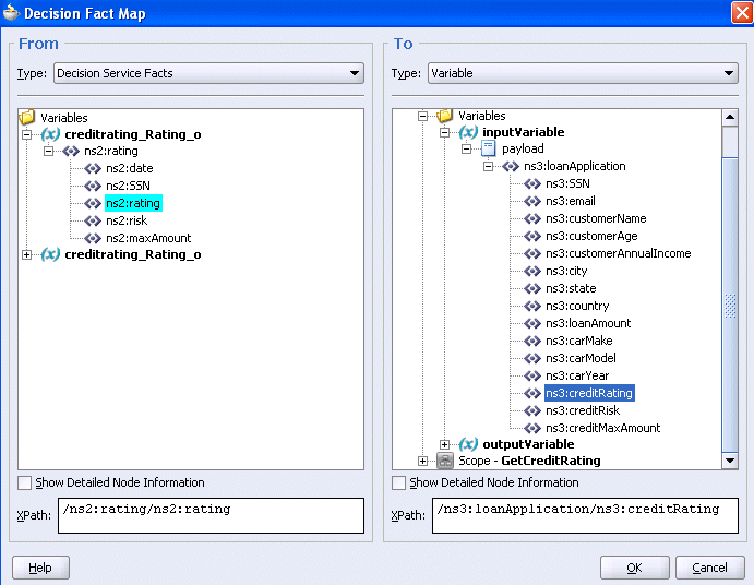

  5. Click Assign Input Facts, then click Create to create mappings for the input facts. This enables you to assign BPEL variables to the facts to be asserted or to the function input parameters.
    Description of ds_edit.gif follows
    This enables you to create assignments that map BPEL input variables to automatically created BPEL variables that correspond to the input (assert) fact type shown in "Specifying Input and Output Facts" (for this example, Ratingrequest).

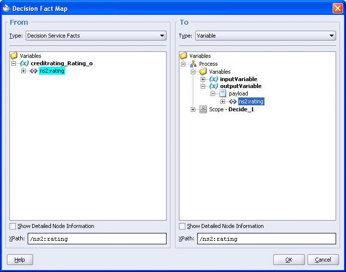

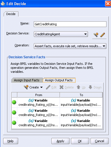

  6. If you selected an invocation pattern that retrieves results, click Assign Output Facts, then click Create to create mappings for the output facts. This enables you to assign values from a function return value or rule set result to a BPEL variable.
    This enables you to create assignments that map automatically created BPEL variables that correspond to the output (watch) fact type shown in "Specifying Input and Output Facts" (for this example, Rating) to BPEL input variables.
  7. Click OK when complete.
    A decide activity consisting of assign and invoke activities to the decision service partner link is created.

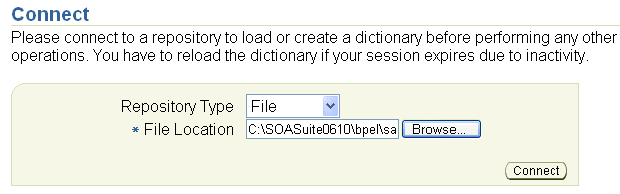

  5. Select File from the Repository Type list.
  6. Click Browse to the right of the File Location field.
  7. Select the repository file location specified in Step 1.
  8. Click Create.
    A message indicates that a repository connection has been created.

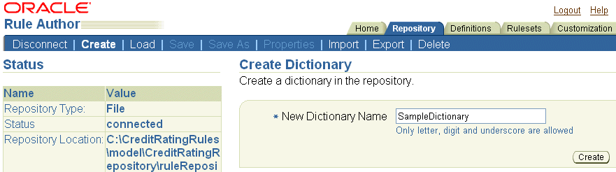

  9. Click the Create subtab.
    The Create Dictionary page appears.
  10. Enter SampleDictionary in the New Dictionary Name field and click Create.
    Description of ds_method1.gif follows
    A message indicates that the dictionary has been imported.

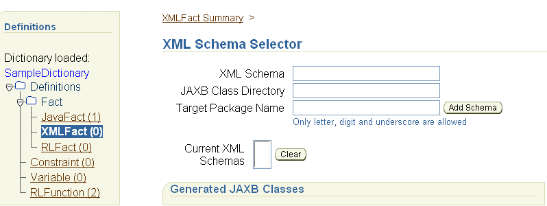

    The XML Schema Selector page appears.
    Description of ds_schemasel.gif follows

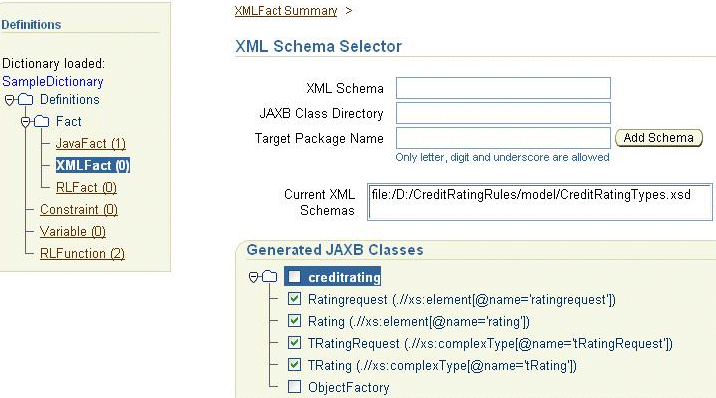

  4. Enter the following details:
    Field Value
    XML Schema Enter the absolute path to the CreditRatingTypes.xsd file you created in Step 2 of "Task 1: Create a Data Model for Rule Authoring". For this example, the second schema file model described in that step was used.
    JAXB Class Dictionary Enter a directory in which to create the JAXB classes.
    Target Package Name Enter a Java package name to use for the XML fact types (for example, creditrating).
  5. Click Add Schema.
  6. Expand the Generated JAXB Classes tree at the bottom.
  7. Specify the objects in the schema to import. For this example, Ratingrequest, Rating, TRatingRequest, and TRating are selected.
    Description of ds_import.gif follows
  8. Click Import.
    A confirmation message displays indicating that four classes or packages have been imported.

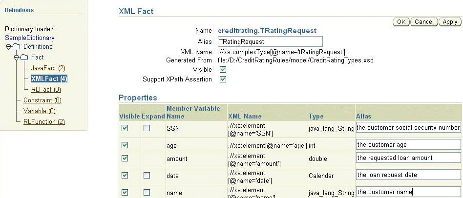

    You can now specify meaningful aliases for your data model. This action is optional, but considered a good practice for rule modeling.
  9. Click XMLFact in the Definitions tree.
  10. Select creditrating.TRatingRequest from the XML Fact Summary table.
  11. Click Edit.
    The Properties section appears.
  12. Enter appropriate text in the Alias column for the SSN, age, amount, date, and name properties.
    Description of ds_alias.gif follows
  13. Click OK.

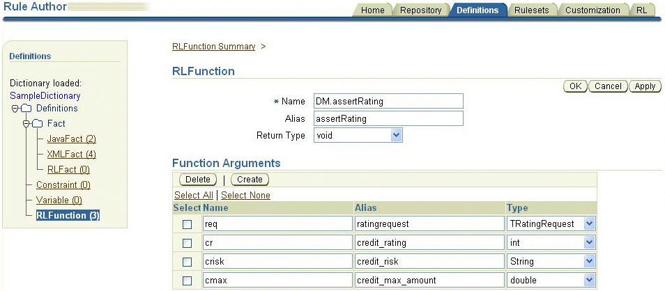

    As part of the data model, RL functions can be specified. It is a convenient way to simplify rule action handling by externalizing the logic of a rule action into a RL function. In this case, the purpose of the rules is to accept a rating request for which rules are applied. The result of rule execution is a new rating object consisting of the data calculated by the rules. Therefore, it is convenient to create an RL function that creates a new rating object and asserts it with the rule engine.

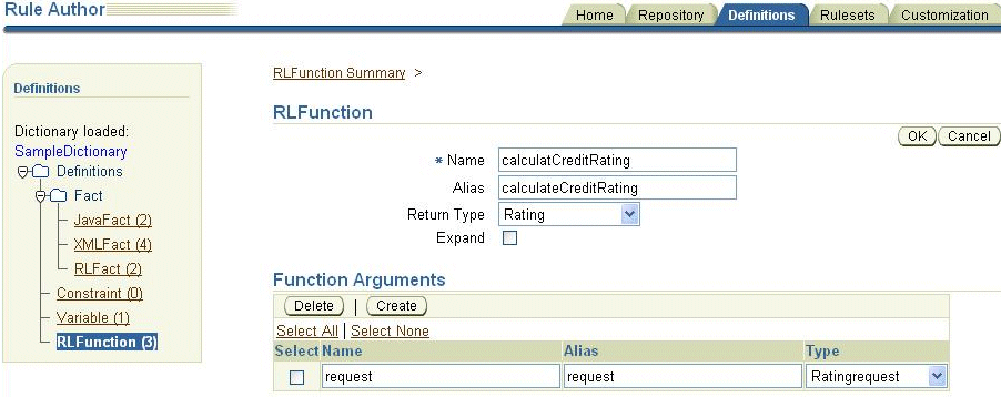

  14. Click RLFunction in the Definitions tree.
    The RLFunction Summary page appears.
  15. Click Create.
    The RLFunction page appears.
  16. Enter the following details:
    Field Value
    Name DM.assertRating
    Alias assertRating
    Return Type void
    The page looks as follows:
    Description of ds_function.gif follows
  17. Enter the following function in the Function Body section:
    // Create a new Rating object using JAXB ObjectFactory
    creditrating.ObjectFactory of = new creditrating.ObjectFactory();
    creditrating.Rating rating = of.createRating();
    // Get a calendar instance for the current date
    java.util.Calendar calendar = java.util.Calendar.getInstance();
    // Set Rating object attributes
    rating.setSSN(req.getSSN());
    rating.setDate(calendar);
    rating.setRating(cr);
    rating.setRisk(crisk);
    rating.setMaxAmount(cmax);
    // Assert Rating object in working memory
    assert (rating);
  18. Click Apply.
    The following confirmation message appears:
    This entity has been updated successfully.
18.5.2.4 Task 4: Create a New Rule Set and Model Rules
After the data model is defined, you can create the rules for the credit rating.
  1. Click the Rulesets tab.
  2. Click Create in the RuleSet Summary page.
    The Ruleset page appears.

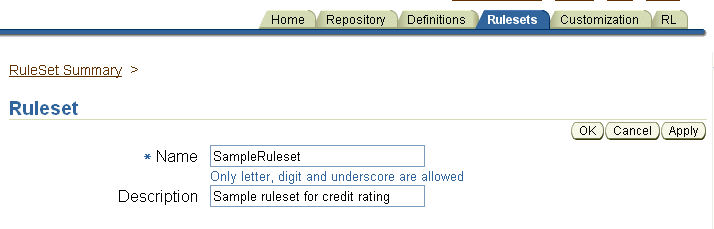

  3. Enter SampleRuleset in the Name field.
  4. Enter an optional description in the Description field.
    Description of ds_sampleruleset.gif follows
  5. Click OK.

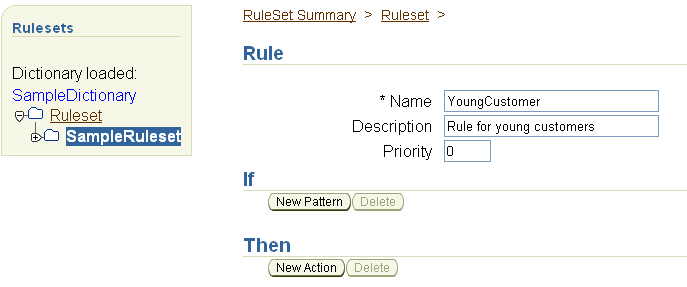

  6. Select SampleRuleset in the RuleSets tree on the left.
  7. Click Create in the Rules section.
  8. Enter the following details:
    Field Value
    Name YoungCustomers
    Description Rule for young customers
    Priority 0
    When complete, the Rule page appears as follows:
    Description of ds_rule.gif follows

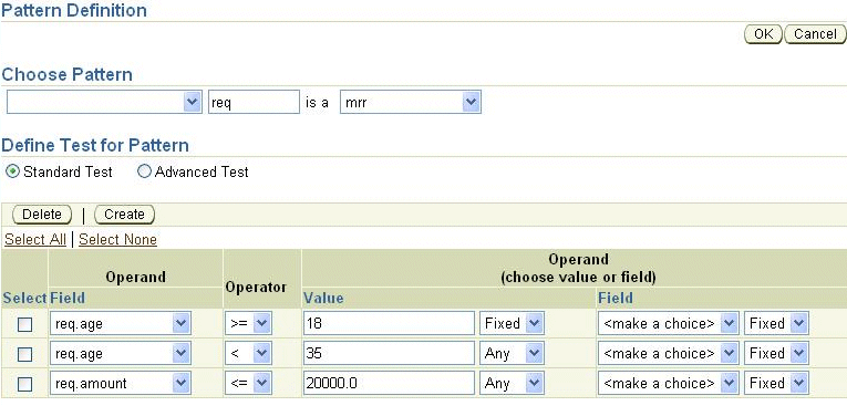

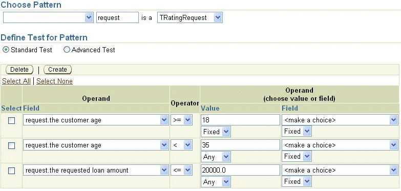

  9. Click New Pattern to define the If pattern of the rule (the rule matching part).
    The Pattern Definition page appears asking for the pattern of the young customer rule.
  10. Enter an optional name for the expected fact to match in the Choose Pattern section.
  11. Select TRatingRequest from the drop-down list.
    It now becomes clear what it means to model the rules on the XML schema type level, and not on the element level.
  12. Click Create in the Define Test for Pattern section.
  13. Select the appropriate operands from the Field column.
    Description of ds_patterndef.gif follows
  14. Specify several matching statements for the rule. For this example, the young customer rule is executed if the following statements are satisfied:
    • If the rating request comes from a customer at least 18 years of age and less than 35 years of age.
    • If the requested loan amount is less than 20,000.
    Description of ds_patterndef2.gif follows
  15. Click Apply.
  16. Specify the Then section of the rule.
    As part of the action, you want to retract (remove) the original rating request object from the working memory of the rule engine and create and assert a new rating object.

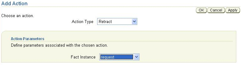

  17. Click New Action in the Then section of the Rule page to retract the original request object (the object that caused the rule to be invoked).
  18. Select Retract from the Action Type list.
  19. Select request from the Fact Instance list.
    Description of ds_newact.gif follows
  20. Click OK.

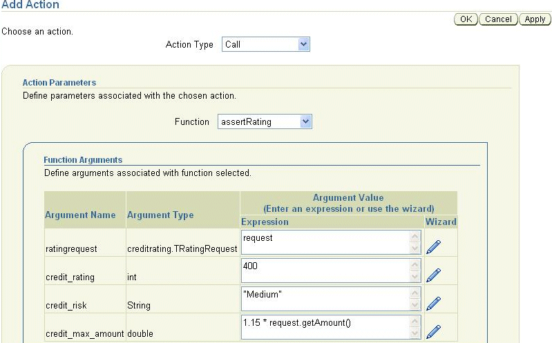

  21. Click New Action again and select Call from the Action Type list.
  22. Select assertRating from the Function list. This is the function created in Step 16.
  23. Provide values for the function parameters. For this example, ratingrequest, credit_rating, credit_risk, and credit_max_amount). The values for ratingrequest and credit_max_amount cause the rule to be invoked and can be used in the rule action part.
    Description of ds_addact.gif follows
  24. Click OK.
    The rule appears as follows:
    Description of ds_rules4.gif follows
  25. Double-check the rule and confirm by clicking OK.

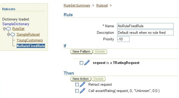

    It is a good practice to model a rule with no if statement pattern (simply accepting the fact) and an action that generates a well-defined result for the case where no other rule is invoked. For example:
    • Set the priority to -10 in the Priority field to ensure that this rule is not invoked if other rules match the pattern of the fact instance.
    • Accept the fact (request is a TRatingRequest in the If section) without specifying any additional test pattern.
    • Provide a dummy result that can be checked later from Oracle BPEL Process Manager (Call assertRating(request, 0, "Unknown", 0.0) in the Then section).
    Description of ds_example.gif follows

  1. Load the sample dictionary from the "Methodology One: Modeling Fact Types Based on an XML Schema" into the rule author.

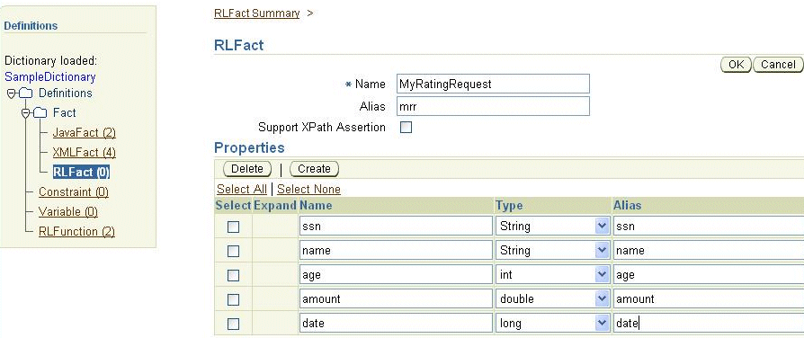

  3. Select RLFact in the Definitions tree.
  4. Create a new RL fact type named MyRatingRequest.
    Description of ds_rlfact1.gif follows

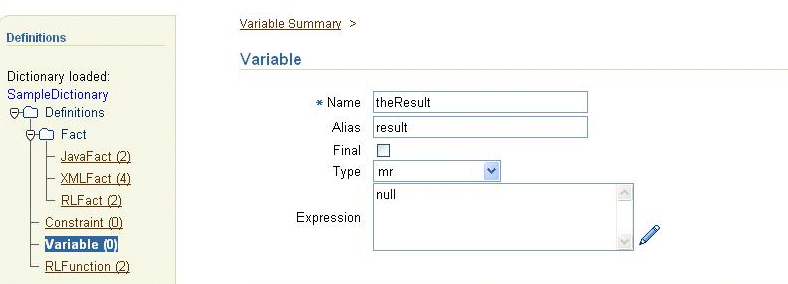

    For the function to work properly, you must create a global variable to use as a placeholder to carry the result of rule execution.
  7. Select Variable in the Definitions tree.
  8. Select Create.
  9. Create a variable named theResult of type mr.
    This is the alias of RL fact type MyRating.
    Description of ds_var1.gif follows

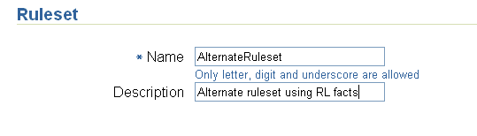

  3. Enter AlternateRuleset in the Name field.
    Description of ds_altrs.gif follows

  8. Click New Pattern to enter the If pattern of the rule (the rule matching part).
  9. Specify several matching statements for the rule. For this example:
    Description of ds_pattdef.gif follows

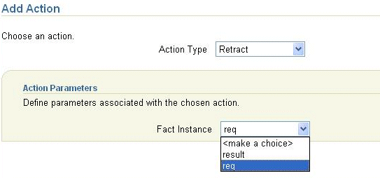

  11. Click New Action in the Then section.
  12. Select Retract from the Action Type list.
  13. Select req from the Fact Instance list.
    Description of ds_newact2.gif follows
  14. Click OK.

18.5.3.4 Task 4: Create the RL Function Contract
You now create an RL function.
  1. Select Definitions.
  2. Select RLFunction in the Definitions tree.
    The RLFunction Summary window appears.
  3. Click Create.
    Field Value
    Name calculatCreditRating
    Alias calculateCreditRating
    Return Type Rating
    Expand Do not select.
    The page appears as follows:
    Description of ds_rlfunct.gif follows
  5. Add the following function to the Function Body section:

18.5.4.1 Task 1: Create a Connection to the Rule Engine
  1. Restart Oracle JDeveloper.
  2. Select Connection Navigator from the View main menu in Oracle JDeveloper.
  3. Right-click Rule Engines and select New Rule Engine Connection.
  4. Click Next on the Welcome window.
  5. Enter SampleRuleRepository in the Connection Name field.
  6. Select Oracle Rules Engine File Repository as the business rule engine to which to connect.
  7. Click Next.
    The Connection window appears.
  8. Click the folder icon to select the directory in which the file repository is located.
  9. Select the CreditRatingRepository file repository from the C:\CreditRatingRules\model\CreditRatingRepository directory. This is the repository you created in Step 1.
  10. Click Open.
  11. Click Next.
  12. Click Test.
    If the connection to the business rule engine is successful, the following message appears:
    Success
  13. Click Finish.

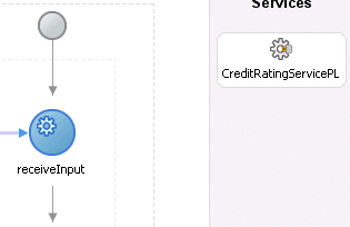

18.5.4.3 Task 3: Create a Decision Service Partner Link
  1. Ensure that Services is selected in the drop-down list of the Component Palette section in the upper right section of Oracle JDeveloper.
  2. Drag and drop a Decision Service onto the right side of the designer window anywhere beneath the header Services.
    The Select a Ruleset or a Function window appears. This window enables you to select an invocation pattern.
  3. Enter the following details:
    Field Value
    Service Name CreditRatingService
    Note: When complete, this becomes the name of the partner link.
    Namespace http://xmlns.oracle.com/myLoanProcess/CreditRatingService
    Note: This field is automatically completed with your entry in the Service Name field.
    Invocation Pattern Execute Ruleset
  4. Click the flashlight icon next to the Ruleset field.
    The Rule Explorer window appears.
    This window enables you to browse and select the rule set in the dictionary of the repository you modified in Step 3 of "Task 4: Create a New Rule Set and Model Rules".
  5. Click Show All Versions at the bottom of the window to display all versions of rule dictionaries in the specified repository in the business rule engine. Business rule engines can contain multiple rule dictionaries and versions.
  6. Expand and select SampleRuleRepository > SampleDictionary > INITIAL > SampleRuleset.
    Description of ds_ruleexp.gif follows
  7. Click OK.
    You are returned to the Select a Ruleset or a Function window of the Decision Service wizard. All fact names for the SampleRuleset rule set now appear in the fact table.
  8. Specify the details of the interaction pattern.
    • Select the Assert Fact check box for the Ratingrequest fact type.
      This asserts a fact to the rule set (sends an input parameter of factual data to the business rule engine).
    • Select the Watch Fact check box for the Rating fact type.
      This returns results created by the business rule engine as part of executing the rule set SampleRuleset.
    Description of ds_assert.gif follows
  9. Click Next.
    The Copy XSD Files window shows the directory path to the CreditRatingTypes.xsd schema file for the wizard to import. If the wizard cannot find this file, you must manually copy it to the rules/xsd directory of the SampleProcess BPEL project.
  10. Click Next, then Finish.
    A partner link of the name you specified in Step 3 is created. This partner link provides the interface between the BPEL process and the business rule engine.
    Description of ds_plink.gif follows
  11. Select Save from the File main menu.
18.5.4.4 Task 4: Create a Decide Activity
  1. Drag and drop a Decide activity from the Process Activities list of the Component Palette to below the receiveInput receive activity in the designer window.
    The Edit Decide window appears.
  2. Enter the following values:
    Field Value
    Name GetRating
    Decision Service CreditRatingService
    Operation Assert facts, execute rule set, retrieve results, and reset the session
  3. Click Assign Input Facts.
    You now map BPEL input variables to automatically created BPEL variables that correspond to the Ratingrequest input (assert) fact type.
  4. Click Create.
    The From section shows the BPEL variables of the process and the To section shows the facts selected for the partner link interaction. Since you reused the XML schema file of the fact types in your BPEL process, you can assign the top level ratingrequest element from the BPEL input variable inputVariable to the fact to assert.
  5. Enter the following details:
    Field Value
    From
    • Type
    Variable
    • Variables
    Expand and select Variables > inputVariable > payload > ns2:ratingrequest
    Note: The namespace number values (for example, ns1, ns2) can vary. Use the namespace values that automatically appear.
    To
    • Type
    Variable
    • Variables
    Expand and select Variables > creditrating_Ratingrequest_i > ns2:ratingrequest
    The window appears as follows:
    Description of ds_factmap.gif follows
  6. Click OK.
  7. Click Assign Output Facts.
    You now assign the results of executing the rule set to a BPEL variable. For the assignment of output facts, the From section displays the facts as modeled in the decision service partner link interaction and the To section lists the variables of the BPEL process.
    Field Value
    From
    • Type
    Variable
    • Variables
    Expand and select Variables > creditrating_Rating_o > ns2:rating
    To
    • Type
    Variable
    • Variables
    Expand and select Variables > outputVariable > payload > ns2:rating
    Description of ds_factmap2.gif follows
  9. Click OK to close the Decision Fact Map window and Edit Decide window.

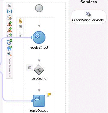

    This completes decide activity configuration. The BPEL process model is updated with the GetRating decide activity and the BPEL process is ready for deployment.
    Description of ds_dec.gif follows

  • Keep limitations of JAXB in mind (element and complex type naming, target package for multiple schemata, and so on).

  • Model a rule that does not include an if statement test pattern and set it to low priority to generate a default result in the case where no other rule starts as part of rule set execution.
  <arguments>
  </arguments>
</pattern>
you can understand the messages and operations for WSDL generation.

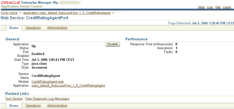

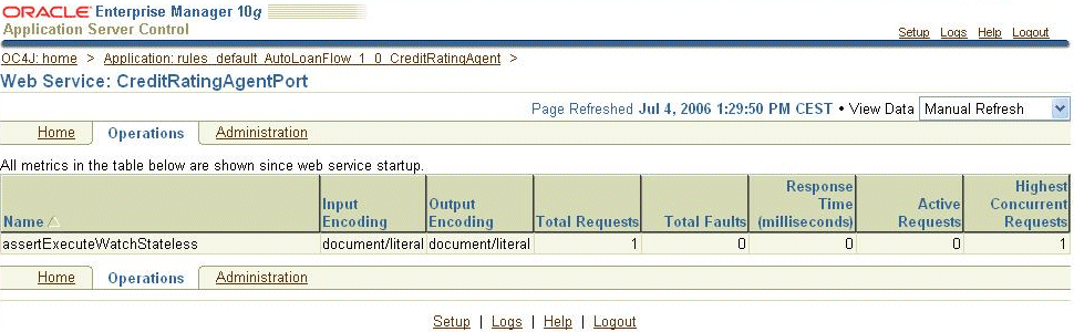

  3. Click CreditRatingAgentPort to receive more details for the CreditRatingAgent decision service:
    Description of ds_em5.gif follows
  4. Click Operations to access additional details:
    Description of ds_em7.gif follows
18.6.3.2 Oracle BPEL Control Support
You can monitor and diagnose decision services through Oracle BPEL Control. A decisionServiceDetails property is added to the BPEL suitcase that refers to the configuration information of a decision service partner link.
  1. Log into Oracle BPEL Control.
  2. Click the AutoLoanFlow BPEL process in Oracle BPEL Control.
  3. Click Descriptor.
    The Descriptor tab shows the process descriptor of the AutoLoanFlow process included with the AutoLoanDemo sample:
    Description of ds_em1.gif follows
    The process has two decision service partner links configured:
    • CreditRatingAgentPL for credit rating
    • LoanAdvisorAgentPL for loan advisory
  4. Access additional details about a decision service partner link by clicking Rule Service Details (for example, the details for CreditRatingAgentPL).
    Description of ds_em2.gif follows
    The information displayed includes the following:
    • Rule engine information
      • The backend rule engine provider (Oracle in this case)
      • The physical location of the rule repository
      • The name of the rule catalog being used for that partner link
      • (Optional) The version of the rule catalog being used
      • (Optional) The rule set used by the partner link
    • Interaction information
      • The interaction patterns used by the partner link
      • The input and output fact types used per interaction pattern

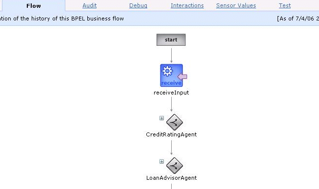

    Decide activity details are also available in the Flow window.
  6. Click the Instances tab.
  7. Click a specific instance in the Instance list.
  8. Click Flow.
  9. Click a decide activity in the process instance flow to access the same information (for this example, named LoanAdvisorAgent).
    Description of ds_em3.gif follows
    This displays the following information:
    Description of ds_em4.gif follows
                       targetNamespace="http://xmlns.oracle.com/AutoLoanFlow/CreditRatingAgent"
          <arguments>
          </arguments>
        </pattern>
      </decisionService>
    </decisionServices>

18.7.3 Customizing assertXPath
Oracle Business Rules can specify an XPath expression when asserting facts. This reduces the number of assertions and provides a convenient mechanism to assert multiple facts with a single assert statement.
This functionality is available in Oracle JDeveloper. Select Check here to assert all descendants from the top level element on the Select a Ruleset or a Function window in the Decision Service wizard. When you select this option, a default XPath "//*" is created for the fact to assert. This causes all descendants of the fact element to assert during run time.
You can customize the XPath expression manually by modifying the decision service configuration located in the following file:
JDev_Oracle_Home\jdev\mywork\application_name\
process_name\decisionservices\DecisionService\war\WEB-INF\
classes\decisionservices.xml
The following example shows this option enabled for a fact type.
<?xml version = '1.0' encoding = 'UTF-8'?>
  <ruleEngineProvider name="CreditRatingRuleRepository"
                      provider="Oracle">
      <file>repositoryresource:CreditRatingRepository</file>
    </repository>
      <arguments>
        <assert xpath="//*">creditrating.Ratingrequest</assert>
      </arguments>
    </pattern>
  </decisionService>
</decisionServices>
You can customize the attribute xpath="//*" before deploying the decision service.

18.8.1 Task 1: Update a Rule Using Oracle Business Rules Rule Author
This section describes how to access the Oracle Business Rules Rule Author and modify a business rule that you later integrate with your BPEL process.
  1. Log into the Oracle Business Rules Rule Author.
    http://hostname:port/ruleauthor
    The Oracle Business Rules Rule Author is automatically installed with the SOA Suite Basic Install type.
  2. Log in as oc4jadmin/password.
    where password is the oc4jadmin password you entered during installation.
  3. Click the Repository tab at the top.
  4. Select File from the Repository Type list.
  5. Click Browse and select the CreditRatingRepository file repository from the SOA_Oracle_Home\bpel\samples\demos\AutoLoanDemo\repository directory.
    This page displays the following details:
    Description of ds_rules1.gif follows
  6. Click Connect.
    A message displays indicating that a connection has been made to the repository.
  7. Click the Customization tab at the top.
  8. Enter the following details to load the rule dictionary and its versions from the repository selected in Step 5:
    Field Value
    Existing Dictionaries RatingFY06
    Version Approved_060205
    Description of ds_rules2.gif follows
  9. Click Load.
    A confirmation message appears:
    Dictionary 'RatingFY06 (Approved_060205)' has been loaded

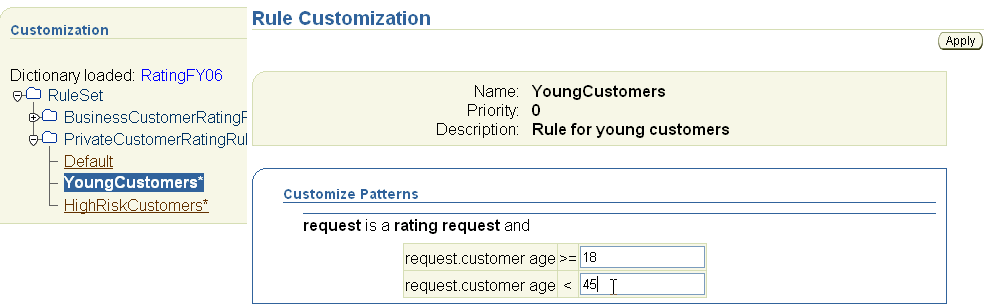

  10. Click the Customization tab at the top. You now modify a rule in the rule set.
  11. Click the YoungCustomers rule and change request.customer age < from 40 to 45.
    Description of ds_rules3.gif follows
  12. Click Apply.
    A message displays indicating that the customization has been applied.
  13. Click the HighRiskCustomers rule and change request.customer age >= from 40 to 45.
  14. Click Apply.
  15. Click Save Dictionary at the top.
  16. Click Save.
    This saves the current dictionary contents (including your updates) in the CreditRatingRepository repository.
  17. Click Logout.
18.8.2 Task 2: Create a Connection to the Business Rule Repository
This section describes how to create a connection to the business rule repository.
  4. Enter CreditRatingRuleRepository in the Connection Name field.
  5. Select Oracle Rules Engine File Repository as the type of business rule engine to which to connect.
  6. Click Next.
  7. Click the folder icon to select the directory in which the file repository is located.
  8. Select the CreditRatingRepository file repository from the SOA_Oracle_Home\bpel\samples\demos\AutoLoanDemo\repository directory. This is the repository you loaded in Step 5.
  9. Click Open.
  10. Click Next.
  11. Click Test.
    Success
  12. Click Finish.

18.8.4 Task 4: Create a Decision Service Partner Link
You now use the Decision Service Wizard to connect to the business rule engine and convert the rule set you modified in "Task 1: Update a Rule Using Oracle Business Rules Rule Author" into a Web service to use in the BPEL process. When complete, a decision service partner link is created.
    Field Value
    Service Name CreditRatingAgent
    Namespace http://xmlns.oracle.com/myLoanProcess/CreditRatingAgent
    The window now appears as follows:
    Description of ds_create.gif follows
    This window enables you to browse and select the rule set in the dictionary of the repository you modified in "Task 1: Update a Rule Using Oracle Business Rules Rule Author".
  5. Click Show All Versions at the bottom of the window to display all catalog versions of rule dictionaries in the specified repository. Business rule repositories can contain multiple rule dictionaries and versions.
  6. Expand and select CreditRatingRuleRepository > RatingFY06 > Approved_060205 > PrivateCustomerRatingRules.
  7. Click OK.
    You are returned to the Select a Ruleset or a Function window of the Decision Service wizard. Note that all fact names for the PrivateCustomerRatingRules rule set now appear in the fact table.
  8. Select the input (Assert Fact) and output (Watch Fact) fact types:
      This asserts a fact to the rule set (sends factual data to the business rule engine).
      This returns results from the rule set. This table column only appears because you selected an invocation pattern that retrieves results in Step 3.
  9. Click Next.
    This window shows the schema file for the wizard to import.
    Description of ds_pl.gif follows

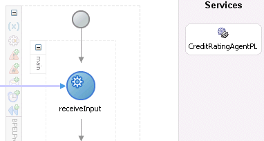

18.8.5 Task 5: Create a Decide Activity
You now create a decide activity to invoke the decision service partner link you created with the Decision Service wizard. The decide activity enables you to create copy operation assignments between the fact types in your rule set (now included in the partner link) and BPEL variables. You provide an input fact to the rule set and then retrieve the results. This enables you to invoke rules from the BPEL process.When complete, a decide activity consisting of assign and invoke activities to the decision service partner link is created.
  1. Drag and drop a Decide activity below the receiveInput receive activity in the designer window.
    Field Value
    Name GetCreditRating
    Decision Service CreditRatingAgent
  4. Click Create.
    Field Value
    From
    • Type
    Variable
    • Variables
    Expand and select Variables > inputVariable > payload > ns1:loanApplication > ns1:SSN
    To
    • Type
    Variable
    • Variables
    Expand and select Variables > creditrating_Ratingrequest_i > ns3:ratingrequest > ns3:SSN
    Description of ds_assign.gif follows
  6. Click OK.
  7. Click Create again to create a second copy operation.
    Field Value
    From
    • Type
    Variable
    • Variables
    Expand and select Variables > inputVariable > payload > ns1:loanApplication > ns1:customerName
    To
    • Type
    Variable
    • Variables
    Expand and select Variables > creditrating_Ratingrequest_i > ns3:ratingrequest > ns3:name
  9. Click OK.
  10. Click Create again to create a third copy operation.
  11. Enter the following details:
    Field Value
    From
    • Type
    Variable
    • Variables
    Expand and select Variables > inputVariable > payload > ns1:loanApplication > ns1:loanAmount
    To
    • Type
    Variable
    • Variables
    Expand and select Variables > creditrating_Ratingrequest_i > ns3:ratingrequest > ns3:amount
  12. Click Apply.
    The Edit Decide window displays the following input fact mappings:
    Description of ds_decide.gif follows
  13. Click Assign Output Facts.
    You now map the automatically created BPEL variables that correspond to the Rating output fact type to BPEL input variables.
  14. Click Create.
  15. Enter the following details to create the output facts:
    Field Value
    From
    • Type
    Variable
    • Variables
    Expand and select Variables > creditrating_Rating_o > ns2:rating > ns2:rating
    To
    • Type
    Variable
    • Variables
    Expand and select Variables > inputVariable > payload > ns3:loanApplication > ns3:creditRating
    Description of ds_assign1.gif follows
  16. Click OK.
  17. Click Create again to create a second copy operation.
  18. Enter the following details:
    Field Value
    From
    • Type
    Variable
    • Variables
    Expand and select Variables > creditrating_Rating_o > ns2:rating > ns2:risk
    To
    • Type
    Variable
    • Variables
    Expand and select Variables > inputVariable > payload > ns3:loanApplication > ns3:creditRisk
  19. Click OK.
  20. Click Create again to create a third copy operation.
  21. Enter the following details:
    Field Value
    From
    • Type
    Variable
    • Variables
    Expand and select Variables > creditrating_Rating_o > ns2:rating > ns2:maxAmount
    To
    • Type
    Variable
    • Variables
    Expand and select Variables > inputVariable > payload > ns3:loanApplication > ns3:creditMaxAmount
  22. Click OK.
    The Edit Decide window displays the following output fact mappings:
    Description of ds_decide2.gif follows
  23. Click OK.
    Description of ds_finish.gif follows
  24. Click the + sign to expand the GetCreditRating decide activity and view the assign and invoke activities.
    The BPEL process is now integrated with the business rules of the business rule engine. If you later modify the contents of the business rule, you do not need to redesign your BPEL process.
