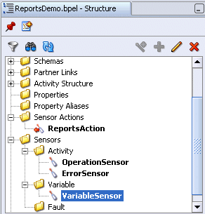

In Oracle JDeveloper, sensor actions and sensors are displayed as part of the process tree structure, as shown in Figure 17-1.
Figure 17-1 Sensors and Sensor Actions Displayed in Oracle JDeveloper
Description of sensor1.gif follows

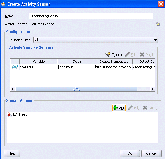

If you are monitoring the LoanFlow application, you may want to know when the getCreditRating scope is initiated, when it is completed, and, at completion, what the credit rating for the customer is. The solution is to create an activity sensor for the getCreditRating scope in Oracle JDeveloper, as shown in Figure 17-2. Activities that have sensors associated with them are identified with a magnifying glass in Oracle JDeveloper.
Figure 17-2 Creating an Activity Sensor
Description of sensor2.gif follows
The Evaluation Time attribute shown in Figure 17-2 controls the point at which the sensor fires. You can select from the following:
  • Activation—The sensor fires just before the activity is executed.
  • Completion—The sensor fires just after the activity is executed.
  • Fault—The sensor fires if a fault occurs during the execution of the activity. Select this value only for sensors that monitor simple activities.
  • Compensation—The sensor fires when the associated scope activity is compensated. Select this value only for sensors that monitor scopes.
  • Retry—The sensor fires when the associated invoke activity is retried.
  • All—Monitoring occurs during all of the preceding phases.
A new entry is created in the sensor.xml file, as follows:

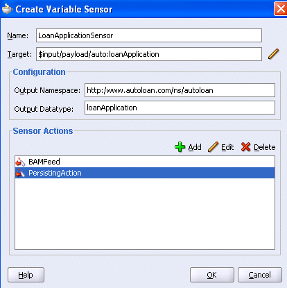

If you want to record all the incoming loan requests, create a variable sensor for the variable input, as shown in Figure 17-3.
Figure 17-3 Creating a Variable Sensor
Description of sensor3.gif follows
<sensor sensorName="LoanApplicationSensor"
    classname="oracle.tip.pc.services.reports.dca.agents.BpelVariableSensorAgent"
    kind="variable"
    target="$input/payload">
  <variableConfig outputNamespace="http://www.autoloan.com/ns/autoloan"
                  outputDataType="loanApplication"/>
</sensor>

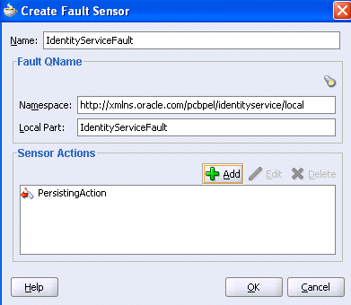

If you want to monitor faults from the identity service, create a fault sensor, as shown in Figure 17-4.
Figure 17-4 Creating a Fault Sensor
Description of sensor4.gif follows
<sensor sensorName="IdentityServiceFault"
        classname="oracle.tip.pc.services.reports.dca.agents.BpelFaultSensorAgent"
        kind="fault"
        target="is:identityServiceFault">
    <faultConfig/>
</sensor>

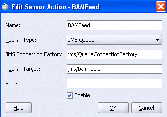

A new entry is created in the sensorAction.xml file, as follows:
<action name="BAMFeed"
        enabled="true"
        publishType="JMSQueue"
        publishTarget="jms/bamTopic">
  <sensorName>LoanApplicationSensor</sensorName>
  <property name=ÒJMSConnectionFactoryÒ>
    jms/QueueConnectionFactory
  </property>
</action>

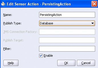

<action name="PersistingAction"
     enabled="true"
     publishType="BPELReportsSchema">
  <sensorName>CreditRatingSensor</sensorName>
</action
The data of one sensor can be published to multiple endpoints. In the two preceding code samples, the data of LoanApplicationSensor is published to a JMS queue and to the reports schema in the database.

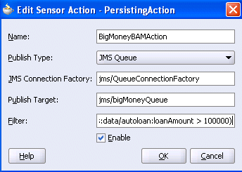

If you want to monitor loan requests for which the loan amount is greater than $100,000, you can create a sensor action with a filter, as shown in Figure 17-7.
Figure 17-7 Creating a Sensor Action with a Filter
Description of sensor_fltr.gif follows
<action name="BigMoneyBAMAction"
        enabled='true'
        filter="boolean(/s:actionData/s:payload
                        /s:variableData/s:data
                        /autoloan:loanAmount > 100000)"
        publishTarget="jms/bigMoneyQueue">
  </property>
</action>

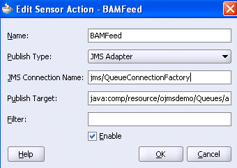

The JMS Queue and JMS Topic publish types only publish to local JMS destinations. If you want to publish sensor data to remote topics and queues, use the JMS adapter publish type, as shown in Figure 17-9.
Figure 17-9 Using the JMS Adapter Publish Type
Description of sensor7.gif follows
In addition to enabling you to publish sensor data to remote topics and queues, the JMS adapter supports a variety of different JMS providers, including:
  • Third-party JMS providers such as Tibco JMS, IBM WebSphere MQ JMS, and SonicMQ
  • Oracle Enterprise Messaging Service (OEMS) providers such as memory/file and database
If you select the JMS Adapter publish type, you must create an entry in the oc4j-ra.xml file. Use the JMS connection name property in the Sensor Actions dialog to point to the proper entry in the oc4j-ra.xml file.

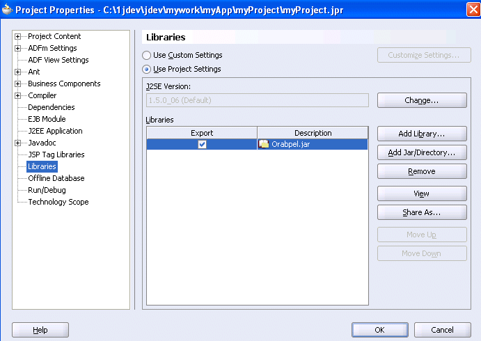

To create a custom data publisher, double-click your BPEL project in Oracle JDeveloper and do the following:
  1. Select Project Properties > Libraries > Add Jar/Directory from the Tools main menu.
  2. Browse and select SOA_Oracle_Home\bpel\lib\orabpel.jar.
    Adding a BPEL library to a BPEL project

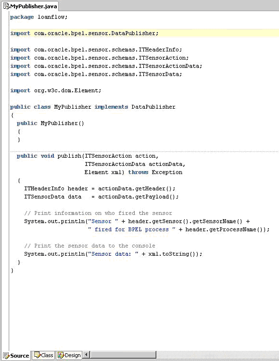

  5. Using the Oracle JDeveloper editor, implement the publish method of the DataPublisher interface, as shown in the following sample custom data publisher class.
    Sample custom data publisher class

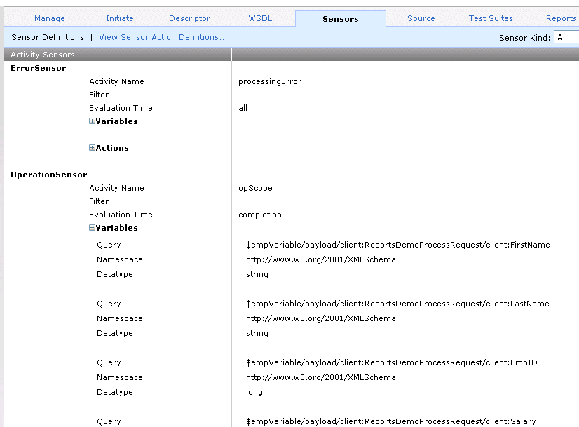

Figure 17-10 Sensor Data on the BPEL Processes Tab of Oracle BPEL Control
Description of sensor_console1.gif follows

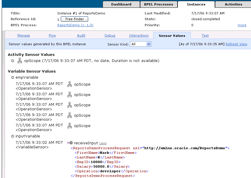

17.4.2 Viewing Sensor Data
The console provides support to monitor sensors for which a BpelReportsSchema sensor action is defined. In Oracle BPEL Control, click the Instances tab and choose the process instance for which you want to see the sensor data created as the result of process execution. A page similar to Figure 17-11 is displayed.
Figure 17-11 Sensor Data on the Instances Tab of Oracle BPEL Control
Description of sensor_console2.gif follows
Only sensors associated with a database sensor action are displayed in Oracle BPEL Control. Sensors associated with a JMS queue, JMS topic, or custom sensor action are not displayed.

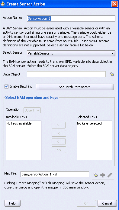

Oracle Business Activity Monitoring (BAM) enables you to monitor business services and processes in an enterprise, correlate key performance indicators (KPIs), and change business processes or take corrective actions if the business environment changes. Oracle BAM enables you to build real-time operational dashboards and monitoring and alerting applications over the Web. Using this technology, you build interactive, real-time dashboards and proactive alerts to monitor business services and processes.
You can create sensor actions in Oracle BPEL Process Manager to publish sensor data as data objects on an Oracle BAM Server. When you create the sensor action, you can select an Oracle BPEL Process Manager variable or activity sensor that you want to monitor and the data object in Oracle BAM Server in which you want to publish the sensor data. Oracle BAM Server publishes the data objects and types information in WSDL files. It uses basic HTTP authentication to enable access to these files.

17.5.3 Creating a BAM Sensor Action
When you create the sensor action, you select the BPEL variable or activity sensor that you want to monitor and the data object in Oracle BAM Server in which you want to publish the sensor data.
  1. Right click Sensor Actions in the Structure section of Oracle JDeveloper.
  2. Select Create > BAM Sensor Action.
    The Create Sensor Action window appears. You create BAM sensor actions to publish sensor data to data objects on Oracle BAM Server.
    Description of sensors_bam.gif follows
  3. Enter the following details:
    Field Description
    Action Name Enter a unique and recognizable name for the sensor action.
    Select Sensor Select a BPEL sensor to monitor. This is the sensor that you created in "Creating a Sensor" for mapping sensor data to a data object in Oracle BAM Server.
    Data Object Click the flashlight icon to open the BAM Data Object Chooser window to select the data object in Oracle BAM Server in which you want to publish the sensor data. You must have already created a connection to Oracle BAM Server in order to select data objects.
    Enable Batching The data cached by default by the Oracle BAM component of the Oracle BPEL Process Manager run time is flushed (sent) to Oracle BAM Server periodically. The decision to periodically send the data is based on upper and lower limit parameter settings on the Set Batch Parameters window. The Oracle BAM component may decide to send data prior to a batch timeout if the cache has a number of data objects between the lower and upper limit values. Disable batching by unselecting this check box.
    To modify the batch parameters, click Set Batch Parameters. See Step 4 for additional details.
    Operation Select to Delete, Update, Insert, or Upsert a row in the Oracle BAM Server database. Upsert first attempts to update a row if it exists. If the row does not exit, it is inserted.
    Available Keys/Selected Keys If you selected the Delete, Update, or Upsert operation, you must also select a column name in the Oracle BAM server database to use as a key to determine the row with which this sensor object corresponds. A key can be a single column or a composite key consisting of multiple columns. Select a key and click the > button. To select all, click the >> button.
    Map File Provide a file name to create a mapping between the sensor (selected in the Select Sensor list) and the Oracle BAM Server data object (selected in the Data Object list). You can also invoke a mapper window by clicking the Create Mapping icon (second icon) or Edit Mapping icon (third icon).
    WARNING:
    If you restart Oracle BPEL Server, any messages currently being batched are lost. Ensure that all messages have completed batching before restarting Oracle BPEL Server.
    Notes:
    After you click the Create Mapping or Edit Mapping or OK button on the Create Sensor Action window, you must explicitly save the BPEL file.
  4. If you want to specify custom batch parameter settings, click Set Batch Parameters.
    The Set Batch Parameters window appears.
  5. Deselect the Use Default Batch Parameters check box and provide customized values in the fields below. If you provide customized values and then select this check box again, the settings revert to the default values.
    Description of sensors_bambatch.gif follows
  6. Enter the following details:
    Field Description
    Batch size lower limit Use the default value of 1000 or specify a lower batch limit. This parameter controls the minimum number of rows in the cache. With this parameter, the data remains in the Oracle BPEL Process Manager run-time cache until the queue size reaches at least this limit or a timeout occurs.
    Batch size upper limit Use the default value of 5000 or specify an upper batch limit. This parameter controls the maximum number of rows in the cache. With this parameter, the Oracle BPEL Process Manager run time flushes the data to Oracle BAM Server prior to the upper limit being reached.
    Batch timeout (milliseconds) Specify the timeout in minutes. The default value is 50 milliseconds. When the timeout occurs, the BPEL run time flushes any data in the queue to Oracle BAM Server.
  7. Click OK to close the Set Batch Parameters window and the Create Sensor Action window.
