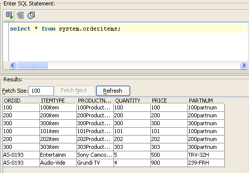

10.2.2.3 Testing the Database Connection
  1. Select Connection Navigator from the View main menu.
  2. Expand Database.
  3. Right-click myConnection and select SQL Worksheet.
  4. Enter SELECT * FROM system.orders; in the Enter SQL Statement field.
  5. Right-click the statement and select Execute SQL Statement.
    The sample table created with data appears in the Results field.

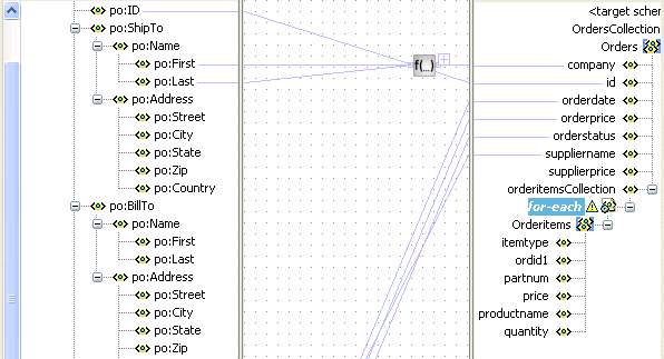

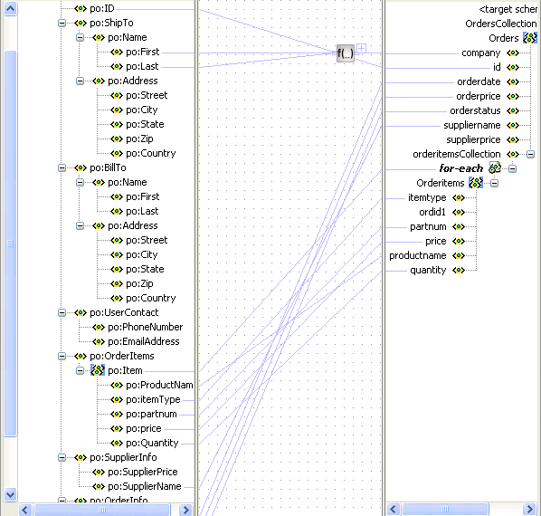

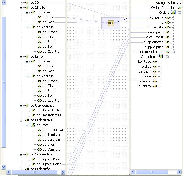

    A transformation window for graphically mapping source and target elements appears. This window enables you to drag (map) a source element to a target element. If you instead receive a message saying the file already exists, click the third icon to access the transformation window.
  10. Right-click the source and target schemas (the top-most elements in both lists) and select Expand All.
  11. Drag and drop the following source elements to the following target elements:
    Source Target
    po:ID id
    po:SupplierName suppliername
    po:SupplierPrice supplierprice
    po:OrderDate orderdate
    po:OrderPrice orderprice
    po:OrderStatus orderstatus
  12. Select String Functions from the Component Palette section.
  13. Drag and drop a concat function into the middle of the transformation window.
  14. Go to the po:ShipTo source section.
  15. Go to the po:Name subelement of this section.
  16. Drag the po:First and po:Last source subelements into the concat function. This connects two source lines to the concat function.
  17. Go to the Orders target section.
  18. Drag the company target subelement into the concat function. This connects the target line to the concat function and concatenates the first and last names from the source elements into a single name in the target element.
    Description of obph9trans3.gif follows
  19. Right-click the target Orderitems and select Add XSL Node > for-each.
    The for-each node appears between orderitemsCollection and OrderItems in the target schema.
    Description of obph9trans4.gif follows
  20. Drag and drop the source po:OrderItems:Item onto the for-each node. This creates a 1:M relationship.
  21. Drag and drop the source po:OrderItems:Item onto the target Orderitems.
  22. Click OK when prompted to confirm your mapping. This creates an automatic mapping of all matching subelements.
    Description of obph9trans6.gif follows
  23. Select Save from the File main menu.
10.2.6 Testing the Transformation Logic
  1. Right-click in the transformation mapping window and select Test.
    This displays the Test XSL Map window.
  2. Ensure that Generate Source XML Data is selected.
    This creates sample XML test data.
  3. Accept all other default settings, and click OK.
    Sample test results appear. The source XML and target XML display data side-by-side, with the XSL map data underneath. This is the default layout of test results.
  4. Verify the results.
  5. Select Save from the File main menu.
  6. Click Yes if prompted to save your transformation details.
  7. Close the Transformation_1-Source.xml, Transformation_1-Target.xml, and Transformation_1.xsl files by clicking the x button for each in the Title tab.
    Description of obph9trans7.gif follows
    A translation file named Transformation_1.xsl appears under POAcknowledge > Integration Content in the Application Navigator section.

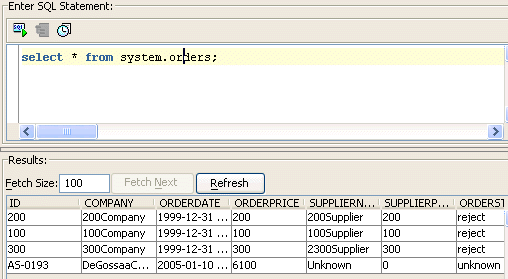

10.2.9 Verifying the Process
  1. Return to Oracle JDeveloper.
  2. Select Connection Navigator from the View main menu.
  3. Expand Database.
  4. Right-click myConnection and select SQL Worksheet. Note that right clicking on the connection name fails if the case of the connection name is incorrect.
  5. Right-click the SQL statement you entered in Step 4 and select Execute SQL Statement (for example, SELECT * FROM system.orders;) or manually enter SELECT * FROM orderitems WHERE ordid = 'your_order_number'.
    This verifies that the database table is properly inserted.
    Description of obph9dbout.gif follows

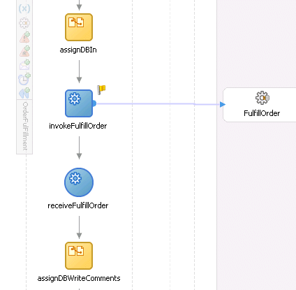

10.2.10.3 Creating Invoke and Receive Activities
Summary:
You now create Invoke and Receive activities.
  1. Drag and drop an Invoke activity from the Component Palette section into the OrderFulFillment Scope activity.
  2. Double-click the Invoke icon to display the Invoke window.
  3. Enter the following details:
    Field Value
    Name invokeFulfillOrder
    Partner Link FulfillOrder
    The Operation (initiate) field is automatically filled in.
  4. Click the first icon to the right of the Input Variable field. This is the automatic variable creation icon.
  5. Click OK on the Create Variable window that appears.
    A variable named invokeFulfillOrder_initiate_InputVariable is automatically created in the Input Variable field. This variable is automatically assigned a message type of FulfillOrderRequestMessage.
  6. Click OK.
  7. Drag and drop a Receive activity from the Component Palette section to below the invokeFulfillOrder Invoke activity inside the OrderFulFillment Scope activity.
  8. Double-click the Receive icon to display the Receive window.
  9. Enter the following details:
    Field Value
    Name receiveFulfillOrder
    The Operation (onResult) field is automatically filled in.
  10. Click the first icon to the right of the Variable field. This is the automatic variable creation icon.
  11. Click OK on the Create Variable window that appears.
    A variable named receiveFulfillOrder_onResult_InputVariable is automatically created in the Output Variable field. This variable is automatically assigned a message type of FulfillOrderResponseMessage.
  12. Click OK.
  13. Select Save from the File main menu.

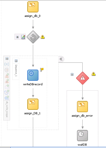

10.2.10.6 Adding Database Exception Handling
Summary:
You perform database exception handling tasks in the FulFillOrder process by creating a local variable and placing the writeDBRecord Invoke activity in a Scope activity. The local variable is set to false (represented by 0). You attempt to call the external partner service in a While loop activity until the local variable is satisfied (set to 1). The While activity is set to loop a maximum of five times. In the case of an exception, you reset the flag to false (0).
  1. Ensure that you are in the FulFillOrder process. If not, double-click FulFillOrder.bpel in the Application Navigator section of the designer window.
  2. Drag and drop a Scope activity from the Component Palette section to below the transformDBRecord Transform activity.
  3. Double-click the Scope icon to display the Scope window.
  4. Enter db_write_scope in the Name field of the General tab.
  5. Click OK.
  6. Click the + sign to expand the Scope activity.
  7. Drag and drop the writeDBrecord Invoke activity into the db_write_scope Scope activity.
  8. Click Add Catch All Branch in the icons on the left side of db_write_scope.
    Description of obph9catchall.gif follows
  9. Click the + sign to expand the new branch.
    A new box displays to the right with an asterisk and the words Drop Activity Here.
  10. Select Variables > Process > Variables in the Structure section.
  11. Right-click Variables and select Create Variable.
  12. Enter dbStatus in the Name field.
  13. Select Simple Type and click the flashlight icon to the right of the Simple Type field.
  14. Select int.
  15. Click OK to close the Type Chooser window and the Create Variable window.
  16. Drag and drop an Assign activity from the Component Palette section to above the db_write_scope Scope activity.
  17. Double-click the Assign icon to display the Assign window.
  18. Click the General tab.
  19. Enter assign_db_0 in the Name field.
  20. Click Apply.
  21. Click the Copy Operation tab.
  22. Click Create and select Copy Operation to display the Create Copy Operation window.
  23. Enter the following values:
    Field Value
    From
    • Type
    Expression
    • Expression
    '0'
    To
    • Type
    Variable
    • Variables
    Expand and select Variables > dbStatus
  24. Click OK to close the Create Copy Operation window and the Assign window.
  25. Drag and drop another Assign activity from the Component Palette section to below the writeDBrecord Invoke activity inside the db_write_scope Scope activity.
  26. Double-click the Assign icon to display the Assign window.
  27. Click the General tab.
  28. Enter assign_db_1 in the Name field.
  29. Click Apply.
  30. Click the Copy Operation tab.
  31. Click Create and select Copy Operation to display the Create Copy Operation window.
  32. Enter the following values:
    Field Value
    From
    • Type
    Expression
    • Expression
    '10'
    To
    • Type
    Variable
    • Variables
  33. Click OK to close the Create Copy Operation window and the Assign window.
  34. Drag and drop a third Assign activity from the Component Palette section into the Catch All branch on the right side of the db_write_scope Scope activity.
  35. Double-click the Assign icon to display the Assign window.
  36. Enter assign_db_error in the Name field of the General tab.
  37. Click Apply.
  38. Click the Copy Operation tab.
  39. Click Create and select Copy Operation to display the Create Copy Operation window.
  40. Enter the following values:
    Field Value
    From
    • Type
    Expression
    • Expression
    bpws:getVariableData('dbStatus') + 1
    To
    • Type
    Variable
    • Variables
  41. Click OK to close the Create Copy Operation window and the Assign window.
  42. Drag and drop a Wait activity from the Component Palette section into the Catch branch below the assign_db_error Assign activity.
  43. Double-click the Wait activity to display the Wait window.
  44. Enter waitDB in the Name field.
  45. Set the value to 30 seconds in the HH:mm:ss field. This means this block is retried every 30 seconds until the FulFillOrder process is successful (that is, dbStatus is 1).
  46. Click OK.
  47. Drag and drop a While activity from the Component Palette section to immediately above the db_write_scope Scope activity.
    The designer window looks as follows:
    Description of obph9except.gif follows
  48. Click the - sign to close the db_write_scope Scope activity.
  49. Expand the While activity.
  50. Drag the db_write_scope Scope activity inside the While activity.
  51. Double-click the While activity and press Ctrl and then the space bar to enter the following in the Expression field:
    bpws:getVariableData('dbStatus') < 5
  52. Click OK.

  20. Right-click myConnection and select SQL Worksheet.
  21. Enter the statement SELECT * FROM system.orderitems; and right-click and select Execute SQL Statement to see your orders persisted in the database.
    Description of obph9dbitems.gif follows
