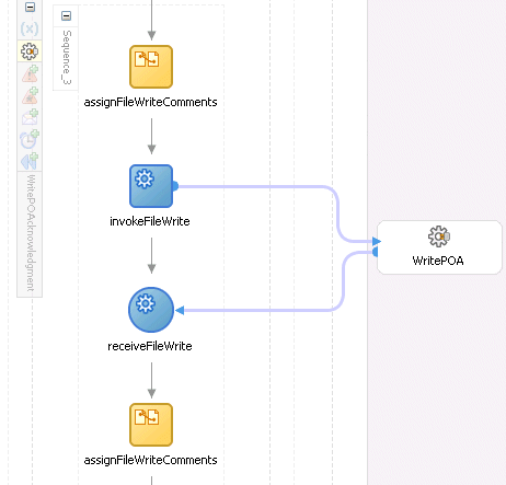

Summary: You now create Invoke and Receive activities. The Invoke activity provide an initiate operation that sends input data. The Receive activity provides a callback interface to receive data after the external service is processed. |
Drag and drop an Invoke activity from the Component Palette section to inside the WritePOAcknowledgment Scope activity.
Double-click the Invoke icon to display the Invoke window.
Enter the following details:
| Field | Value |
| Name | invokeFileWrite |
| Partner Link | WritePOA |
The Operation (initiate) field is automatically filled in.
Click the first icon to the right of the Input Variable field. This is the automatic variable creation icon.
Click OK on the Create Variable window that appears.
A variable named invokeFileWrite_initiate_InputVariable is automatically created in the Input Variable field. This variable is automatically assigned a message type of POAcknowledgeRequestMessage.
Click OK.
Drag and drop a Receive activity from the Component Palette section to below the invokeFileWrite Invoke activity inside the WritePOAcknowledgment Scope activity.
Double-click the Receive icon to display the Receive window.
| Field | Value |
| Name | receiveFileWrite |
The Operation (onResult) field is automatically filled in.
Click the first icon to the right of the Variable field. This is the automatic variable creation icon.
A variable named receiveFileWrite_onResult_InputVariable is automatically created in the Output Variable field. This variable is automatically assigned a message type of POAcknowledgeResponseMessage.
Click OK.
Select Save from the File main menu.

When complete, the designer window looks as follows:

You have now added write functionality to the file adapter to accept input data in the form of a purchase order. This input data was transformed into a purchase order acknowledgment and the results were written to a file. You performed the following key tasks:
Returned to the POAcknowledge BPEL process and created a partner link (named FileOutInbound) that used the file adapter to write files to a directory (in this case, an outgoing purchase order acknowledgment).
Designed POAcknowledge to invoke FileOutInbound.
Deployed POAcknowledge.
Returned to the OrderBooking BPEL process and created a partner link (named WritePOA) that interacted with POAcknowledge.
Designed OrderBooking to invoke WritePOA.
Deployed the OrderBooking BPEL process.
Ran OrderBooking from Oracle BPEL Control by completing and submitting an order form to the Rapid Distributors and Select Manufacturing services.
Copied the purchase order file to be read to a directory.
Accessed the Rapid Distributors URL to manually submit a supplier price.
Observed that the purchase order file was deleted and a purchase order acknowledgment file was written to the directory. Observed that the contents of the incoming purchase order file were transformed into an outgoing purchase order acknowledgment.
