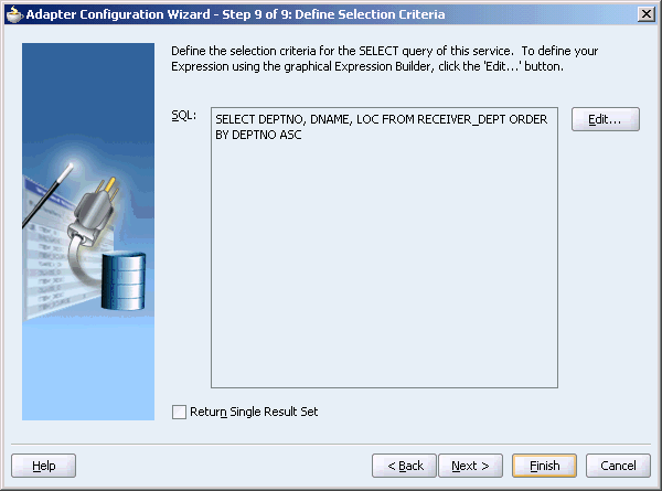

Configuration
For example, assume that you have imported Movies and MovieReviews, with a 1-M attribute on Movies called movieReviewsCollection. The following are the steps to configure this:

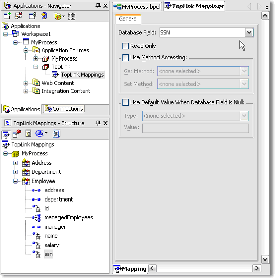

In the BPEL project, choose Application sources, and then click TopLink.
In the Structure panel, click Movies, and then double-click movieReviewsCollection.
A view containing the check box, Use Batch Reading is displayed. By default, his box is enabled. You must deselect the check box to disable batch attribute reading (altering the SQL).
For a 1-1 relationship may also see the option, Use Joining below the option, Use Batch Reading. This is similar to returning a single result set and the following is a list of a few key differences:
The setting is on a per attribute basis, not a per query/wsdl operation basis.
This setting is available only for 1-1 attributes.
This setting does an inner join, that is, if there is a Master without a Detail, then that Master will be filtered out of the original select statement.

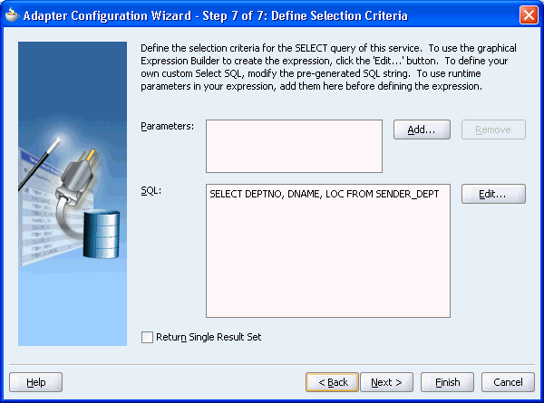

To configure returning a single result set, edit your wsdl and for each jca operation of type DBActivationSpec or DBReadInteractionSpec, add the property ReturnSingleResultSet="true", as shown in the following example:
<operation name="SelectAllByTitleServiceSelect_title">
<jca:operation
InteractionSpec="oracle.tip.adapter.db.DBReadInteractionSpec"
DescriptorName="SelectAllByTitle.Movies"
QueryName="SelectAllByTitleServiceSelect"
MappingsMetaDataURL="toplink_mappings.xml" />
<input/>
</operation>
This setting will override altering the original select (batch attribute reading) statement.

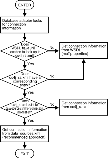

The database adapter is a separate JCA 1.5 connector. It is deployed to the application server during installation, and is configured using oc4j-ra.xml. The oc4j-ra.xml file is the database adapter deployment descriptor file for Oracle Application Server.
Each entry in oc4j-ra.xml has a Java Naming and Directory Interface (JNDI) name (location) and session and login properties, and represents a single database and database adapter instance. The connector is tied to the application server; therefore, it can be used independently, but any change to oc4j-ra.xml requires restarting the application server. This file is created by the application server the first time Oracle BPEL Server comes up. Therefore, in a standalone installation, you do not see this file unless you start Oracle BPEL Server at least once.
When a business process is executed in Oracle BPEL Process Manager, a Web service (WSDL) may be invoked (using WSIF) against the database. The jca:address tag in the WSDL is used to look up an adapter instance, and the jca:operation tag in the WSDL is used to set up an interaction (outbound) or activation (inbound) with the database adapter using a JCA interface. The jca:operation tag contains a link to TopLink metadata for executing a query to push XML data to a relational schema, or vice versa.
The toplink_mappings.xml file and WSDL (with custom jca:operation and jca:address tags) are created during design time. In JDeveloper BPEL Designer, you create an endpoint, or partner link, for interacting with the database. Each partner link has its own WSDL. The WSDL defines all the operations (queries) that can be performed with that database.

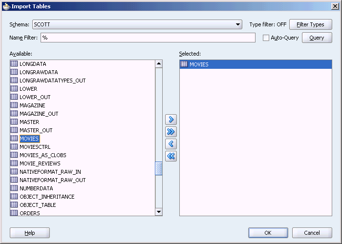

For a flat table or schema, the relational-to-XML mapping is easy to see. Each row in the table becomes a complex XML element. The value for each column becomes a text node in the XML element. Both column values and text elements are primitive types.
Table 4-1 shows the structure of the MOVIES table. This table is used in the use cases described in this chapter. See Database Adapter Use Case for Oracle BPEL Process Manager for more information.
Table 4-1 MOVIES Table Description
| Name | Null? | Type |
NOT NULL |
The corresponding XML schema definition (XSD) is as follows:

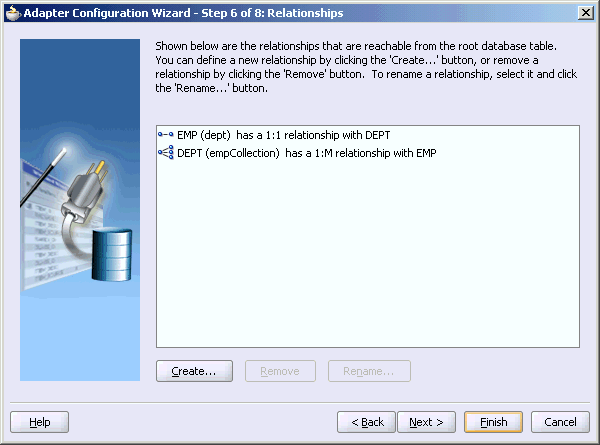

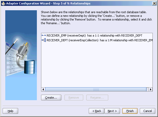

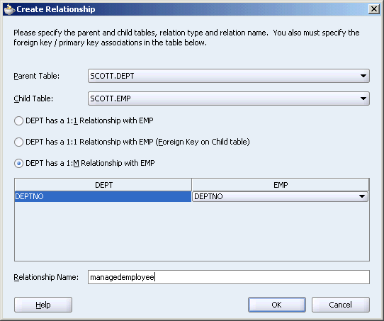

As the preceding table definitions show, and as is typical of a normalized relational schema, an employee's department number is not stored in the EMP table. Instead, one of the columns of EMP (DEPTNO) is a foreign key, which equals the primary key (DEPTNO) in DEPT.
However, the XML equivalent has no similar notion of primary keys and foreign keys. Consequently, in the resulting XML, the same data is represented in a hierarchy, thereby preserving the relationships by capturing the detail record inline (embedded) inside the master.
An XML element can contain elements that are either a primitive type (string, decimal), or a complex type, that is, another XML element. Therefore, an employee element can contain a department element.
The corresponding XML shows how the relationship is materialized, or shown inline. DEPTNO is removed from EMP, and instead you see the DEPT itself.
<EmpCollection>
<Emp>
<comm xsi:nil = "true" ></comm>
<empno >7369.0</empno>
<ename >SMITH</ename>
<hiredate >1980-12-17T00:00:00.000-08:00</hiredate>
<job >CLERK</job>
<mgr >7902.0</mgr
<sal >800.0</sal>
<dept>
<deptno >20.0</deptno>
<dname >RESEARCH</dname>
<loc >DALLAS</loc>
</dept>
</Emp>
</EmpCollection>
Materializing the relationship makes XML human readable, and allows the data to be sent as one packet of information. No cycles are allowed in the XML; therefore, an element cannot contain itself. This is handled automatically by the database adapter. However, you may see duplication (that is, the same XML detail record appearing more than once under different master records). For example, if a query returned two employees, both of whom work in the same department, then, in the returned XML, you see the same DEPT record inline in both the EMP records.
Therefore, when you import tables and map them as XML, it is recommended that you avoid excessive duplication, although the database adapter does not print an element inside itself. The database adapter prints the following:
<Emp>
<name>Bob</name>
<spouse>
<name>June</name>
</spouse
</Emp>
But not:
<Emp>
<name>Bob</name>
<spouse>
<name>June</name>
<spouse>
<name>Bob</name>
<spouse>
</spouse>
</spouse>
</spouse>
</Emp>
To avoid duplication, you can do the following:

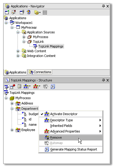

Import fewer tables. If you import only EMP, then DEPT does not appear.
Remove the relationship between EMP and DEPT in the wizard. This removes the relationship, but the foreign key column is put back.
In both these cases, the corresponding XML is as follows:
<EmpCollection>
<Emp>
<job >CLERK</job>
<mgr >7902.0</mgr>
<sal >800.0</sal>
</Emp>
</EmpCollection>
Note that one of the two preceding solutions is feasible only if getting back the foreign key suffices, as opposed to getting back the complete detail record in its entirety.

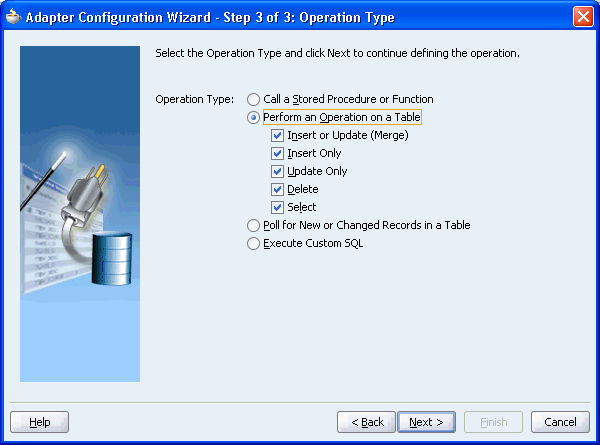

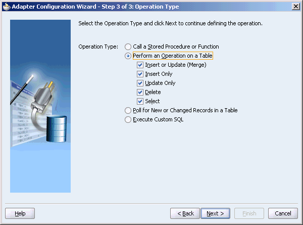

Data manipulation language (DML) operations align with basic SQL INSERT, UPDATE, and SELECT operations. SQL INSERT, UPDATE, DELETE, and SELECT are all mapped to Web service operations of the same name. The WRITE is either an INSERT or UPDATE, based on the results of an existence check. A distinction is made between the data manipulation operations—called outbound writes—and the SELECT operations—called outbound reads. The connection between the Web service and the SQL for merge (the default for outbound write) and queryByExample are not as obvious as for basic SQL INSERT, UPDATE, and SELECT.
This section comprises the following topics:
Merge first reads the corresponding records in the database, calculates any changes, and then performs a minimal update. INSERT, UPDATE, and WRITE make the most sense when you are thinking about a single row and a single table. However, your XML can contain complex types and map to multiple rows on multiple tables. Imagine a DEPT with many EMPS, each with an ADDRESS. In this case, you must calculate which of possibly many rows have changed and which to insert, update, or delete. If a particular row did not change or only one field changed, the DML calls will be minimal.
Unlike the SELECT operation, queryByExample does not require a selection criteria to be specified at design time. Instead, for each invoke, a selection criteria is inferred from an exemplar input XML record.
For instance, if the output xmlRecord is an employee record, and the input is a sample xmlRecord with lastName = "Smith", then on execution, all employees with a last name of Smith are returned.
A subset of queryByExample is to query by primary key, which can be implemented by passing in sample XML records where only the primary key attributes are set.
Use queryByExample when you do not want to create a query using the visual query builder, and want the flexibility of allowing the input record to share the same XML schema as the output records.
The queryByExample operation is slightly less performant because a new SELECT needs to be prepared for each execution. This is because the attributes that are set in the example XML record can vary each time, and therefore the selection criteria varies.

When defining a DB outbound adapter service, ensure that the JNDI value you give to the service is declared inj2ee\home\application-deployments\default\DBAdapter\oc4j-ra.xml
The outbound adapter service will use the xADataSource definition defined in oc4j_ra.xml to lookup the datasource. If the JNDI value is not defined in oc4j_ra.xml, then the db adapter would use unmanaged datasource which does not support XA transaction.

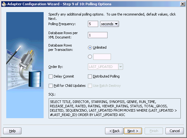

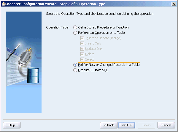

The inbound receive enables you to listen to and detect events and changes in the database, which in turn can be the initiators of a business process. This is not a one-time action, but rather an activation. A polling thread is started, which polls a database table for new rows or events.
Whenever a new row is inserted into the MOVIES table, the polling operation raises it to Oracle BPEL Process Manager. The stratagem is to poll every record once. The initial SELECT has to be repeated over time, to receive the rows that exist at the start and all new rows as they are inserted over time. However, a new row once read is not likely to be deleted, and therefore can possibly be read repeatedly with each polling.
The various ways to poll for events—called polling strategies, also known as after-read strategies or publish strategies—range from simple and intrusive to sophisticated and nonintrusive. Each strategy employs a different solution for the problem of what to do after reading a row or event so as not to pick it up again in the next polling interval. The simplest (and most intrusive) solution is to delete the row so that you do not query it again.

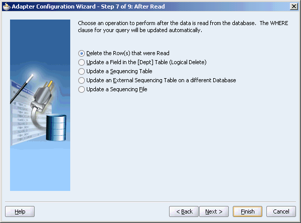

The physical delete polling strategy polls the database table for records and deletes them after processing. This strategy can be used to capture events related to INSERT operations and cannot capture database events related to DELETE and UPDATE operations on the parent table. This strategy cannot be used to poll child table events. This strategy allows multiple adapter instances to go against the same source table. There is zero data replication.
Preconditions: You must have deletion privileges on the parent and associated child tables to use the delete polling strategy. Table 4-5 describes the requirements for using the delete polling strategy.

The logical delete polling strategy involves updating a special field on each row processed, and updating the WHERE clause at run time to filter out processed rows. It mimics logical delete, wherein applications rows are rarely deleted but instead a status column isDeleted is set to true. The status column and the read value must be provided, but the modified WHERE clause and the post-read update are handled automatically by the database adapter.
Preconditions: You must have the logical delete privilege or a one-time alter schema (add column) privilege on the source table. Table 4-6 describes the requirements for using the logical delete polling strategy.

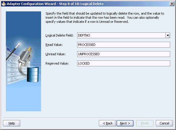

Configuration: The logical delete polling strategy requires minimal configuration. You must specify the mark read column, and the value that indicates a processed record.
A receive operation appears in an inbound WSDL as:
<operation name="receive">
<jca:operation
ActivationSpec="oracle.tip.adapter.db.DBActivationSpec"
PollingStrategyName="LogicalDeletePollingStrategy"
MarkReadField="STATUS"
MarkReadValue="PROCESSED"
Given the configuration for logical delete, the database adapter appends the following WHERE clause to every polling query:
AND (STATUS IS NULL) OR (STATUS <> 'PROCESSED')

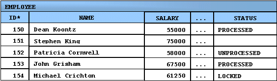

Database Configuration: A status column on the table being polled must exist. If it does not exist already, you can add one to an existing table.
Support for Polling for Updates: Given that rows are not deleted with each read, it is possible to repetitively read a row multiple times. You should add a trigger to reset the mark read field whenever a record is changed, as follows:
create trigger Employee_modified before update on Employee for each row begin :new.STATUS := 'MODIFIED'; end;
Support for Concurrent Access Polling: Just as a single instance should never process an event more than once, the same applies to a collection of instances. Therefore, before processing a record, an instance needs to reserve that record with a unique value. Again, the status column can be used:
<jca:operation
MarkUnreadValue="UNPROCESSED"
MarkReservedValue="RESERVED-1"
The polling query instead looks like the following:
Update EMPLOYE set STATUS = 'RESERVED-1' where (CRITERIA) AND (STATUS = 'UNPROCESSED'); Select … from EMPLOYEE where (CRITERIA) AND (STATUS = 'RESERVED-1');
The after-read UPDATE is faster because it can update all:
Update EMPLOYEE set STATUS = 'PROCESSED' where (CRITERIA) AND (STATUS = 'RESERVED-1');

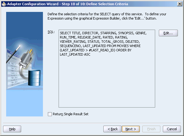

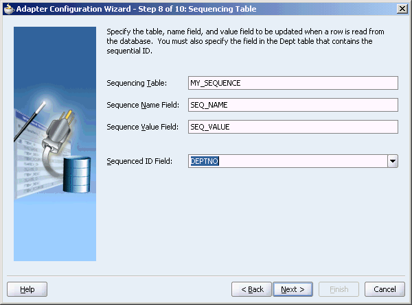

Sequencing Table: Last-Read Id
This polling strategy involves using a helper table to remember a sequence value. The source table is not modified; instead, rows that have been read in a separate helper table are recorded. A sequence value of 1000, for example, means that every record with a sequence less than that value has already been processed. Because many tables have some counter field that is always increasing and maintained by triggers or the application, this strategy can often be used for noninvasive polling. No fields on the processed row ever need to be modified by the database adapter.
Native sequencing with a preallocation size of 1 can ensure that rows are inserted with primary keys that are always increasing over time.
This strategy is also called a nondestructive delete because no updates are made to the source rows, and a sequencing strategy such as the sequence field can be used to order the rows in a sequence for processing. When the rows are ordered in a line, the database adapter knows which rows are processed and which are not with a single unit of information.
Preconditions: You must have a sequencing table or create table privilege on the source schema. The source table has a column that is monotonically increasing with every INSERT (an Oracle native sequenced primary key) or UPDATE (the last-modified timestamp). Table 4-7 describes the requirements for using the sequencing polling strategy.
Table 4-7 Sequencing Polling Strategy Preconditions
| Requirements Met | Conflicts With |
Poll for inserts |
Poll for deletes |
Poll for updates |
Allows raw SQL |
No delete on source |
Concurrent polling |
No updates on source |
Poll for child updates |
One extra SQL select |
Zero data replication |
Moderate configuration |
Configuration: A separate helper table must be defined. On the source table, you must specify which column is ever increasing.
<operation name="receive"> <jca:operation ActivationSpec="oracle.tip.adapter.db.DBActivationSpec" … PollingStrategyName="SequencingPollingStrategy" SequencingFieldName="MODIFIED_DATE" SequencingFieldType="java.sql.Date" SequencingTableNameFieldValue="EMPLOYEE" SequencingTableName="SEQUENCING_HELPER" SequencingTableNameFieldName="TABLE_NAME" SequencingTableValueFieldName="LAST_READ_DATE"
The sequencing field type can be excluded if it is actually a number.
Database Configuration: A sequencing table must be configured once for a given database. Multiple processes can share the same table. Given the ActivationSpec specified in the preceding example, the CREATE TABLE command looks as follows:
CREATE TABLE SEQUENCING_HELPER ( TABLE_NAME VARCHAR2(32) NOT NULL, LAST_READ_DATE DATE ) ;

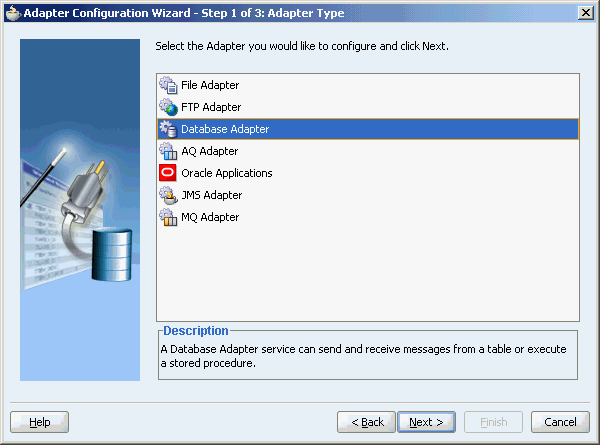

Click Next on the Welcome window.
Select Database Adapter for the Adapter Type, and then click Next.

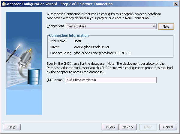

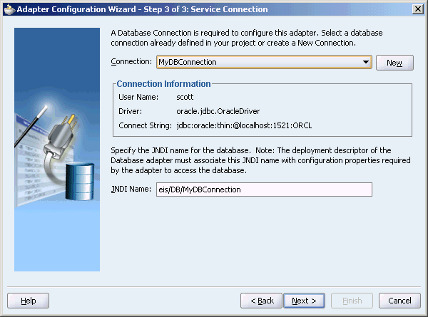

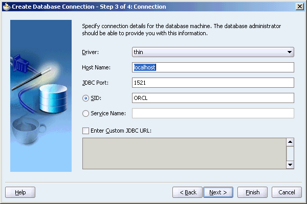

Figure 4-2 shows where you select the database connection that you are using with the service. This is the database from which you import tables to configure the service.
You can provide a Java Naming and Directory Interface (JNDI) name to identify the database connection, or use the default name that is provided. The JNDI name acts as a placeholder for the connection used when your service is deployed to Oracle BPEL Server. This enables you to use different databases for development and production. The Adapter Configuration Wizard captures the design-time connection in the generated WSDL as well, to serve as a fallback in case the run-time lookup fails.
Figure 4-2 Adapter Configuration Wizard: Service Connection
Note the following:
In production environments, it is recommended that you add the JNDI entry to the adapter deployment descriptor (oc4j-ra.xml). This way, the database adapter is more performant by working in a managed mode. In a nonmanaged mode, the database adapter uses the design-time connection information.
When you click Next, a connection to the database is attempted. If a connection cannot be made, you are not able to proceed to the next window, even if you are editing an existing partner link.
See Selecting the Operation Type to continue using the wizard.

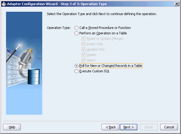

Figure 4-3 shows where you indicate the type of operation you want to configure for this service.
Figure 4-3 Adapter Configuration Wizard: Operation Type
The follow operation types are available:
Call a Stored Procedure or Function
Select this option if you want the service to execute a stored procedure or function. See Stored Procedure and Function Support for more information.
Perform an Operation on a Table
Select this option for outbound operations. You can select Insert or Update, Insert Only, Update Only, Delete, Select, or any combination of the five. These operations loosely translate to SQL INSERT, UPDATE, DELETE, and SELECT operations. See DML Operations for more information.
Note the following:

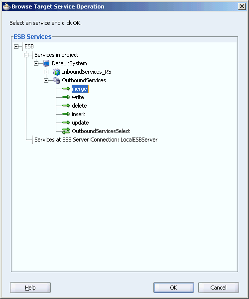

The operations merge, insert, update, and write are created from selecting Insert or Update.
The preceding Invoke window shows the MergeService service name as part of the Select operation, that is, MergeServiceSelect.
The queryByExample operation appears in every WSDL.
If the Operation list is initially blank, reselect the partner link and click the Operation list again.
The operationUpdate Only sometimes performs inserts/deletes for child records. That is, an update to Master could involve a new or deleted detail. So if the input to update contains only one record, then the other records in the table will be deleted.Poll for New or Changed Records in a Table
Select this option for an inbound operation (that is, an operation that is associated with a Receive activity). This operation type polls a specified table and returns for processing any new rows that are added. You can also specify the polling frequency. See Polling Strategies for more information.
See Selecting and Importing Tables to continue using the wizard.

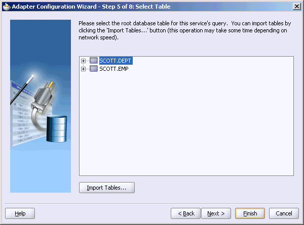

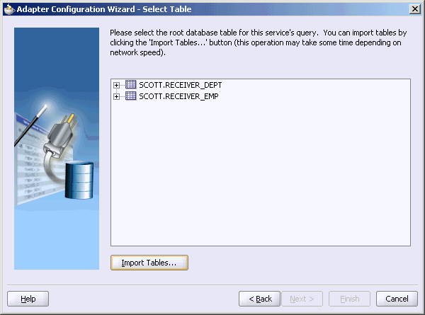

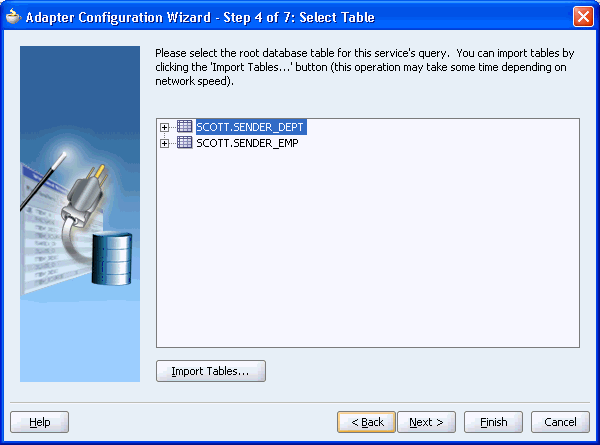

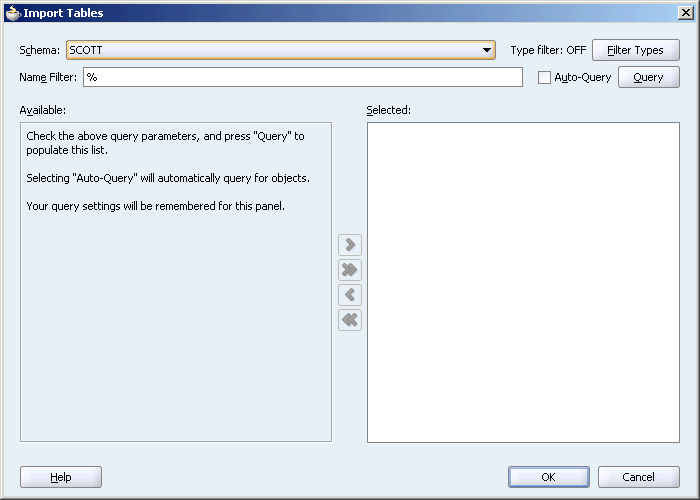

Figure 4-4 shows where you select the root database table for your operation. If you are using multiple, related tables, then this is the highest-level table (or highest parent table) in the relationship tree.
Figure 4-4 Adapter Configuration Wizard: Select Table
This window shows all the tables that have been previously imported in the JDeveloper BPEL Designer project (including tables that were imported for other partner links). This enables you to reuse configured table definitions across multiple partner links in a given BPEL project. These are the generated TopLink descriptors.
If the root database table you want to use for this operation has not been previously imported, you can click Import Tables.... If you want to reimport a table (if the table structure has changed on the database, for example), import it again. You can then reimport the table and overwrite the previously configured table definition.
If you reimport a table, you lose any custom relationships you may have defined on that table, as well as any customWHERE clauses (if the table being imported was the root table).See Defining Primary Keys to continue using the wizard.

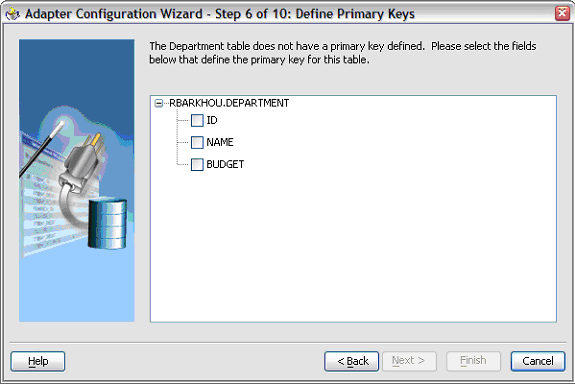

If any of the tables you have imported do not have primary keys defined on the database, you are prompted to provide a primary key for each one, as shown in Figure 4-5. You must specify a primary key for all imported tables. You can select multiple fields if you need to specify a multipart primary key.
Figure 4-5 Adapter Configuration Wizard: Define Primary Keys
The primary key that you specify here is recorded on the offline database table and is not persisted back to the database schema; the database schema is left untouched.

Figure 4-6 shows the relationships defined on the root database table and any other related tables. You can click Create Relationships… to create a new relationship between two tables, or Remove Relationship to remove it.
Figure 4-6 Adapter Configuration Wizard: Relationships
Note the following regarding creating relationships:
If foreign key constraints between tables already exist on the database, then two relationships are created automatically when you import the tables: a one-to-one (1:1) from the source table (the table containing the foreign key constraints) to the target table, as well as a one-to-many (1:M) from the target table to the source table.
As Figure 4-6 shows, you see only the relationships that are reachable from the root database table. If, after removing a relationship, other relationships are no longer reachable from the root table, then they are not shown in the Relationships window. Consider the following set of relationships:
A --1:1--> B --1:1--> C --1:M--> D --1:1--> E --1:M--> F
(1) (2) (3) (4) (5)
If you remove relationship 3, then you see only:
A --1:1--> B
B --1:1--> C
If you remove relationship 2, then you see only:
A --1:1--> B
If you remove relationship 1, you no longer see any relationships.
Figure 4-7 shows where you can create a new relationship.
To create a new relationship:
Select the parent and child tables.
Select the mapping type (one-to-many, one-to-one, or one-to-one with the foreign key on the child table).
Associate the foreign key fields to the primary key fields.
Optionally name the relationship (a default name is generated).

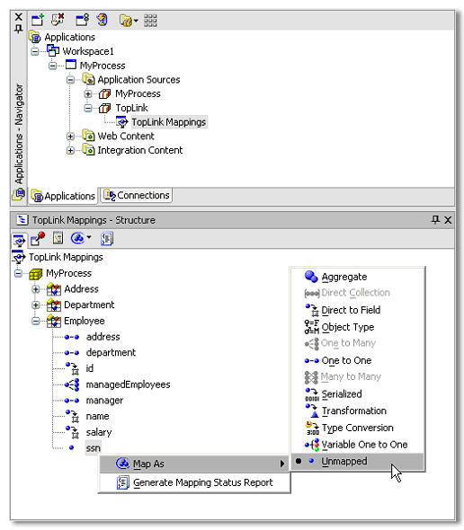

Only tables that are reachable from the root table can be selected as a parent.When tables are initially imported into the wizard, a TopLink direct-to-field mapping corresponding to each field in the database is created. Consider the schemas shown in Figure 4-8 and Figure 4-9:
Immediately after importing these two tables, the following mappings in the Employee descriptor are created:
Employee:
id (direct mapping to the ID field, for example, 151)
name (direct mapping to the NAME field, for example, Stephen King)
addrId (direct mapping to the ADDR_ID field, for example, 345)
When creating a relationship mapping, the direct-to-field mappings to the foreign key fields are removed and replaced with a single relationship (one-to-one, one-to-many) mapping. Therefore, after creating a one-to-one relationship between Employee and Address called homeAddress, the Employee descriptor looks like this:
Employee:
id
name
homeAddress (one-to-one mapping to the ADDRESS table; this attribute now represents the entire Address object.)
When a relationship is removed, the direct mappings for the foreign keys are restored.

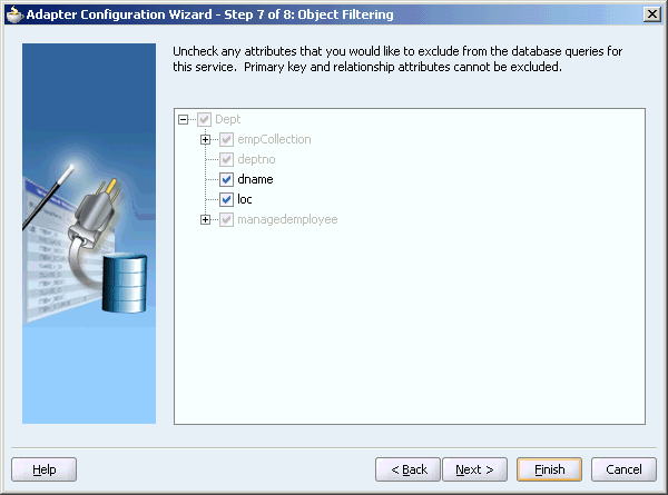

Figure 4-14 shows the object filter that is created from the imported table definitions, including any relationships that you may have defined.
Figure 4-14 Adapter Configuration Wizard: Object Filtering
If your object filter contains self-relationships (for example, the employee-to-employee manager relationship), then you see these as loops in the tree. These loops are not present in the XSD. This is the descriptor object model, not the XSD.
See Defining a WHERE Clause to continue using the wizard.

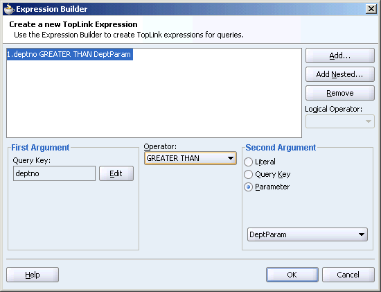

If your service contains a SELECT query (that is, inbound polling services, or outbound services that contain a SELECT), then you can customize the WHERE clause of the SELECT statement.
Figure 4-15 shows where you define a WHERE clause for an outbound service. For inbound services, you do not see the Parameters section.
Figure 4-15 Adapter Configuration Wizard: Define WHERE Clause
TheWHERE clause applies to SELECT operations only (that is, polling for new or changed records, or performing a SELECT operation on a table). It does not apply to INSERT, UPDATE, and DELETE operations.The most basic expression in a WHERE clause can be one of the following three cases, depending on what the right-hand side (RHS) is:
EMP.ID = 123
In this case, the RHS is a literal value. This RHS is the Literal option shown in Figure 4-16.
EMP.ADDR_ID = ADDR.ID
In this case, the RHS is another database field. This RHS is the Query Key option shown in Figure 4-16.
EMP.ID = ?
In this case, the RHS value must be specified at run time. This is the Parameter option shown in Figure 4-16.
You create the parameters that you need in the WHERE clause by clicking Add before you move on to build the WHERE clause. To build the WHERE clause, click Edit… to launch the Expression Builder, as shown in Figure 4-16.
See the following for more information:
The TopLink page on OTN at
http://www.oracle.com/technology/products/ias/toplink/index.html
TopLink documentation at
http://download.oracle.com/docs/cd/B14099_19/web.htm#toplink
This site contains documentation on configuring expressions using the XPath Expression Builder.

When configuring an inbound operation, you have the following options about what to do after a row or rows have been read:
Figure 4-17 shows these options.
Figure 4-17 Adapter Configuration Wizard: After-Read Strategies
With this option, the rows are deleted from the database after they have been read and processed by the adapter service.
With this option, you update a field in the root database table to indicate that the rows have been read. The WHERE clause of the query is updated automatically after you complete the configuration, as shown in Figure 4-18.
Figure 4-18 Adapter Configuration Wizard: Logical Delete
Using this approach, your database table looks something like Figure 4-19.
Note the following:
Rows 150 and 153 have been previously read and processed.
At the next polling event, row 152 will be read and processed because it contains UNPROCESSED in the Status column. Because an explicit Unread Value was provided, row 151 will not be read.
Row 154 has been flagged as LOCKED and will not be read. You can use this reserved value if your table is in use by other processes.
With this option, you are keeping track of the last-read rows in a separate sequence table. Figure 4-20 shows the information you provide. The WHERE clause of your query is updated automatically after you complete the configuration.
Figure 4-20 Adapter Configuration Wizard: Last Read IDs Table
Using these settings, your sequence table looks something like Figure 4-21.
Whenever a row is read, this table is updated with the ID that was just read. Then when the next polling event occurs, it will search for rows that have an ID greater than the last-read ID (154).

When you import a table, the offline table support of JDeveloper BPEL Designer creates an offline snapshot of the database table. You can modify this offline version of the table (for example, you can add a foreign key constraint) without affecting the real database table. This creates a TopLink descriptor and associated Java source file for the table, and all the attributes in the descriptor are automapped to their corresponding database columns. The TopLink descriptor maps the Java class to the offline database table.
Most typical data columns are mapped as direct-to-field mappings, meaning that the value in the database column is directly mapped to the attribute. For example, a SALARY column in the database is mapped to a salary attribute in the object model, and that attribute contains the value of that column.
If foreign key constraints are already present in the imported tables, then relationship mappings are autogenerated between the tables. To cover as many scenarios as possible, two mappings are generated for every foreign key constraint encountered: a one-to-one mapping from the source table to the target table, and a one-to-many mapping in the opposite direction. After this is done, you are left with an TopLink Workbench project in your BPEL project.
The Java classes that are created as part of the descriptor generation process are never actually deployed with your process or used at run time. They are present in the design time because TopLink Workbench is expecting each descriptor to be associated with a Java class. When your process is deployed, the mapping metadata is stored intoplink_mappings.xml.When you have finished importing tables, you must select a root database table. In doing so, you are actually selecting which TopLink descriptor stores the autogenerated query.
When you create or remove a relationship, you are actually modifying the TopLink descriptor mappings. Creating a new relationship does the following:
Creates a foreign key constraint in the offline database table
Adds a one-to-one or one-to-many mapping to the descriptor
Removes the direct-to-field mappings to the foreign key fields
Removing a relationship mapping does the following:
Removes the one-to-one or one-to-many mapping from the descriptor
Removes the foreign key constraint from the offline database table
Adds direct-to-field mappings for each foreign key field involved in the relationship

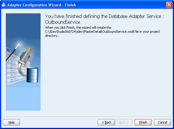

The following files are generated:
service_name.wsdl—contains the database adapter service definition
RootTable.xsd—the XML type definition of the root object
toplink_mappings.xml—contains the TopLink mapping metadata for your BPEL project. It is the only Toplink artifact that is deployed to the server.

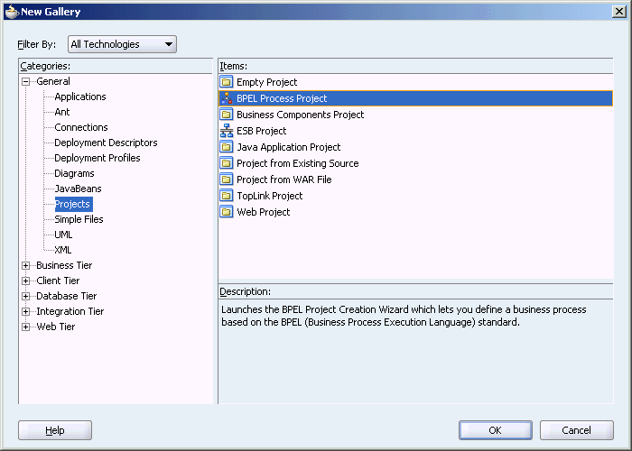

The following are the steps to create a new BPEL project:
Open Oracle JDeveloper.
From the File menu, select New.
The New Gallery dialog box is displayed.
Select All Technologies from the Filter By box. This displays a list of available categories.
Expand the General node, and then select Projects.
Select BPEL Project from the Items group.
Click OK.
The Create BPEL Project dialog box is displayed.
Click OK.
You have created a new BPEL project.

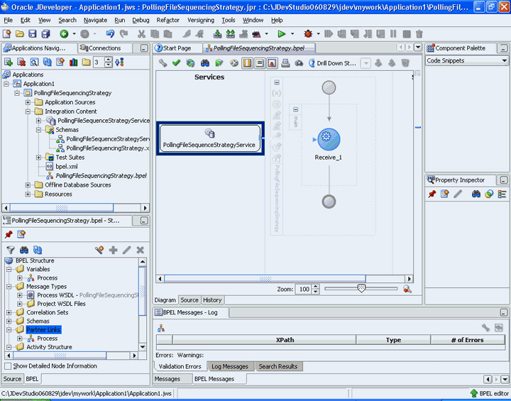

After you create a BPEL project in Oracle JDeveloper, you can start defining a database adapter. To define a database adapter:
Drag and drop Database Adapter from the component Palette onto the designer window.

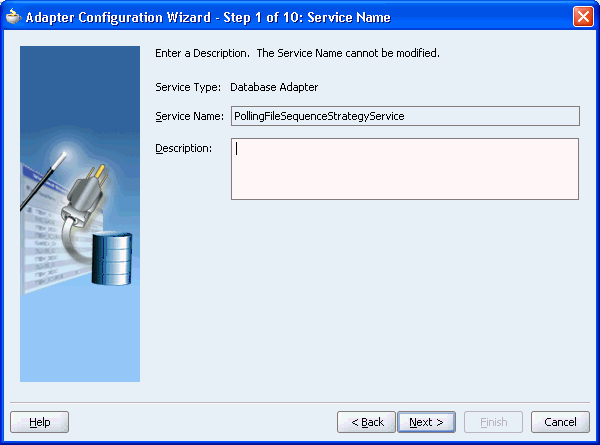

The Service Name dialog box is displayed.
Enter a service name as shown in Figure 4-22. The Description filed is optional.
Click Next.

The Operation Type dialog box is displayed.
Select Poll for New or Changed Records in a table, as shown in Figure 4-23.

Click Import Tables.
The Import Tables dialog box is displayed.
Double-click the Movies table to select it, as shown in Figure 4-24.
Click OK.
The Select Tables dialog box is displayed with the Movies table selected, as shown in Figure 4-25.

The Relationships dialog box is displayed.
In the Relationships dialog box you can define relationships that are reachable from the root database. However, in the example, you will not define any relationship. Click Next.
In the Object Filtering dialog box is displayed, click Next.

Select Update a Sequencing File, and then click Next.
The Sequencing File dialog box is displayed.
Enter the following information:
Sequencing File: Specify the location of the of the sequencing file. In this example, specify,
Oracle_Home\bpel\samples\tutorials\122.DBAdapter\advanced\polling\PollingFileSequencingStrategy\lastReadId.txt
Sequenced ID Field: Select LATST_UPDATED.
Figure 4-26 shows the Sequencing File dialog box, wish the value populated.

The Polling Options dialog box is displayed, as shown in Figure 4-27.
Figure 4-27 The Polling Options Dialog Box
In the Polling Options dialog box, retail default values, and then click Next.
The Define Selection Criteria dialog box is displayed, as shown in Figure 4-28.
Figure 4-28 The Define Selection Criteria Dialog Box
Retain default values, and then click Next.

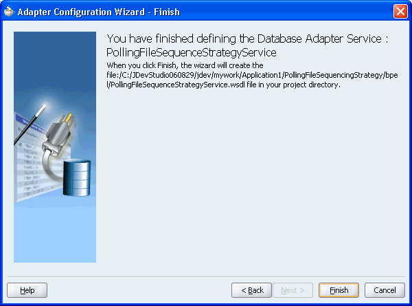

The Adapter Configuration Wizard-Finish screen is displayed, as shown in Figure 4-29.
Figure 4-29 The Adapter Configuration Wizard - Finish Screen

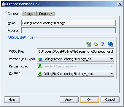

Click Finish.
The Create Partner Link dialog box is displayed with all the fields populated, as shown in Figure 4-30.
Figure 4-30 The Create Partner Link Dialog Box
Click Ok.
Your screen will resemble Figure 4-31.
Right-click the project, select Deploy, point to ServerConnection1, and then click Deploy to Default Domain.
The Oracle BPEL Control will resemble Figure 4-32.

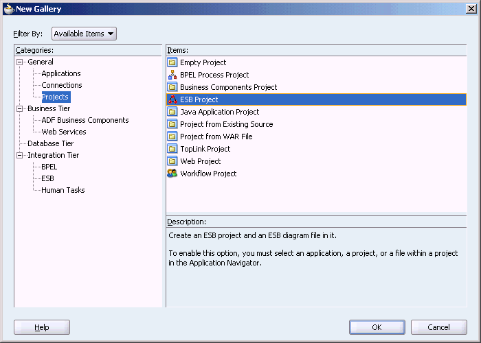

The following are the steps to create a new ESB project:
Select ESB Project from the Items group, as shown in Figure 4-33
Click OK.

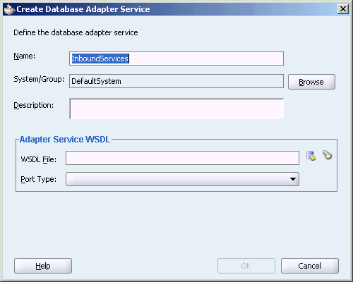

The Create Database Adapter Service dialog box is displayed.
Specify the following information in the Create Database Adapter Service dialog box:
Name: Type a name for the service. In this example, type InboundServices.
System/Group: Retain the default value.
Figure 4-34 shows the Database Adapter Service dialog box with the Name and System/Group fields, filled up.
Figure 4-34 Defining the Database Adapter Service

The Service Connection dialog box is displayed, as shown in Figure 4-35
Figure 4-35 The Service Connection Dialog Box

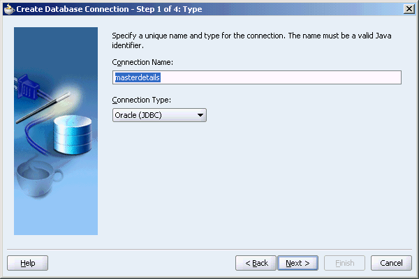

Enter the following information in the Type dialog box:
In the Connection Name field, specify a unique name for the database connection. In this example, type masterdetails.
From the Connection Type box, select Oracle (JDBC).
Figure 4-36 shows the Type dialog box.
Figure 4-36 Specifying the Connection Name and Type of Connection

The Connection dialog box is displayed.
Enter information in the following fields:
In the Driver list, retain the default value, Thin.
In the Host Name field, retain the default value, localhost.
In the JDBC Port field, specify the port number for the database connection. In this example, type 1521.
In the SID field, specify a unique SID value for the database connection. In this example, type ORCL.
Figure 4-38 shows the Connection dialog box.
Figure 4-38 Specifying the New Database Connection Information

The Service Connection dialog box is displayed, providing a summary of the database connection, as shown in Figure 4-39.
Figure 4-39 The Service Connection Dialog Box

The Operation dialog box is displayed, as shown in Figure 4-40.
Figure 4-40 Specifying the Operation Type
Select Poll for New or Changed Records in a Table, and then click Next.
The Select Table dialog box is displayed.
Click Import Tables to import tables.

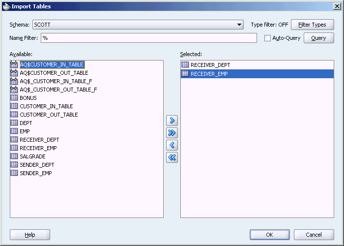

The Import Tables dialog box is displayed, as shown in Figure 4-41.
Select the following query parameters in the Import Tables dialog box:
Schema: Select Scott
Name Filter: Click Query to retrieve objects from database.
A list of available tables is displayed.
Select RECEIVER_DEPT and RECEIVER_EMP from the Available column, and move it to the Selected column by clicking the Add button.
Figure 4-42 shows the Add button.
The selected tables now appear in the Selected column, as shown in Figure 4-43.
Figure 4-43 Adding the Required Tables from the Schema
Click Ok.
The Select Table dialog box is displayed with the tables you imported, as shown in Figure 4-44.
Figure 4-44 The Select Tables Dialog Box with the Imported Tables
Select a root table, and then click Next. In this example, select SCOTT.RECEIVER_DEPT.
The Relationships dialog box is displayed, as shown in Figure 4-45.
Click Next.

The After Read dialog box is displayed.
In the After Read dialog box, select Delete the Row(s) that were Read, as shown in Figure 4-47, and then click Next.

The Define Selection Criteria dialog box is displayed, as shown in Figure 4-49.
Figure 4-49 The Define Selection Criteria Dialog Box
Retain the default query, and click Next. However, to define your own expression, click Edit

The Service Connection dialog box is displayed.
Select the connection that you already created, and the click Next.
The Operation dialog box is displayed, as shown in Figure 4-51.
Figure 4-51 Specifying the Operation Type
Select Perform an Operation on a Table, and then click Next.

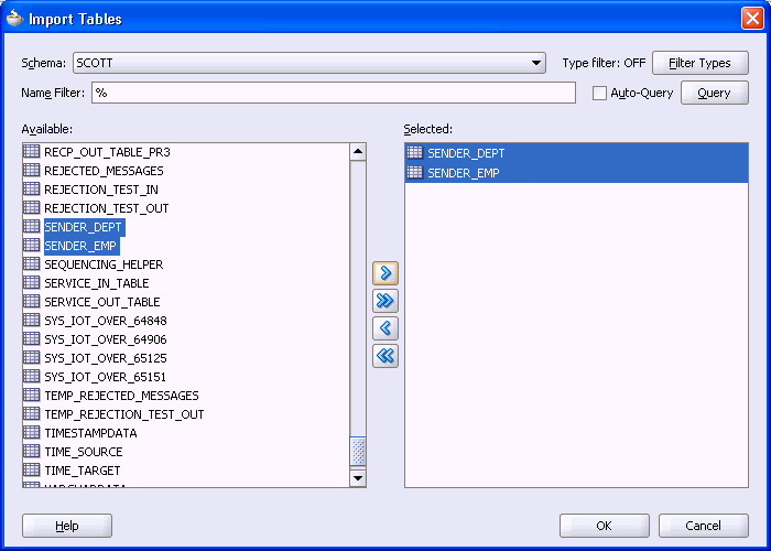

Select SENDER_DEPT and SENDER_EMP from the Available column, and move it to the Selected column by clicking the Add button.
The selected tables now appears in the Selected column, as shown in Figure 4-52.
Figure 4-52 Adding the Required Tables from the Schema

The Select Table dialog box is displayed with the tables you imported, as shown in Figure 4-53.
Figure 4-53 The Select Tables Dialog Box with the Imported Tables
Select a root table, and then click Next. In this example, select SCOTT.SENDER_DEPT.

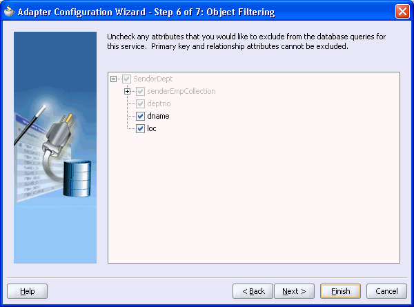

The Object Filtering dialog box is displayed, as shown in Figure 4-55.
Figure 4-55 The Object Filtering Dialog Box
Click Next.
The Define Selection Criteria dialog box is displayed, as shown in Figure 4-56.
Figure 4-56 The Define Selection Criteria Dialog Box
Click Next.
The Finish screen confirming the creation of the outbound service is displayed, as shown in Figure 4-57.
Figure 4-57 The Adapter Configuration Wizard Screen - Finish Screen

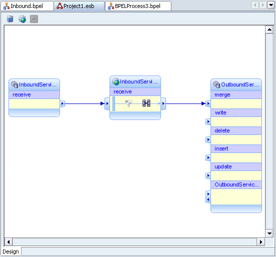

The following are the steps to configure the routing service:

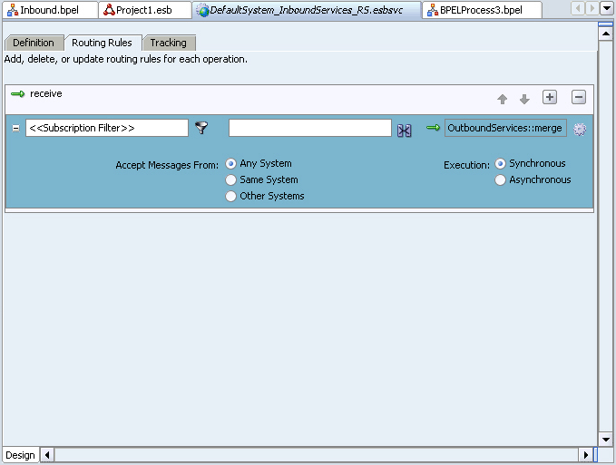

Double-click the InboundServices routing service.
The Routing Service window is displayed in the midpane of the Application window, as shown in Figure 4-58.
Select the Routing Rules tab, and then click + icon to add a rule.
The Browse Target Service Operation dialog box is displayed.
Select the Merge service, as shown in Figure 4-59, and then click OK.
Figure 4-59 The Browse Target Service Operation Dialog Box
Click Ok.
The middle pane of the application window will resemble Figure 4-60.

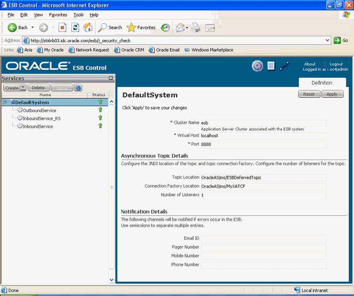

Right-click the project, select Register with ESB, and then click LocalESBServer, as shown in Figure 4-65.
The Success page is displayed, as shown in Figure 4-66.
Figure 4-66 The ESB Registration Summary Page
To check the ESB control, open the ESB Console. For example: http://localhost:8888/esb/esb/EsbConsole.html
Now, your service window will resemble Figure 4-67:

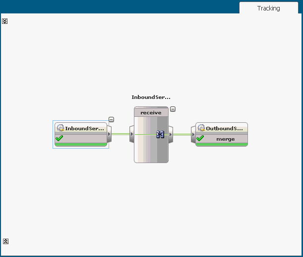

Use the following steps to check execution in the ESB control:
Open the ESB Console.
Click Instances on top-right corner.
Click the green arrow next to Search.
An instance resembling Figure 4-68 is displayed.

Click the TopLink Mappings node under Application Sources under your project in the Applications - Navigator.
Select the descriptor from the tree in the TopLink Mappings - Structure pane.
Right-click and select Remove.
Currently, the Adapter Configuration Wizard does not have built-in support for partial object reading, that is, returning only specific fields from a table. To achieve this functionality, you can manually unmap any attributes that you do not want to include in the result set. Relationship mappings can be unmapped by removing them in the Relationships window, but direct mappings must be explicitly unmapped on the TopLink descriptor.
To unmap attributes:
Select the descriptor containing the attribute you want to unmap from the tree in the TopLink Mappings - Structure pane.
Right-click the attribute you want to unmap and select Map As > Unmapped.
To remap the attribute, you can do the following:
Select the descriptor containing the attribute you want to remap from the tree in the TopLink Mappings - Structure pane.
Right-click the attribute you want to remap and select Map As > Direct to Field.
The TopLink Mappings Editor automatically opens in the JDeveloper BPEL Designer window.
From Database Field, select the column to which the attribute should be mapped.
Open the corresponding Java source file and change the name. Then go to the structure/Mappings pane, and the newly named attribute will appear unmapped. Right-click it and select Map As to remap it. Then save and regenerate BPEL artifacts.
Keep in mind there are four views, the project view, the table/descriptor view, and the individual attribute/column view you can access from the TopLink Mappings structure window. The Java source view is not exactly a TopLink view, but can be treated as such (when renaming a mapping).

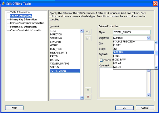

Offline database tables are internal to the TopLink Workbench project. When you run the wizard, a TopLink project is created. When you import tables, they are saved as offline table definitions.
You can use the offline database tables to control the micromapping from database data type to XML data type. If you are using a third-party database, you may need to edit these objects as a workaround. For instance, a serial field on a third-party database may need to be mapped as Integer so that it is recognized by the wizard and mapped to xs:integer. See "Problems Importing Third-Party Database Tables" for more information.
Run the wizard once. Then add the following to your JDeveloper BPEL Designer project: database/schemaName/schemaName.schema
Click the table name (see Figure 4-69) after it is added to your project and change the types of any of the columns. When you run the wizard again (in edit mode) and click Finish, the toplink_mappings.xml and XSD file are remapped based on the new database data types.
Edit the offline table in your JDeveloper BPEL Designer project (see Figure 4-70), not the table reachable from the ConnectionManager. If you try the latter, the column types will not be editable, because you are editing the table itself, not an offline representation of it.

The WSDL generated by the Adapter Configuration Wizard defines the adapter service. This WSDL specifies the various operations exposed by the service. Table 4-10 specifies the operations that are generated based on your selection in the wizard.
Table 4-10 WSDL Operations Generated by the Adapter Configuration Wizard
| Adapter Configuration Wizard Selection | Generated WSDL Operation |
Insert or Update |
Delete |
Select |
Poll for New or Changed Records in a Table |
Of the preceding operations, receive is associated with a BPEL receive activity, whereas the rest of the preceding operations are associated with a BPEL invoke activity.See "SQL Operations as Web Services" for more information on the preceding operations.
This section discusses the database adapter-specific parameters in the generated WSDL. This is intended for advanced users who want information about all the parameters in the generated WSDL.
A given database adapter service is meant for either continuous polling of a data source (translates to a JCA Activation) or for performing a one-time DML operation (translates to a JCA Interaction). In the continuous polling case, the WSDL contains only one receive operation with a corresponding activation spec defined in the binding section. In the one-time DML operation case, the WSDL contains multiple operations, all of which have a corresponding interaction spec defined in the binding section.
Table 4-11 specifies the JCA Activation/Interaction spec associated with each of the preceding operations:
Table 4-11 Operation and JCA Activation/Interaction Spec
| WSDL Operation | JCA Activation/Interaction Spec |

Table 4-15 describes all of the additional DBActivationSpec parameters for LogicalDeletePollingStrategy:
Table 4-15 DBActivationSpec Parameters for LogicalDeletePollingStrategy
| Parameter | Description | Mechanism to Update |
Specifies the database column to use to mark the row as read |
Wizard updates automatically. Do not modify this manually. |
Specifies the value to which the database column is set to mark the row as read |
Specifies the value to which the database column is set to mark the row as reserved. This parameter is optional. You can use it when multiple adapter instances are providing the same database adapter service. |
Specifies the value to which the database column is set to mark the row as unread. This parameter is optional. Use it when you want to indicate specific rows that the database adapter must process. |

Table 4-16 describes all of the additional DBActivationSpec parameters for SequencingPollingStrategy:
Table 4-16 DBActivationSpec Parameters for SequencingPollingStrategy
| Parameter | Description | Mechanism to update |
Specifies the database column that is monotonically increasing |
Specifies the type of the database column that is monotonically increasing. This parameter is optional. Use it if the type is not |
Specifies the root database table for this polling query |
Name of the database table that is serving as the helper table |
Specifies the database column in the helper table that is used to store the root database table name |
Specifies the database column in the helper table that is used to store the sequence number of the last processed row in the root database table name |

Figure 4-71 shows how the database adapter gets connection information from the three possible sources: the WSDL file, the oc4j-ra.xml file, or the data-sources.xml file, as described in the following sections.
Figure 4-71 How the Database Adapter Gets Connection Information
When you deploy a process using the Database Adapter, the nature of the deployment varies based on whether a separate database adapter instance is already deployed and available on the application server. For information on production deployment, see Production Deployment.
In the out of the box deployment, when you run the DBAdapter wizard, connection information is required to import tables from the database, as shown in Example 4-1. As a convenience feature, when thewsdl file is written it includes the connection information that was used by the design time. This way you can deploy the business process immediately, as the wsdl has all the information it needs to execute properly.
Out of box deployment is used only until production deployment is correctly setup. For production you may remove this connection information (mcf.* properties) in the wsdl keeping only the location attribute, which is required for production deployment. It is mandatory that you use production deployment for production.
Example 4-1 shows database connection information specified in the mcf.* properties of the WSDL.
Example 4-1 WSDL Code Example Showing Database Connection Information in the mcf.* Properties

When the database adapter uses connection information specified in the WSDL, you have no connection pooling.Please see Section 4.1.2, "Design Overview". During design time, you specified something like eis/DB/<JdevConnectionName> on the Adapter Configuration Wizard: Service Connection page. For production deployment a Database adapter instance with that JNDI name needs to be already deployed and available on the Application Server. This deployment section provides the information to do that.
Runtime instances are configured in the database adapter's oc4j-ra.xml file, similar to how connection pools are configured in data-sources.xml. These in turn refer through JNDI to the name of a connection pool in data-sources.xml.
For the Oracle BPEL Process Manager, oc4j-ra.xml is located at
Oracle_Home\bpel\system\appserver\oc4j\j2ee\home\
application-deployments\default\DbAdapter\oc4j-ra.xml
For the Oracle BPEL Process Manager for OracleAS Middle Tier installation, oc4j-ra.xml is located at
Oracle_Home\j2ee\OC4J_BPEL\application-deployments\default\DBAdapter\oc4j-ra.xml
Connection information in the oc4j-ra.xml file is not generated by the Adapter Configuration Wizard. You must manually update this file and restart Oracle BPEL Server for updates to oc4j-ra.xml to take effect.
The Application Server manages and pools connections for all applications. It provides cross-application sharing of a single connection pool, high availability, special RAC configuration, XA/transaction support, password indirection, and a single configuration file, data-sources.xml. Hence the DB, AQ, and JMS adapters should not contain connection information in their oc4j-ra.xml files but simply refer to a data source by name. This is the recommended and default approach in 10.1.3.1.
The WSDL points to a JCA adapter (that is,eis/DB/BPELSamples in oc4j-ra.xml), which in turn points to a data source (that is, jdbc/BPELSamples in data-sources.xml). A common pitfall is to set the JNDI name in the wizard directly to the name of a data source.The deployment descriptor file (oc4j-ra.xml) has four key properties: location, xADataSourceName, dataSourceName, and platformClassName.

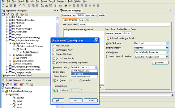

Load Balancing: MaxTransactionSize and Pessimistic Locking
You can set a simple option that enables the database adapter to work safely in a distributed environment by making the first polling query acquire locks, as shown in Figure 4-72. In SQL terms, you are making your first SELECT into a SELECT...FOR UPDATE.
The behavior of all polling strategies is as follows:
If any adapter instance performs step 1 while another instance is between steps 1 and 3, then duplicate processing occurs. Acquiring locks on the first operation and releasing them in commit solves this problem, and may naturally order the polling instances.
To enable pessimistic locking, run through the wizard once to create an inbound polling query. In the Applications Navigator window, expand Application Sources, then TopLink, and click TopLink Mappings. In the Structure window, click the table name. In Diagram View, click the following tabs: TopLink Mappings, Queries, Named Queries, Options; then the Advanced… button, and then Pessimistic Locking and Acquire Locks. You see the message, "Set Refresh Identity Map Results?" If a query uses pessimistic locking, it must refresh the identity map results. Click OK when you see the message, "Would you like us to set Refresh Identity Map Results and Refresh Remote Identity Map Results to true?Ó Run the wizard again to regenerate everything. In the new toplink_mappings.xml file, you see something like this for the query: <lock-mode>1</lock-mode>.
After you enable pessimistic locking on a polling query, the maxTransactionSize activation property automatically behaves differently.
Assume that there are 10,000 rows at the start of a polling interval and that maxTransactionSize is 100. In standalone mode, a cursor is used to iteratively read and process 100 rows at a time until all 10,000 have been processed, dividing the work into 10,000 / 100 = 100 sequential transactional units. In a distributed environment, a cursor is also used to read and process the first 100 rows. However, the adapter instance will release the cursor, leaving 9,900 unprocessed rows (or 99 transactional units) for the next polling interval or another adapter instance.
For load balancing purposes, it is dangerous to set the maxTransactionSize too low in a distributed environment (where it becomes a speed limit). It is best to set the maxTransactionSize close to the per CPU throughput of the entire business process. This way, load balancing occurs only when you need it.

To create a database connection when using a third-party JDBC driver:
Select Connection Navigator from View.
Right-click Database and select New Database Connection.
Click Next in the Welcome window.
Enter a connection name.
Select Third Party JDBC Driver from Connection Type.
Enter your username, password, and role information.
Click New for Driver Class.
Enter the driver name (for example, some.jdbc.Driver) for Driver Class.
Click New for Library.
Click Edit to add each JAR file of your driver to Class Path.
Click OK twice to exit the Create Library windows.
Click OK to exit the Register JDBC Driver window.
Enter your connection string name for URL and click Next.
See Table 4-19 for some commonly used URLs. Also, sample entries appear in the deployment descriptor file (oc4j-ra.xml).
Click Test Connection.
If the connection is successful, click Finish.

In the wizard, select Database Adapter, as shown in Figure 4-73.
Figure 4-73 Selecting the Database Adapter in the Adapter Configuration Wizard

For the Operation Type, select Call a Stored Procedure or Function, as shown in Figure 4-75.
Figure 4-75 Calling for a Stored Procedure or Function in the Adapter Configuration Wizard

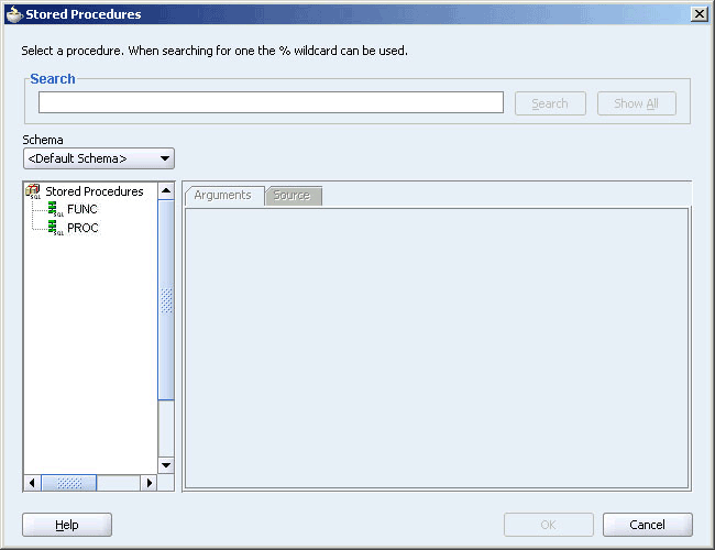

Figure 4-76 Searching for a Procedure or Function
Select a schema from the list or select <Default Schema>. The available procedures are displayed in the left window. To search for a particular API in a long list of APIs, enter search criteria in the Search field. For example, to find all APIs that begin with XX, enter XX% and click the Search button. Clicking the Show All button displays all available APIs.

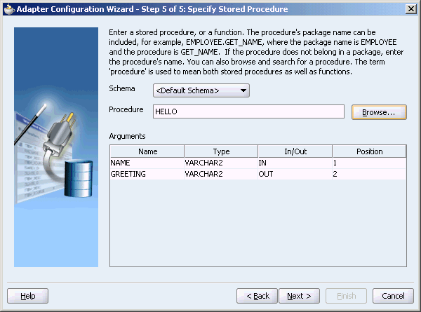

Figure 4-77 shows how you can select the PROC procedure and click the Arguments tab. The Arguments tab displays the parameters of the procedure, including their names, type, mode (IN, IN/OUT or OUT) and the numeric position of the parameter in the definition of the procedure.
Figure 4-77 Viewing the Arguments of a Selected Procedure
Figure 4-78 shows how the Source tab displays the code that implements the procedure. Text that matches the name of the procedure is highlighted.
Figure 4-78 Viewing the Source Code of a Selected Procedure
