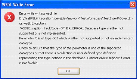

A.2.1 Design Time: Unsupported or Undefined Parameter Types
Problem
Using an unsupported or undefined parameter type in the chosen API is a common problem. Consider the following procedure:
PROCEDURE PROC (O OBJ) AS BEGIN … END;
In this example, OBJ refers to a type that is undefined.
After you click Finish on the final page of the wizard, an attempt to generate the XSD is made, which produces the following error message:
WSDL Write error
The message indicates that the named parameter, O, which is of type OBJ, is either not defined or is otherwise inaccessible.
To generate an XSD for APIs containing parameters whose types are user-defined, those types must first be defined in the database and be accessible through the associated service connection. This error also occurs if such types have not been created (that is, implemented) in the database or if the database is inaccessible.
Solution
Ensure that only supported datatypes are used as types for parameters when choosing an API. If the types are user-defined, check to ensure that the types are defined in the database and that the database is accessible when the attempt to generate the XSD is made.

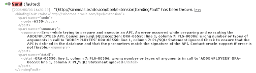

Problem
A mismatch between the formal parameters provided by the instance XML and the actual parameters that are defined in the signature of the stored procedure is a common run-time problem. When this type of error occurs, the invoke activity that tried to execute the stored procedure faults, as shown in Figure A-1.
Figure A-1 Example of a Faulted Invoke Due to MIsmatched Parameters
Description of Figure A-1 follows
Description of "Figure A-1 Example of a Faulted Invoke Due to MIsmatched Parameters"
The bindingFault has three parts—code, summary, and detail. The information for these parts comes from the java.sql.SQLException that gets thrown by JDBC when it attempts to execute the stored procedure. The code is the ORA error number, seen in Figure A-1 as 6550 and as ORA-06550 in the summary and detail parts. The summary includes an adapter-specific error message followed by the message from the SQLException and a suggested resolution to the issue. The detail contains just the message from the SQLException.
As shown in Figure A-1, the ADDEMPLOYEES stored procedure failed to execute due to "wrong number or types of arguments" passed into the API. Possible causes for this problem include:
  • An element corresponding to one of the required parameters was not provided in the instance XML.
    Solution: Add the necessary element to resolve the issue.
  • More elements than were specified in the XSD were included in the instance XML.
    Solution: Remove the extra elements from the XML.
  • The XSD does not accurately describe the signature of the stored procedure. For example, if the type of one of the parameters were to change and the XSD was not regenerated to reflect that change, a type mismatch can occur between the db:type of the element and the new type of the modified parameter.
    Solution: Ensure that the parameters match the signature of the API, as indicated in the summary part of the bindingFault.

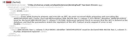

A.2.4 Run Time: Stored Procedure Not Defined in the Database
Problem
A bindingFault can also occur if the stored procedure is not defined in the database when an attempt to execute it is made. In this example, the ADDEMPLOYEES API is invoked, but fails to execute because it is not defined. The invoke activity faults, as shown in Figure A-2.
PL/SQL is revealing that "... identifier ADDEMPLOYEES must be declared," which is an indication that the stored procedure may not be defined in the database. This can occur, for example, if the procedure was dropped sometime between when the process was deployed and when the procedure was invoked. This can also occur if the required privileges to execute the stored procedure have not been granted.
Solution
Ensure that the API is defined in the database, as indicated in the summary, and that the appropriate privileges to execute that procedure have been granted.
