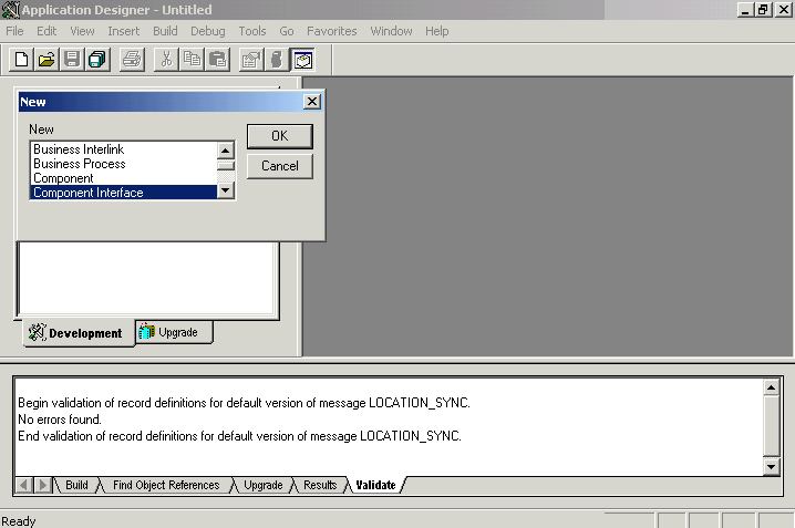

  1. Open the PeopleSoft Application Designer.
  2. Select New from the File menu.
    The New dialog box is displayed.
    New dialog box
    Perform the following steps:
    1. Select Component Interface.
    2. Click OK.

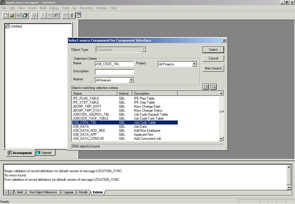

      The Select Source Component for Component Interface dialog box is displayed.
    Select source component.
  3. Highlight the component to use as a basis for the component interface and click Select.

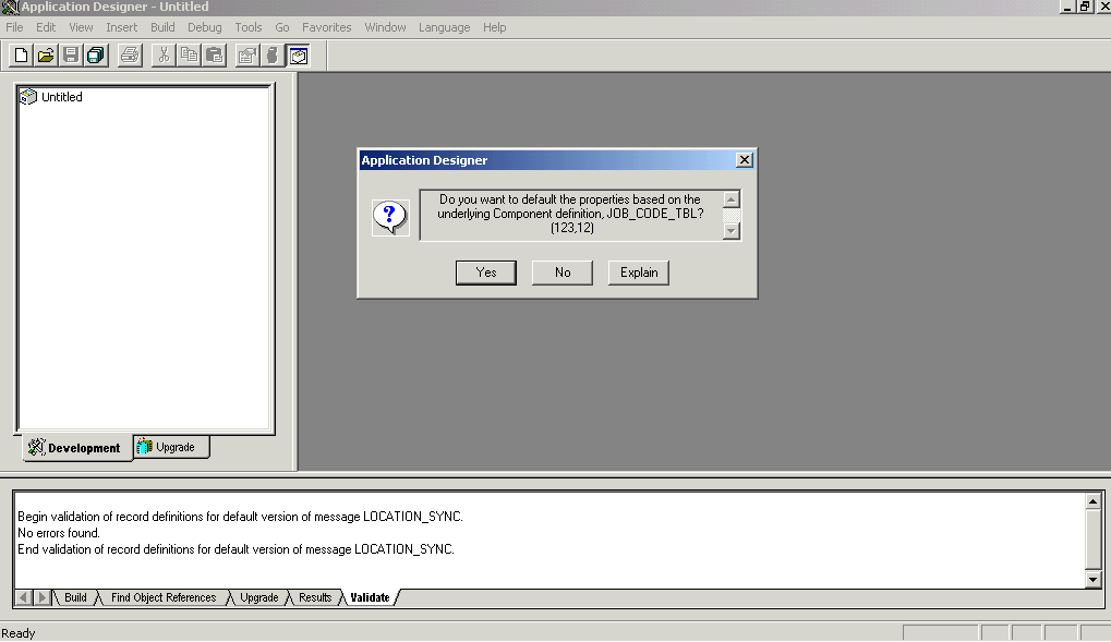

    The Application Designer dialog box is displayed.
    If the component interface is large, expose the component properties manually.
  4. To create the component interface without displaying properties and to expose component properties manually, click No.

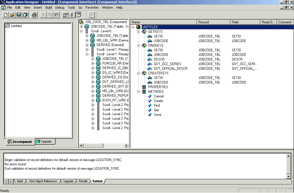

  5. To create the component interface and display the properties of the underlying component interface, click Yes.
    Component Interface

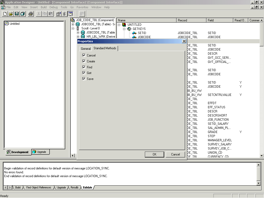

  1. Display the Component Interface Properties dialog box.
  2. Click the Standard Methods tab.
  3. Select the desired methods.

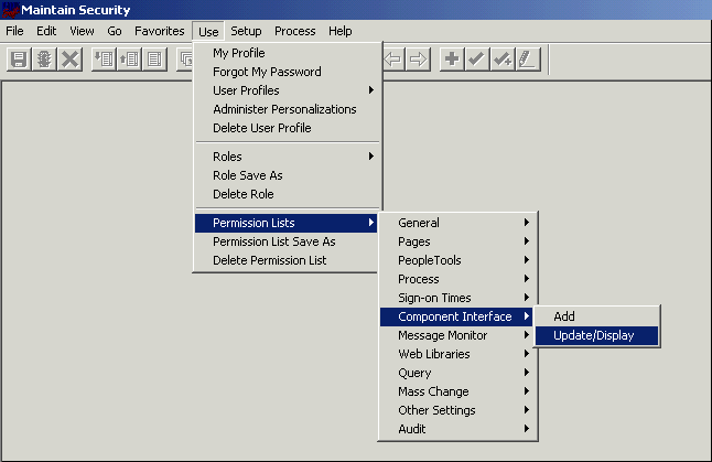

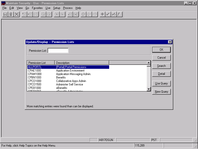

  1. From the Use menu, select Permission Lists, Component Interface, and then click Update/Display.
    The Permission Lists dialog box is displayed. Permission Lists dialog box
    Before Security can be set, you must identify the permission lists.
  2. Select the relevant permission list and click OK.

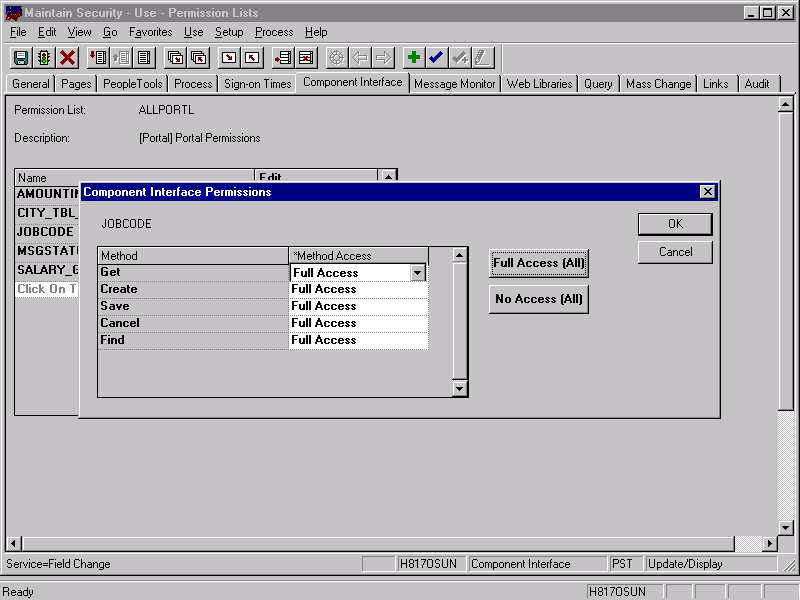

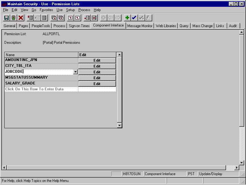

  3. Insert the new component interface that you created.
  4. Click Edit.
    When you select the component interface, all available methods appear, including user-defined methods. This enables you to specify whether this particular Permission List must have full or partial access.
    In the following example, the ALLPORTL Permission List has full access to all methods.
    ALLPORTL permission list
  5. Select the desired level of access.
  6. Click OK.

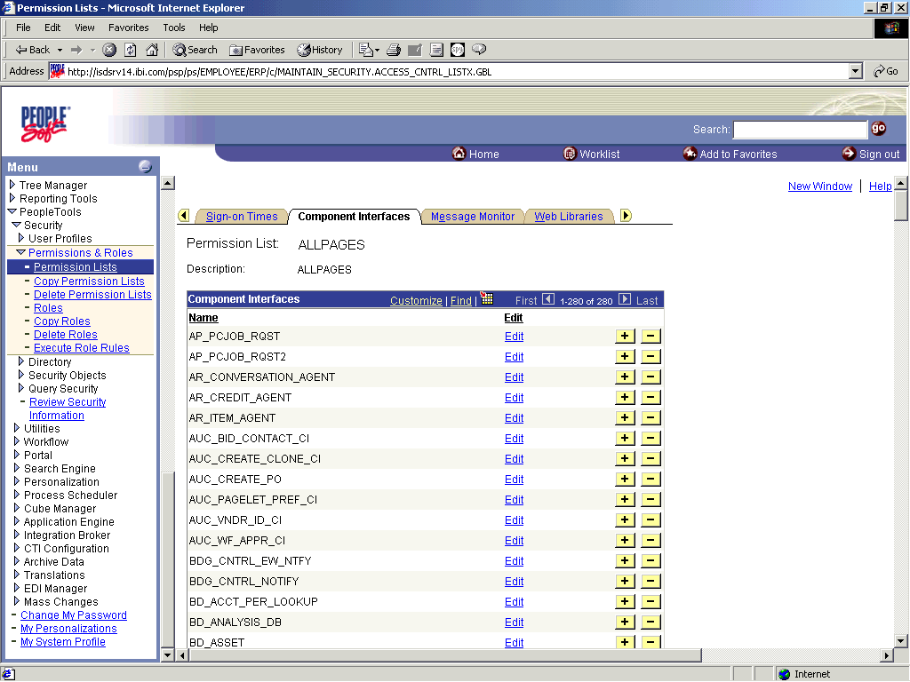

Configuring Component Interface Security for PeopleSoft Version 8.4 or Higher
The following procedure describes how to configure component interface security for PeopleSoft Version 8.4 or higher.
To configure interface security:

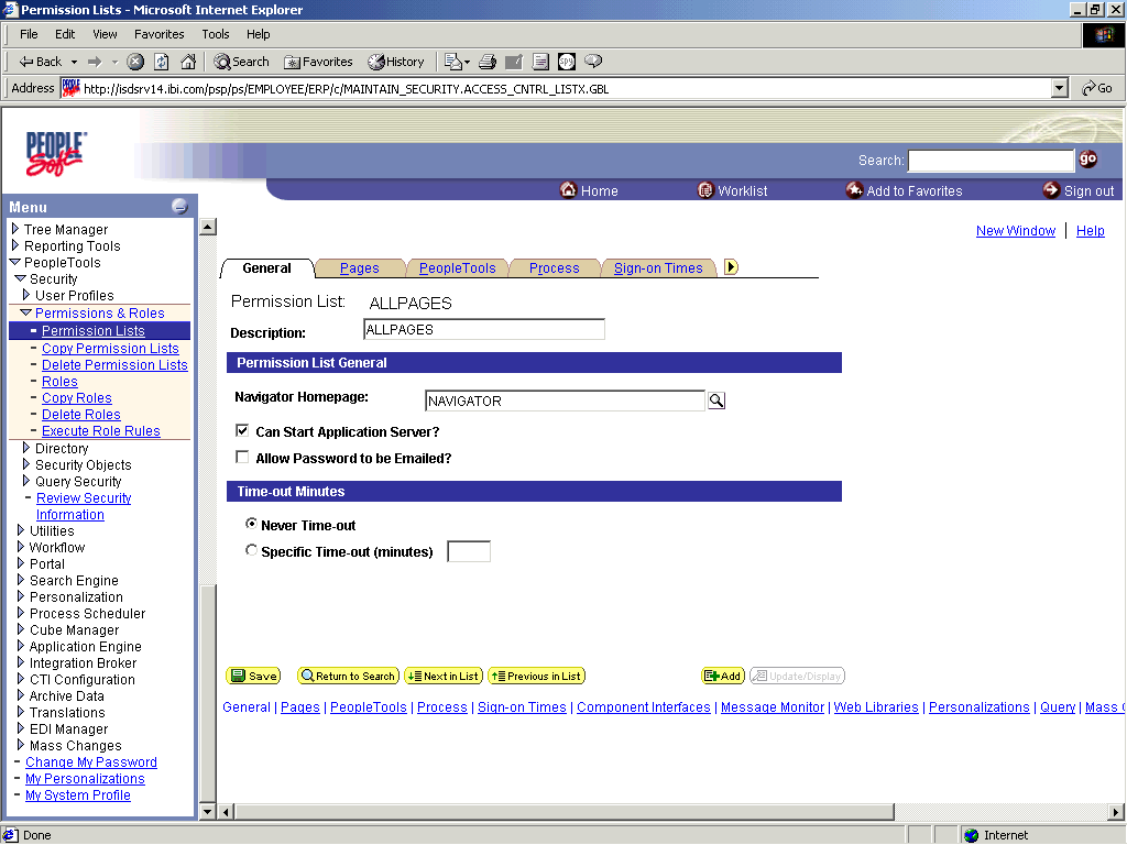

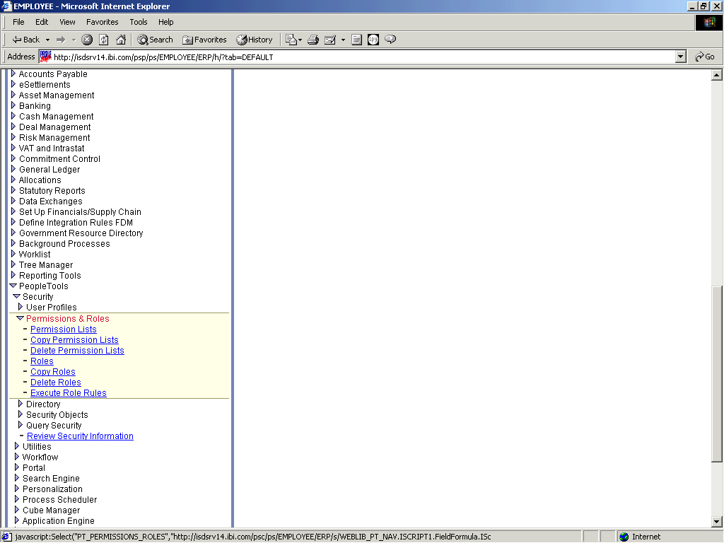

  1. Expand PeopleTools, Security, User Profiles, and Permissions & Roles and then click Permission Lists.
  2. Click Search.
    The Permission Lists Search pane is displayed.
  3. Select the relevant permission list.
    The following pane is displayed.
    permission lists pane

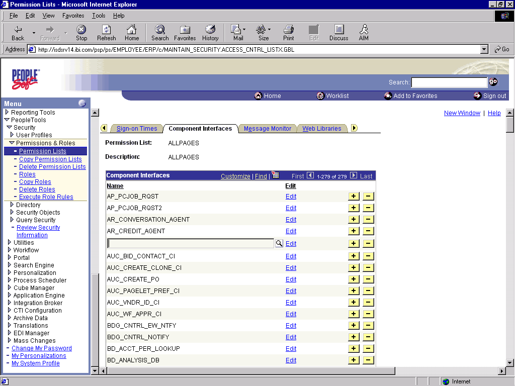

  4. Click the right arrow next to the Sign-on Times tab.
    The Component Interfaces tab appears.
  5. Click the Component Interfaces tab.
  6. Click + to add a new row to the Component Interfaces list.
    A field appears where you can enter the component interface name.
    component interface name field

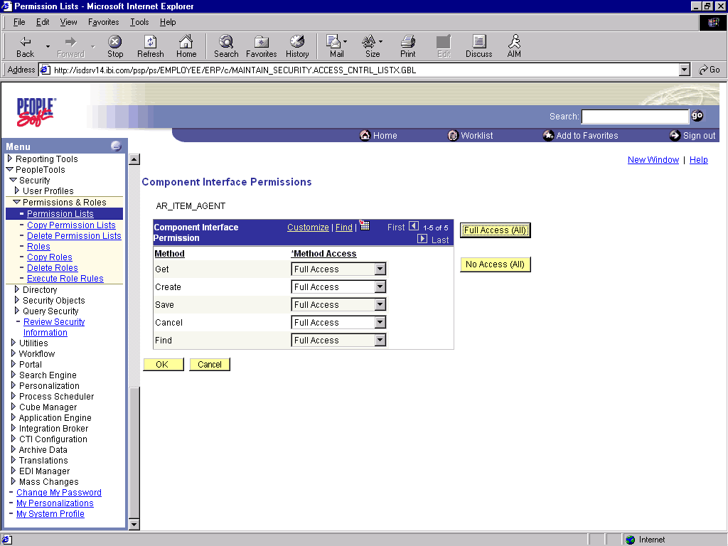

  7. Enter the component interface name and click Edit.
    This example uses the component interface AR_ITEM_AGENT.
    AR_ITEM_AGENT component interface
  8. From the lists, select the desired access level for each method.
  9. Click OK.
    access level
  10. Scroll down in the right pane and click Save.

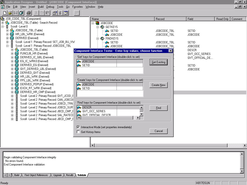

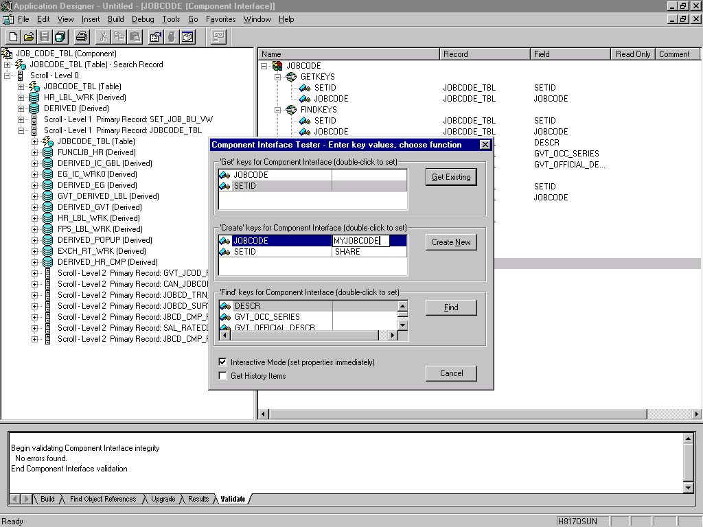

  1. In Application Designer, select Test Component Interface from the Tools menu.
    The Component Interface Tester dialog box is displayed.
  2. If required, click the Component Interface Tester dialog box to bring it to the foreground.
  3. To test the component interface, use one the following methods.

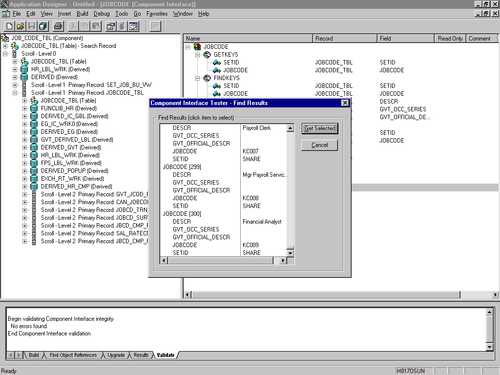

    • To test the component interface using the Find method, click Find.
      The Component Interface Tester - Find Results dialog box displays all of the possible entries for the underlying component. If there are more than 300 entries, a message appears.
      Component Interface Tester - Find Result dialog box
    • In the left pane of the Find Results dialog box, select a field.
    • To display the relevant data for that particular field, click Get Selected.
      The following dialog box is displayed.
      changing results
    • If the security settings permit, you can change the values in the individual fields.
  4. To test the component interface using the Get method, perform the following steps:
    1. Enter the existing key(s).
    2. Click Get Existing.
      This returns the exposed properties for the key that you entered. You can change values if Update access was specified.
    Alternatively, you can test using the Create method. Create method
    1. Enter all required key values.
    2. Click Create New.
      When you enter valid values in Create keys, a pane showing the JOBCODE data is displayed after the Table name is expanded with default data in place.
      JOBCODE data
      You can change fields at this point. Changes are validated against the component's underlying business logic.
    3. After you finish making changes, right-click the top item in the pane.
  5. To save your changes, click Save.
    The keys used to create the record can be used with the Get method for viewing data. The data that was added can be viewed in the PeopleSoft Component as shown in the following example. The Effective Date is one of the default values.
