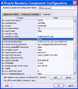

To enable security in an Oracle ADF Business Components application, you must edit the jbo.security.enforce property of the application modules configuration (maintained in the bc4j.xcfg file). The jbo.security.enforce property set to Must specifies that an authenticated user must be logged in before the application module will be created. This is a requirement for any business components application that will work with container-managed security.
To configure security for Oracle ADF Business Components:
  1. In the Application Navigator, expand the data model project and located the application module node.
  2. Right-click the application module node and choose Configurations.
  3. In the Configuration Manager, select the configuration for your application and click Edit.
  4. In the Oracle Business Components Configuration dialog, select the Properties tab.
    The dialog display the full list of ADF Business Components configuration properties. The security properties begin with jbo.security.
  5. Scroll to locate the jbo.security.enforce property and enter the value Must.
  6. Click OK to close the dialogs and save the configuration changes.
Figure 30-6 shows the application module configuration SRServiceLocal and security property as they appear in the SRDemo application for ADF Business Components.
Figure 30-5 ADF BC Configuration Dialog, Properties Panel
Sample login page from the SRDemo application.

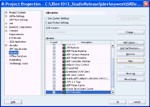

In order to use the JAZN realm in an ADF Business Components application, you must export the BC4J Security library to your user interface project. This will ensure that the jazn.jar is available to the user interface project at runtime. Without this library defined, an exception such as NullPointerException in JboJAZNUserManager.isUserInRole() will be returned when your application attempts to verify the logged in user.
To add required libraries for ADFBC Security to the user interface project:
  1. In the Application Navigator, right-click the user interface project and choose Project Properties.
  2. In the Project Properties dialog, select Libraries to view the list of available libraries.
  3. Scroll to locate BC4J Security and make sure that Export is enabled.
  4. Click OK to close the dialog and save the setting.
Figure 30-6 shows the BC4J Security library as it should appear for the user interface project.
Figure 30-6 Project Properties Dialog, Libraries Panel
