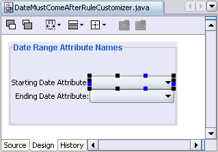

Figure 26-4 illustrates using JDeveloper's visual designer for Swing to create a DateMustComeAfterRuleCustomizer using a JPanel with a titled border containing two JLabel prompts and two JComboBox controls for the dropdown lists. The code in the class populates the dropdown lists with the names of the Date-valued attributes of the current entity object being edited in the IDE. This will allow a developer who adds a DateMustComeAfterRule validation to their entity object to easily pick which date attributes should be used for the starting and ending dates for validation.

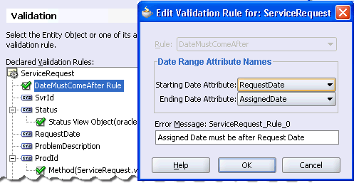

Figure 26-5 shows the Validation panel of the Entity Object editor for the SRDemo application's ServiceRequest entity object. When you edit the DateMustComeAfter rule, you can see the custom editing panel is automatically discovered from the rule class' BeanInfo and used at design time to show the developer the starting and ending attribute names. JDeveloper provides the support for capturing the translatable error message that will be shown to the end-user if the validation rule fails at runtime.
