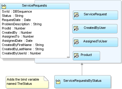

Whenever you create a new business component, if necessary, you can extend an existing one to create a customized version of the original. For example, in the SRDemo application, as shown in Figure 25-9, the ServiceRequestsByStatus view object extends the ServiceRequests view object to add a named bind variable named TheStatus and to customize the WHERE clause to reference that bind variable.
Figure 25-9 ADF Business Components Can Extend Another Component
Image shows how business components can extend others
While the figure shows a view object example, this component inheritance facility is available for all component types. When one component extends another, the extended component inherits all of the metadata and behavior from the parent it extends. In the extended component, you can add new features or customize existing features of its parent component both through metadata and Java code.
