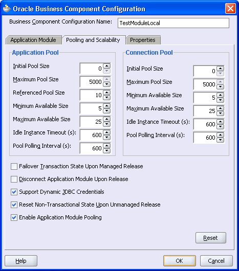

The Pooling and Scalability tab of the Configuration Editor shown in Figure 29-3 is used for seeing and setting parameters.
Figure 29-3 Pooling and Scalability Tab of the Configuration Manager
Image of the Pooling and Scalability tab
The values that you supply through the Configuration Manager are saved in an XML file named bc4j.xcfg in the ./common subdirectory relative to the application module's XML component definition. All of the configurations for all of the application modules in a single Java package are saved in that same file.
For example, if you look at the bc4j.xcfg file in the ./oracle/srdemo/model/common directory of the SRDemo application's DataModel project, you will see the two named configurations for its SRService application module, as shown in Example 29-1. The SRServiceLocalTesting configuration uses JDBC URL connections for use by the SRDemo application's JUnit tests and by the Business Components Browser. The SRServiceLocal uses JDBC Datasource names and is used by the web application.
