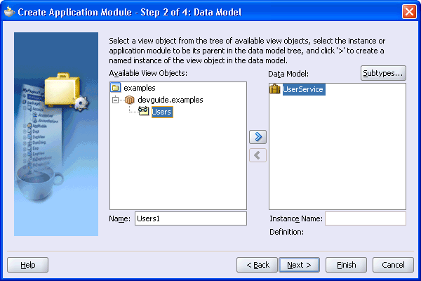

In step 2 on the Data Model page, Figure 5-7 illustrates that initially the data model is empty. That is, it contains no view object instances yet. The Available View Objects list shows all available view objects in your project, organized by package.
To add an instance of a view object to the data model, first select it in the Available list. The Name field below the list shows the name that will be used to identify the next instance of that view object that you add to the data model. By typing in a different name before pressing the add instance button >, you can change the name to be anything you like. Finally, to add an instance of the selected view object to the data model, identified by the instance name shown below, click the add instance button (>).

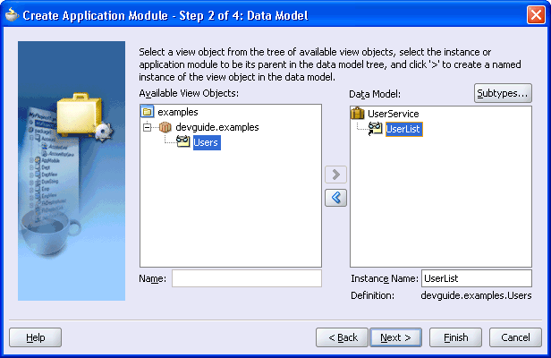

Assuming you decide on the instance name of UserList
, Figure 5-8 shows what the Data Model page would look like after adding the instance. The Instance Name field below the selected view object instance in the Data Model list allows you to see and change the instance name if necessary. The Definition field displays the fully-qualified name of the view object component that will be used to create this view object instance at runtime. You see as expected that the definition that will be used is devguide.examples.Users
view object.

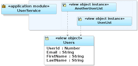

Even though the application module is a nonvisual component, you can still apply this same intuition about components, instances, and distinct member names to help understand the concept better. While designing an application module, you use instances of a view object component to define its data model. Figure 5-10 shows a JDeveloper business components diagram of a UserService
application module. Just as the panel in Example 5-1 contained two instances of the JButton
component with member names of myButton
and anotherButton
to distinguish them, your application module contains two instances of the Users
view object component, with member names of UserList
and AnotherUserList
to distinguish them. At runtime, the two JButton
instances are both based on the same definition — which explains why they both have the same set of properties and both exhibit JButton
-like behavior. However the values of their properties like Position
and Text
are different. So too for the different instances of the Users
view object in your UserService
application module. At runtime, both instances share the same Users
view object component definition — ensuring they have the same attribute structure and Users view object behavior — however, each might be used independently to retrieve data about different users. For example, some of the runtime properties like an additional filtering WHERE clause or the value of a bind variable might be different on the two distinct instances.
Figure 5-10 Designing an Application Module That Contains Two Instances of the Users View Object Component

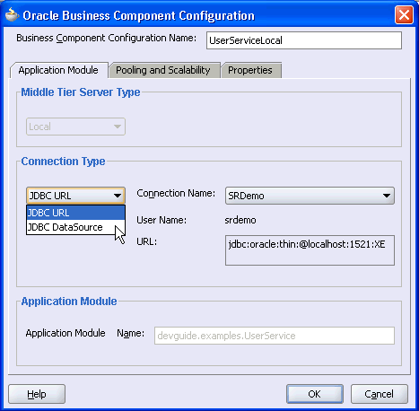

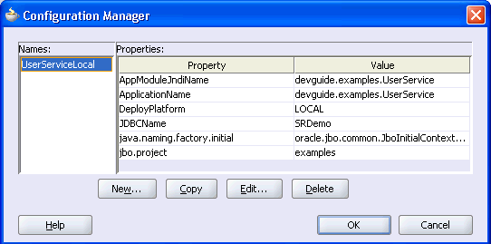

You can use the application module configuration manager to edit existing configurations or create new ones. To access the configuration manager, select the desired application module in the Application Navigator and choose Configurations...from the context menu. The Configuration Manager dialog appears, as shown in Figure 5-11. You can see the default UserServiceLocal
configuration for the UserService
application module. Any additional configurations you create, or any configuration properties you edit, are saved in the same bc4j.xcfg
Click the Edit button in the Configuration Manager to edit a specific configuration. As shown in Figure 5-12, this editor allows you to configure the database connection information, a number of pooling and scalability settings, and a final tab of remaining properties that aren't covered by the first two tabs. All of the runtime properties and their meanings are covered in the JDeveloper online help.
