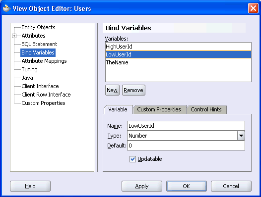

5.9.1 Adding a Named Bind Variable
To add a named bind variable to a view object, use the Bind Variables tab of the Create View Object wizard or the View Object Editor. You can add as many named bind variables as you need. As shown in Figure 5-20, for each bind variable you specify its name, data type, and default value. You can name the variables as you like, but since they share the same namespace as view object attributes you need to choose names that don't conflict with existing view object attribute names. As with view objects attributes, by convention bind variable names are created with an initial capital letter.
On the Control Hints tab, you can also specify UI hints like Label Text, Format Type, Format mask and others, just as you did above with the view object attributes. These bind variable control hints are used automatically by the view layer when you build user interfaces like search pages that allow the user to enter values for the named bind variables. The Updatable checkbox controls whether the end user will be allowed to change the bind variable value through the user interface. If a bind variable is not updatable, then its value can only be changed programmatically by the developer.
Figure 5-20 Defining Named Bind Variables for a View Object
Image of View Object Editor for defining bind variables
After defining the bind variables, the next step is to reference them in the SQL statement. While SQL syntax allows bind variables to appear both in the SELECT list and in the WHERE clause, you'll typically use them in the latter context, as part of your WHERE clause. You could edit the UserList view object created above, and open the SQL Statement page to introduce your named bind variables like this:
select USER_ID, EMAIL, FIRST_NAME, LAST_NAME
from USERS
where (upper(FIRST_NAME) like upper(:TheName)||'%'
   or  upper(LAST_NAME)  like upper(:TheName)||'%')
  and USER_ID between :LowUserId and :HighUserId
order by EMAIL
Notice that you reference the bind variables in the SQL statement by prefixing their name with a colon like :TheName or :LowUserId. You can reference the bind variables in any order and repeat them as many times as needed within the SQL statement.

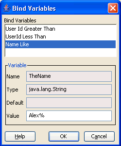

Once you've added one or more named bind variables to a view object, you gain the ability to easily see and set the values of these variables at runtime. Information about the name, type, and default value of each bind variable is saved in the view object's XML component definition file. If you have defined UI control hints for the bind variables, this information is saved in the view object's component message bundle file along with other control hints for the view object.
The Business Components Browser allows you to interactively inspect and change the values of the named bind variables for any view object, which can really simplify experimenting with your application module's data model when named bind parameters are involved. The first time you execute a view object in the tester, a Bind Variables dialog will appear, as shown in Figure 5-21. By selecting a particular bind variable in the list, you can see its name as well as both the default and current values. To change the value of any bind variable, just update its corresponding Value field before clicking OK to set the bind variable values and execute the query. Using the Edit Bind Parameters button in the toolbar — whose icon looks like ":id" — you can inspect and set the bind variables for the view object in the current panel.
Figure 5-21 Setting Bind Variables in the Tester
Image of Bind Variables tester
If you've defined the Label Text, Format Type, or Format control hints, the Bind Variables dialog helps you verify they are correctly setup by showing the label text hint in the Bind Variables list and formatting the Value attribute using the respective format mask. You can see in Figure 5-21 that the label text hints are showing for the three bind variables in the list.
